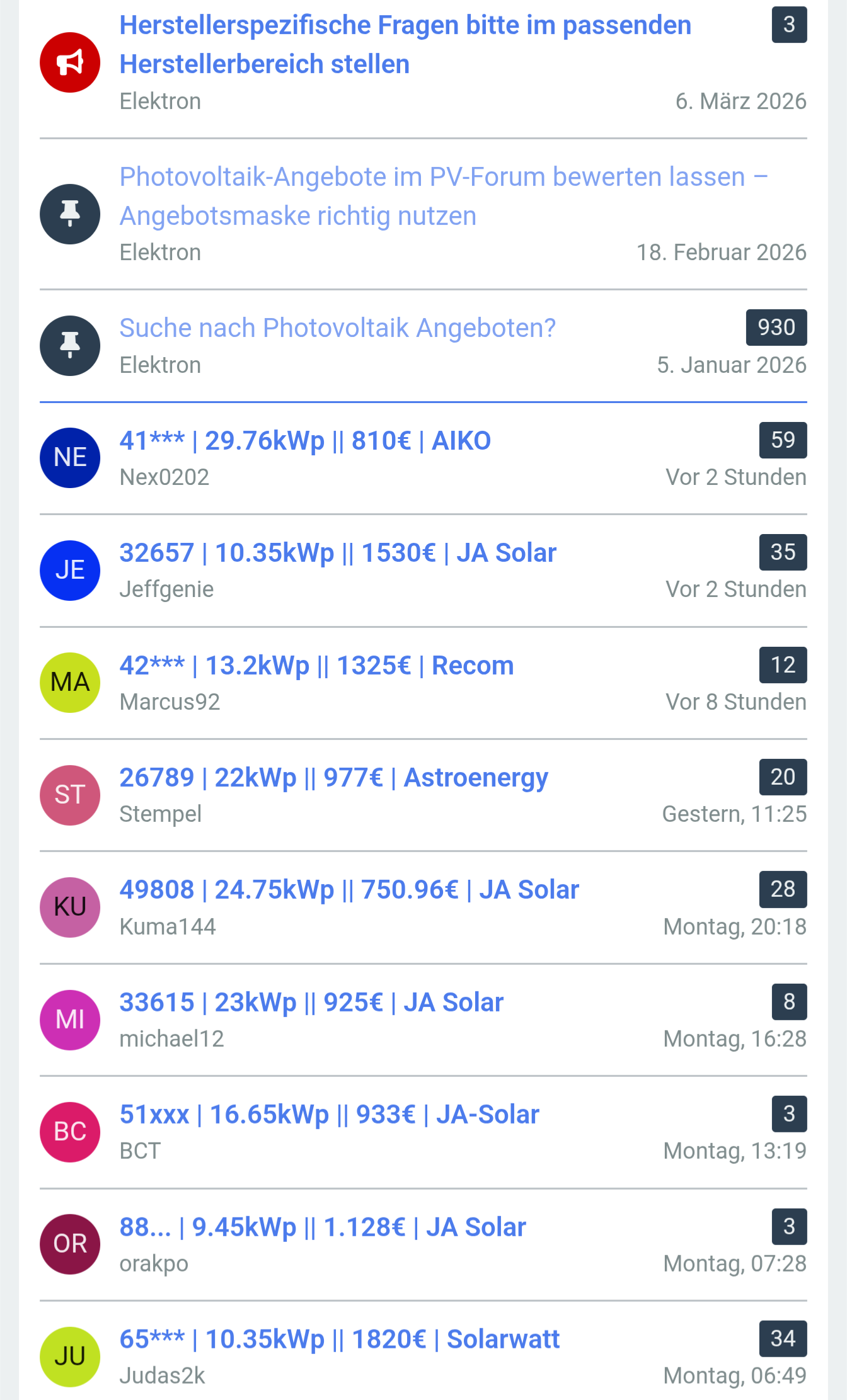

Here are some current average prices:
Postal code first, followed by the price per kWp
