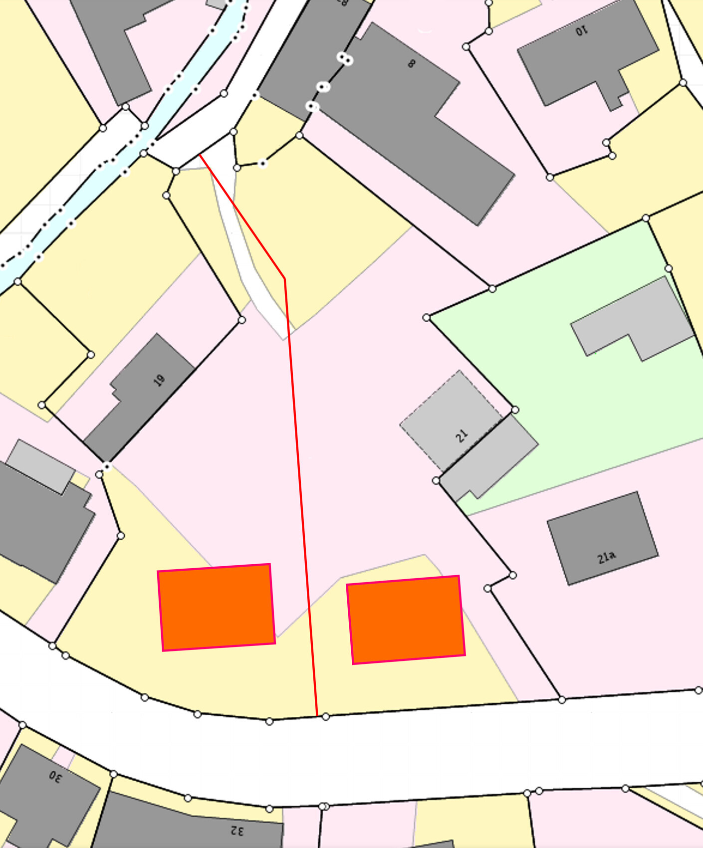

Dividing it lengthwise doesn’t help in my opinion either. Why not? My suggestion:
I don’t know the exact dimensions of Town & Country’s light house. However, in my opinion, the building footprints of 10m by 14m (33ft by 46ft) are sufficiently sized.
Escroda schrieb:
A 30m (100 feet) long driveway is not ideal and also quite expensive, plus the costs for utility connections and waste disposal lines.Access from the south and an extreme slope at the northern tip, just so that both touch at a footpath. Meanwhile, it’s a northern plot. Okay, worse things exist. But a flag lot shape is now only for the rear part. That is supposed to receive the northern tip which cannot be built on.
