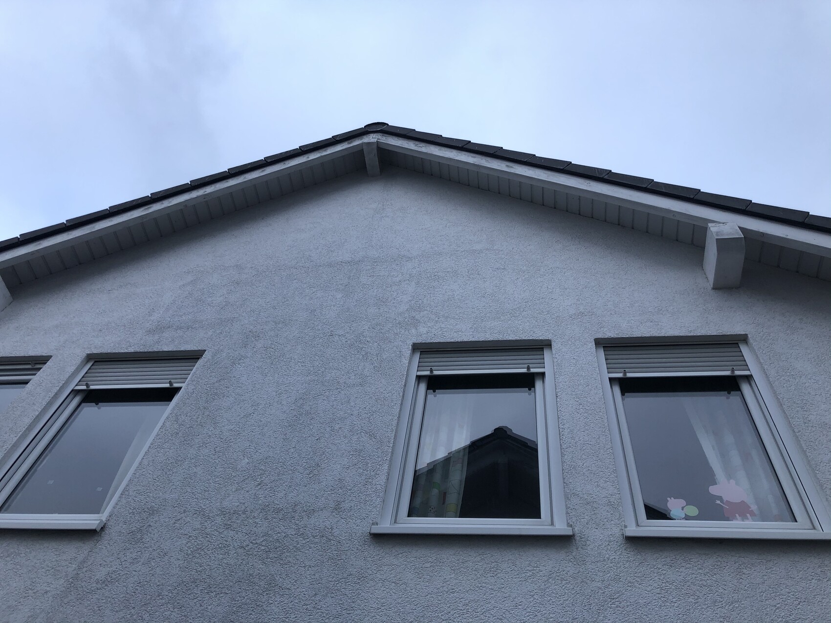

I have a question. Last year, we bought a semi-detached house, a prefabricated wooden house built in 2000. The gable of the roof, in particular, has already been exposed to quite a bit; the paint is almost completely gone, and you can see gray-black streaks.
Is this a problem? The beams supporting the gable show small cracks with black edges.
Is the structural strength of the wood still guaranteed without weather protection, or should I be concerned now?
What should be considered when repainting with weather-resistant paint?
How much does it typically cost to cover both gables? Are there any estimates?
I don’t know the wood type; it could be pine or larch.

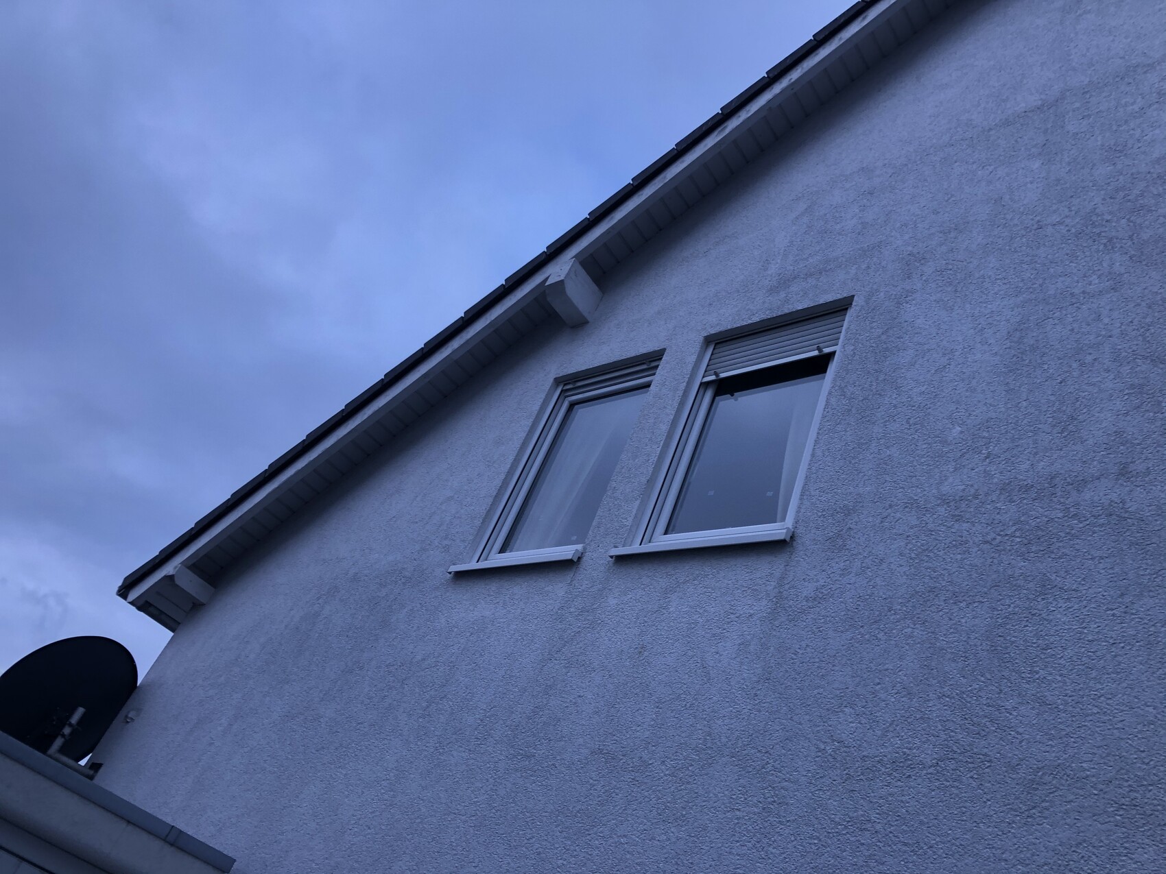

Tomorrow, I have only one photo from the other side because I can’t easily access the neighbor’s property right now, but it still shows what I mean. This side is not as badly affected yet and is also not the weather-facing side.
What should be mentioned is that the gable on the weather-facing side is partially covered by the neighbor’s roof, disappearing at just over half its height.

borderpuschl25 Feb 2020 08:24I thought the entire gable was covered with wood.
So we’re talking about the collar beams, purlin ends, and the eaves here.
In this case, I would definitely recommend just touching up with a proper wood paint. Depending on how the other side looks, you might not even need to sand everything down first. In the photo, it still looks quite good.
