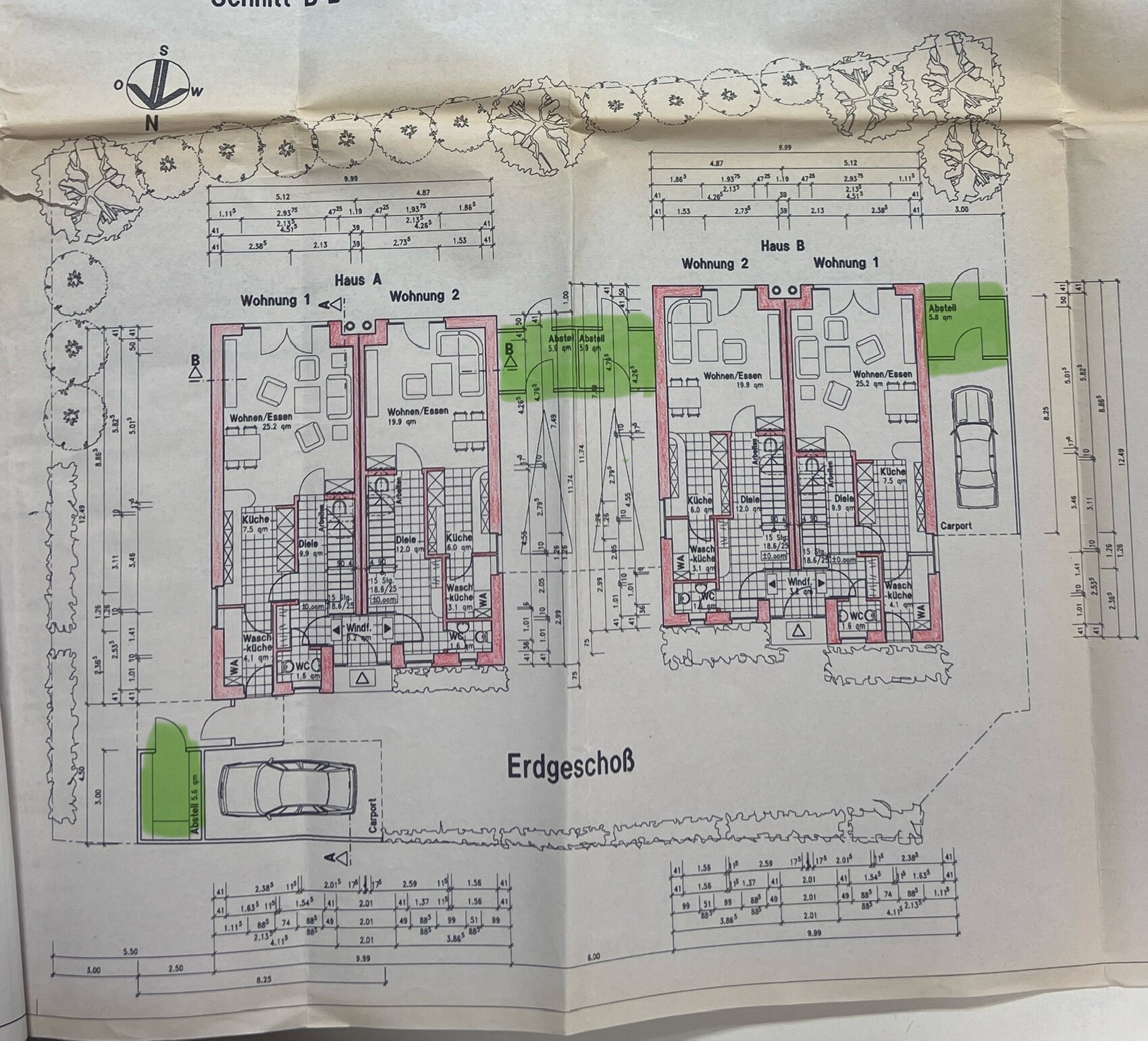

According to the 1977 Land Use Ordinance, garages and carports only count toward the floor space index if they exceed 0.1 of the plot area. The building authority staff member has now added up the square meters of all four carports and concluded that it exceeds 0.1 of the plot area. However, he also included the sheds located behind the carports. That can’t be correct, can it? I am attaching a photo showing which sheds I mean (marked in green).
According to the 1977 Land Use Ordinance, sheds/garden huts/bicycle storage do not count toward the floor space index or the 0.1 limit. If I exclude them, the total is below 0.1 of the plot area.

Tobilayo schrieb:
According to the 1977 Land Use Ordinance Carports and garages are regulated in Paragraph 12.
Tobilayo schrieb:
Sheds/garden huts/bicycle storage rooms are classified as ancillary rooms in Paragraph 14.
Tobilayo schrieb:
Floor Area Ratio is the floor area excluding walls of all full floors.
Surveyor Dimeto will know this exactly.

@ypg Thanks for the quick reply.
Are you sure about that? From what I understand reading the Building Use Ordinance 1977, the external dimensions are relevant here.
This difference ultimately determines whether I stay below 0.5 or go over it.
Maybe Dimeto or someone else can assess it again.
Thanks and best regards
The floor area without walls for all full stories.
Surveyor Dimeto will know that exactly.
Schorsch_baut23 Aug 2024 09:29What does the architect in charge say about this? It's their job to coordinate these details with the building authority / planning department, isn't it?
Schorsch_baut23 Aug 2024 09:32Since the sheds are structurally connected to the carports and are not independent units, this is certainly a matter of interpretation.
