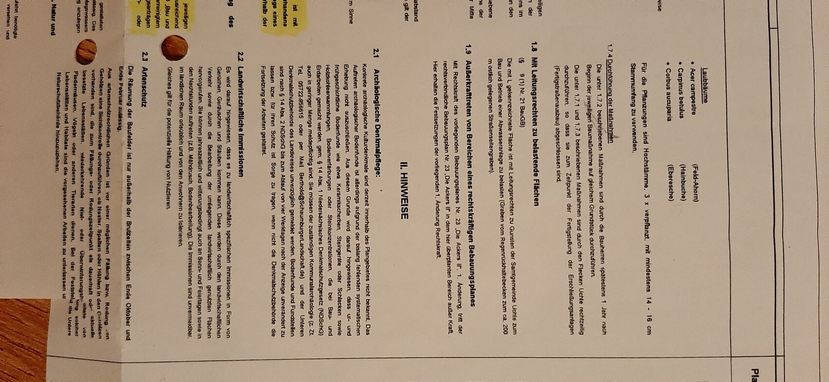

Attached is the development plan
Foto einer Planungsseite mit nummerierten Abschnitten und gelb markierten Passagen.
Deutschsprachige Dokumentenseite mit Überschriften, Listen und Tabellen.

So everyone, thanks for all the feedback! Our builder just called. He checked everything thoroughly. We can measure from the inside wall at the top and end up with a knee wall of 1 meter (3.3 feet) and a roof pitch of 45 degrees. This was our original plan and request, and everything has already been prepared accordingly. It can’t get any better than this.
