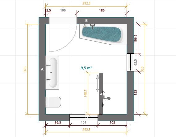

Hello everyone.
In a few weeks, we have an appointment with our electrician to plan the ceiling spotlights in our bathroom.
I have attached a drawing for you. Instead of a space-saving bathtub, we will now be installing a standard bathtub.
Please, no discussions about the floor plan itself. This is purely about the ceiling spotlights.
I can’t say yet which spotlights (beam angle, etc.) will be installed. Hopefully, a rough positioning can still be created...

3 Sep 2019 21:06
8 luminaires with ultra-wide angle and diffuser
Dim-to-warm function
Square layout (3x3 without center)

4 Sep 2019 15:09
hampshire schrieb:
8 fixtures with ultra wide-angle and diffuser
Do you have any specific recommendations? I think the original poster would appreciate it, and I could use a few myself 🙂
hampshire
5 Sep 2019 00:29
There are several suppliers. Rena, for example. It is always a matter of the available installation height and personal preference.
