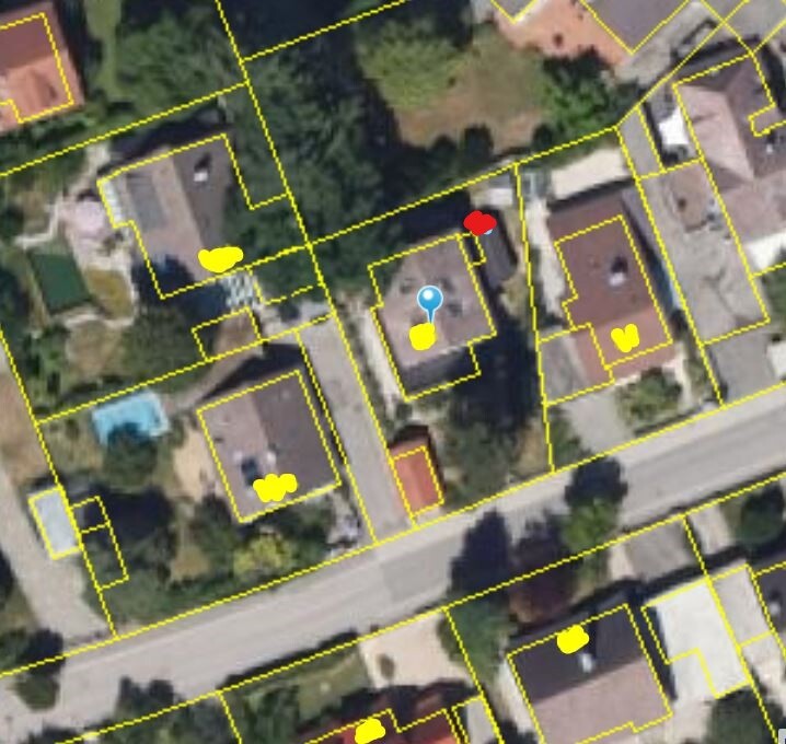

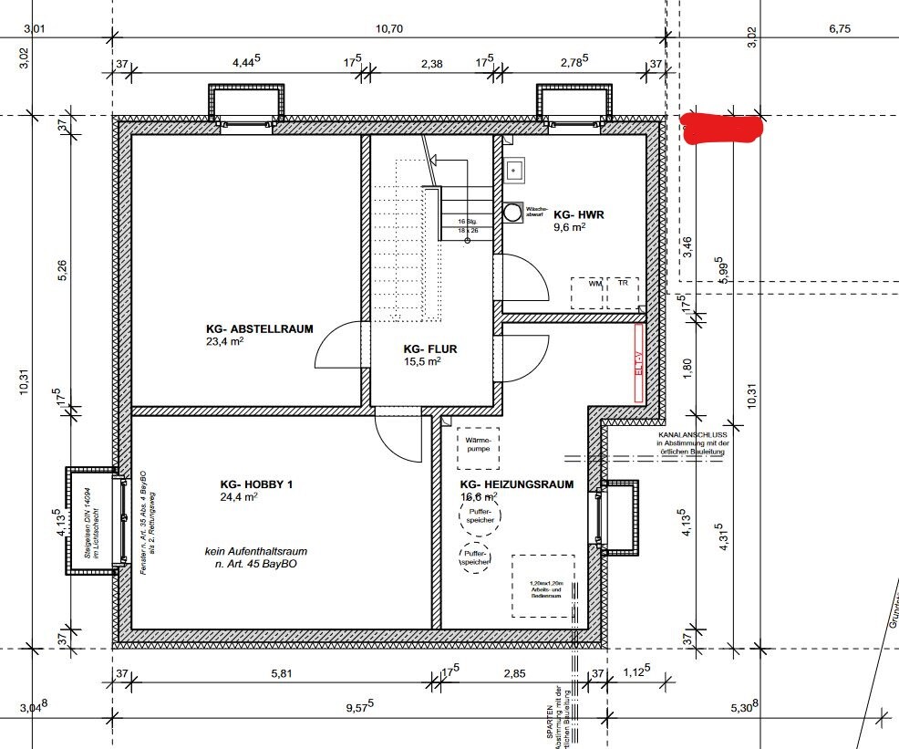

1. Where could we place the outdoor unit of the air-to-water heat pump? The planner suggested positioning it directly by the light well of the utility room. Technically probably the simplest solution, but we can’t really imagine it right in front of the kitchen and right next to the entrance. One idea of ours would be to place it on the garage (see the red marking in the following image). The planner had some concerns regarding the pipe routing. How bulky are the pipes? Could they not simply be routed through the utility room light well? The alternative would be an indoor air-to-water heat pump, but I’ve read about some disadvantages there (in particular, being limited to only a few manufacturers).
2. A central mechanical ventilation system with heat recovery is to be planned. We were told that for this, two light wells in the utility room are necessary – one for supply air and one for exhaust air. After some research, I’m not quite sure about this; wouldn’t it be more common to run supply and exhaust air ducts through the basement wall without planning an additional light well? Since these ducts probably have a fairly large diameter, routing them through the utility room and its existing light well might not be very practical…

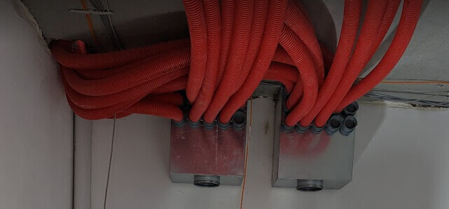

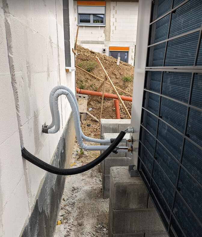

I can send you some photos of our ducts for the controlled ventilation system and air-to-water heat pump pipes, maybe that will help you.
