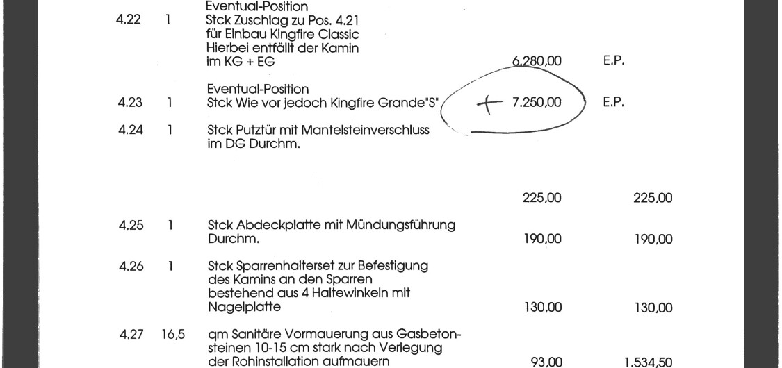

Don’t be confused by the room air dependent term. The absolute 18TL is room air independent

Or the 2-flue Schiedel chimney.
Don’t be confused by the term room-air dependent. The absolute 18TL is room-air independentI didn't really understand the part about the chimney.
ullw889 schrieb:
I didn’t really understand the part about the chimney. Your chimney is also 2,000 euros too expensive, considering we both have the same chimney from the same company.
That surprises me...
