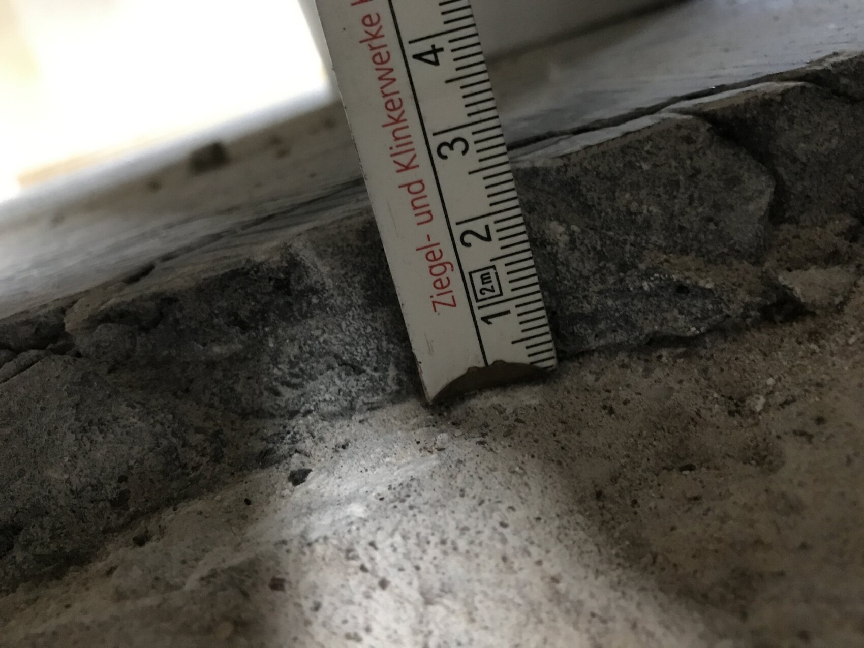

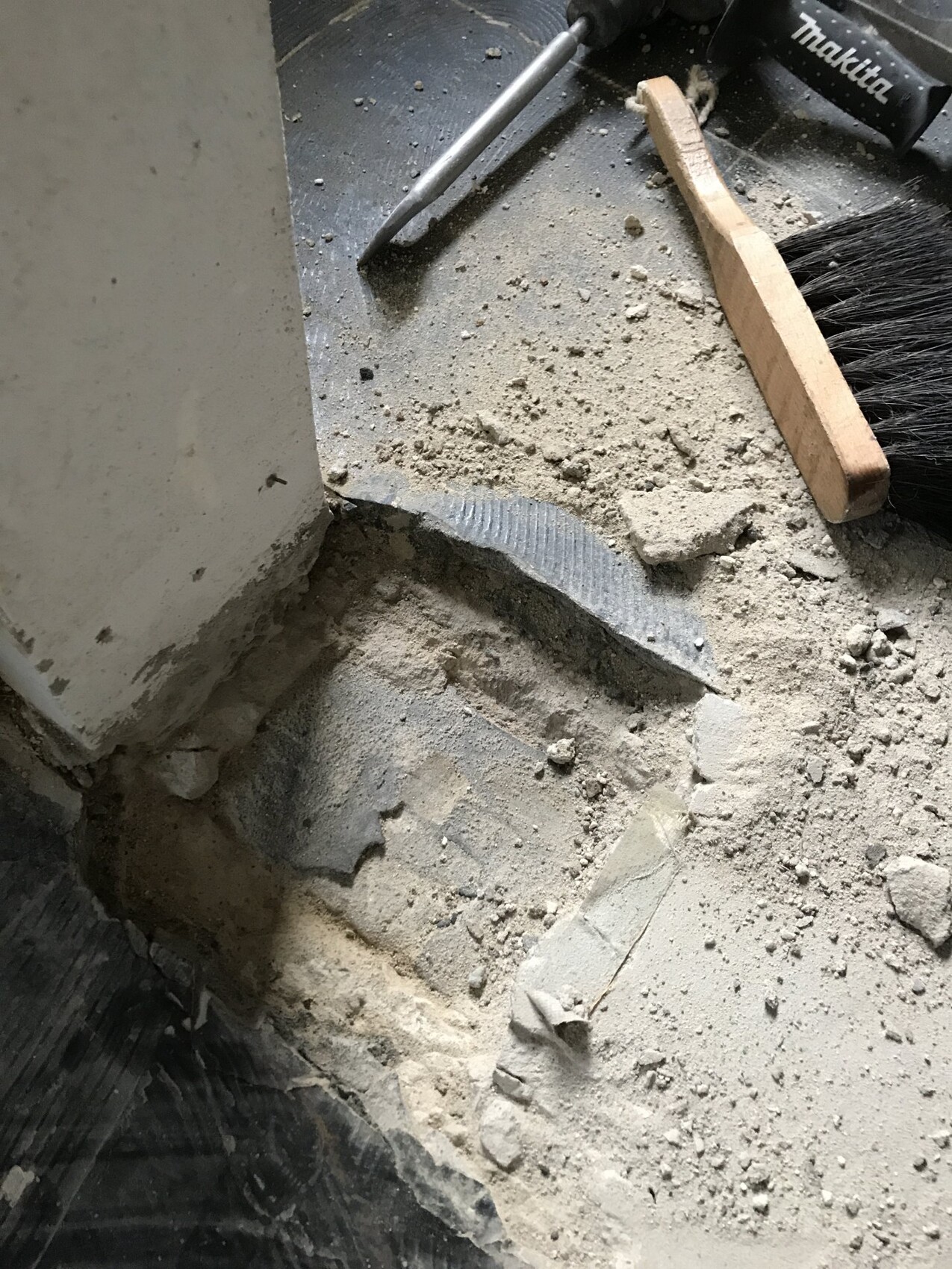

we are currently renovating a building from 1964 and are considering what to do with the floor. What would you recommend? At the moment, there is about 14cm (5.5 inches) of reinforced concrete and then 3cm (1 inch) of asphalt screed.

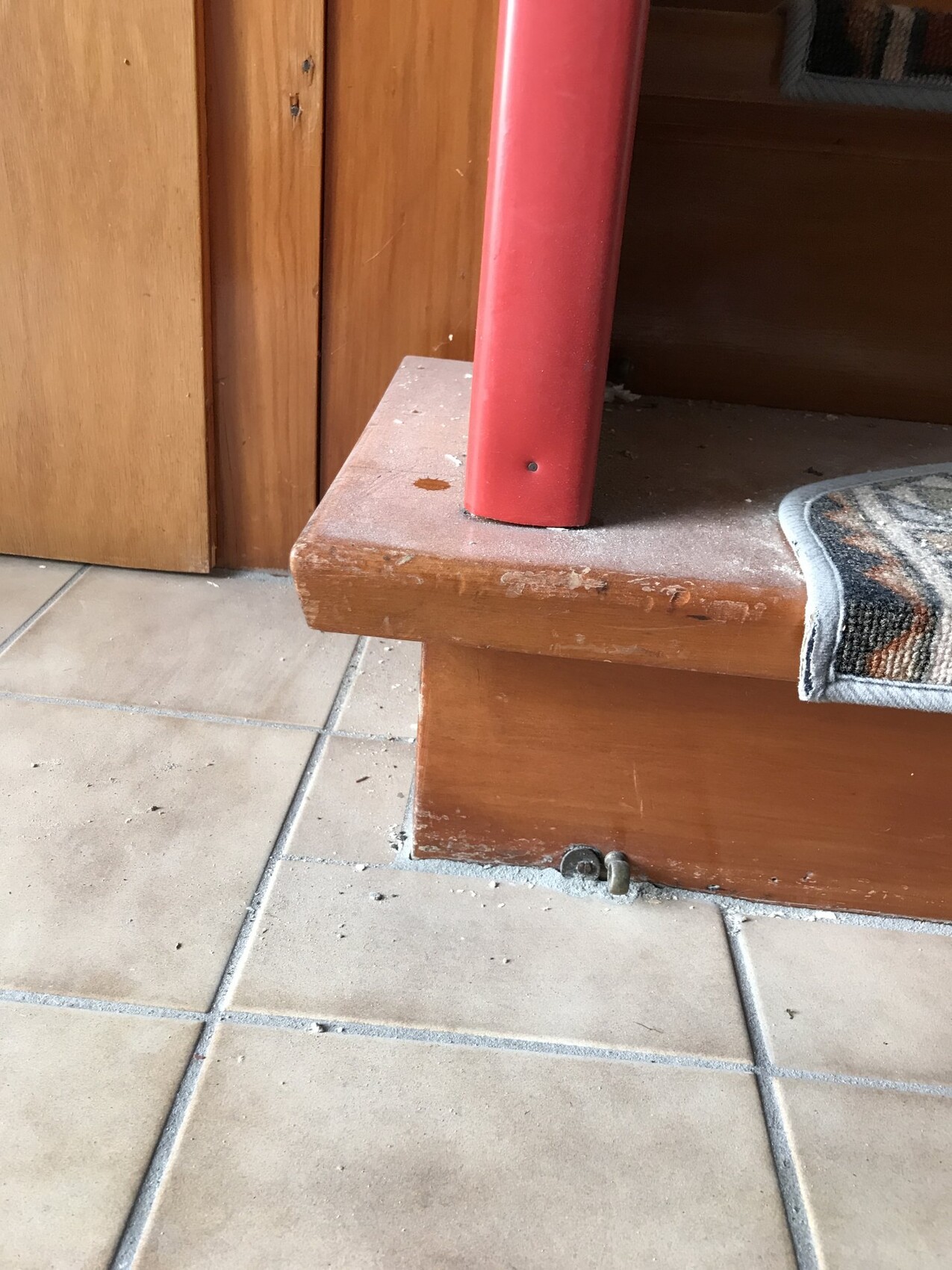

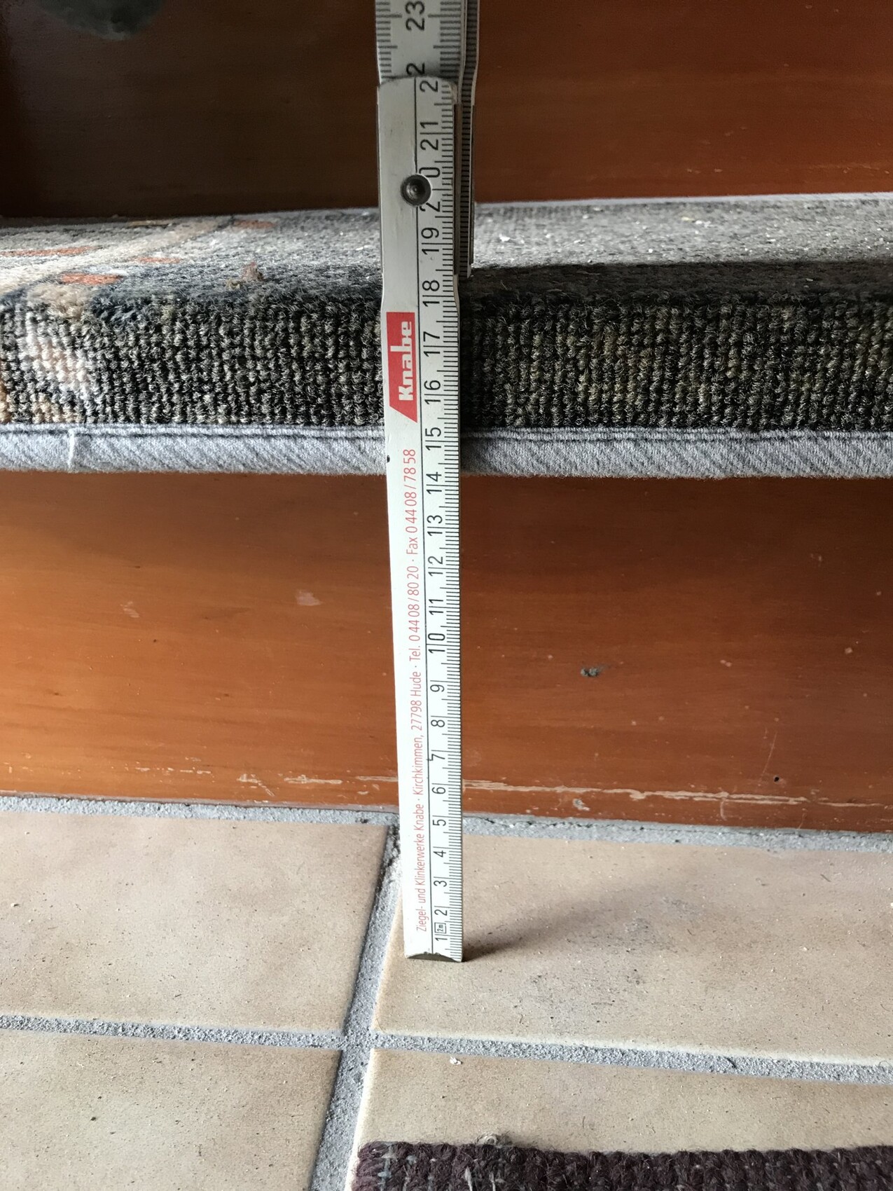

All the heating pipes and electrical wiring will be completely renewed as well. I could then install them in the new floor, right? And maybe even consider underfloor heating? But what should I do about the stairs?
For your information: unfortunately, the house only has a partial basement.

I find it hard to believe that the material shown in the photo is poured asphalt!

If no insulation is needed on top and it’s actually only a 3 cm (1 inch) layer of bitumen screed, you could remove that and achieve a total system thickness of 4.5 cm (1.75 inches) with a renovation underfloor heating system. This would include 2.5 cm (1 inch) of insulation and 2 cm (0.8 inches) of gypsum fiber screed.
