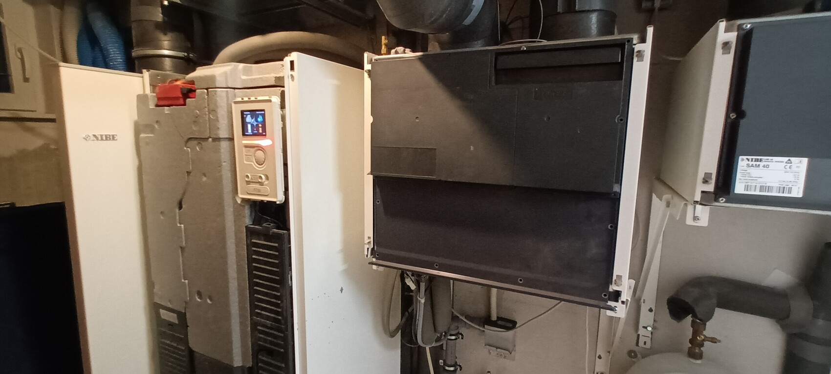

My air source heat pump Nibe F750 has been malfunctioning for a week now, and all technicians worldwide are unavailable!
That’s why I want to ask you what I should do now.

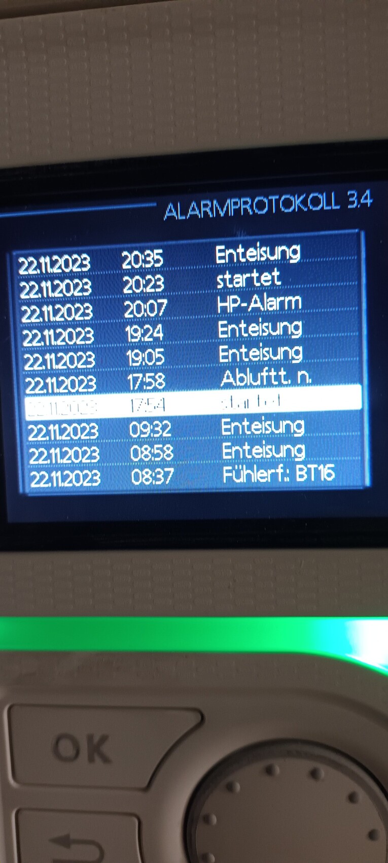

A few days later, the first alarm appeared, indicating that the heating system could not generate heat.
Possible causes were, for example, “Defrosting takes too long… etc.”

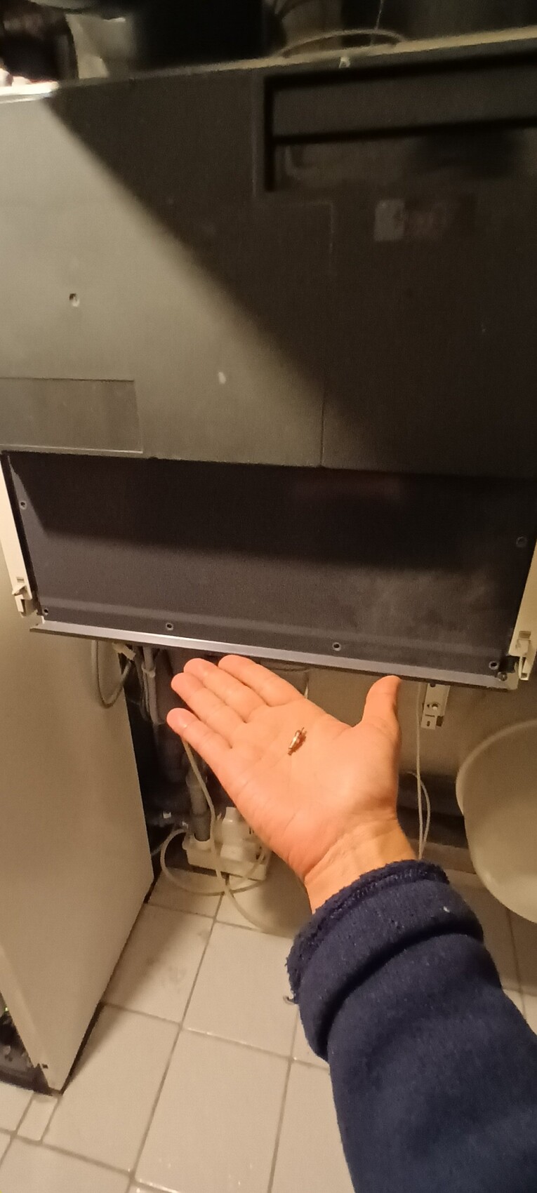

I switched the heating system off and on several times. During this, about 100 ml (3.4 fl oz) of water dripped from the exhaust module two to three times – it is probably condensate?

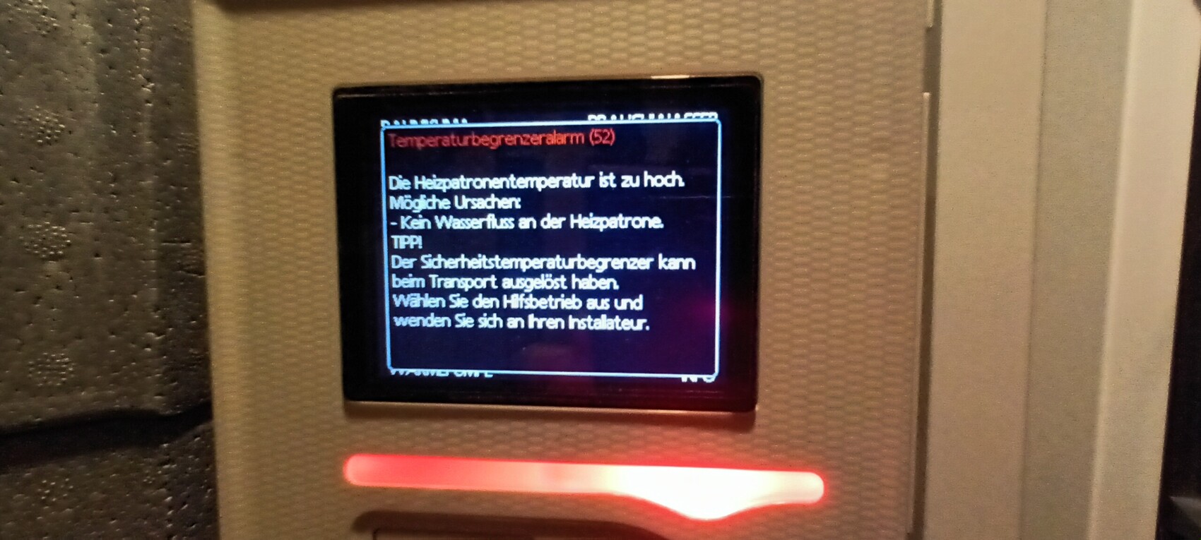

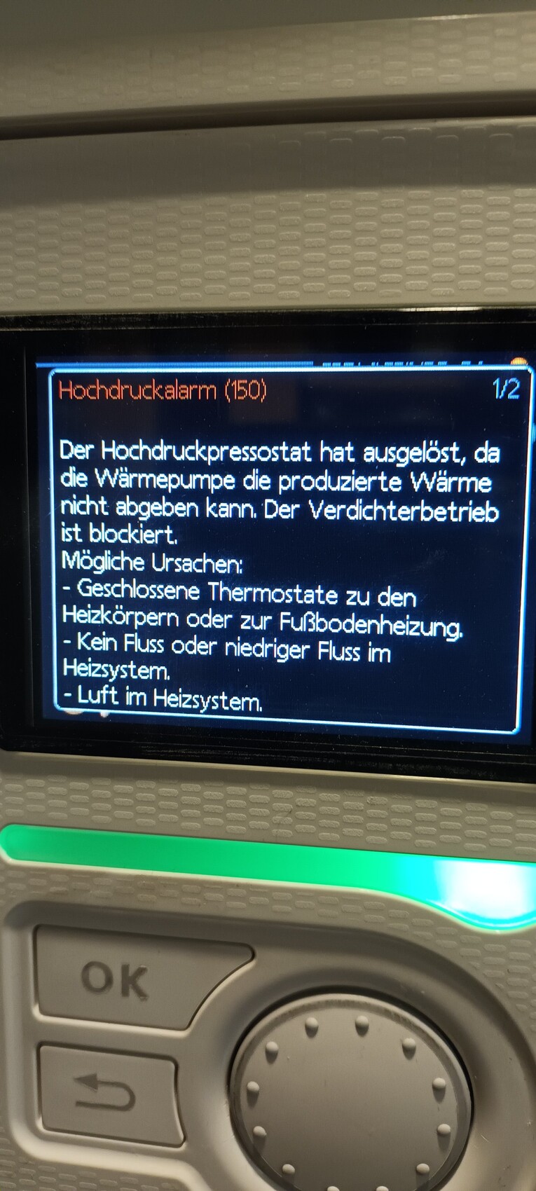

Then a “High Pressure Alarm” occurred, and now there is a constant “Temperature Limiter Alarm.”
I gave the system a day of rest, performed a reset for “Temperature Limiter FQ10” on page 12, but the same alarm keeps recurring.

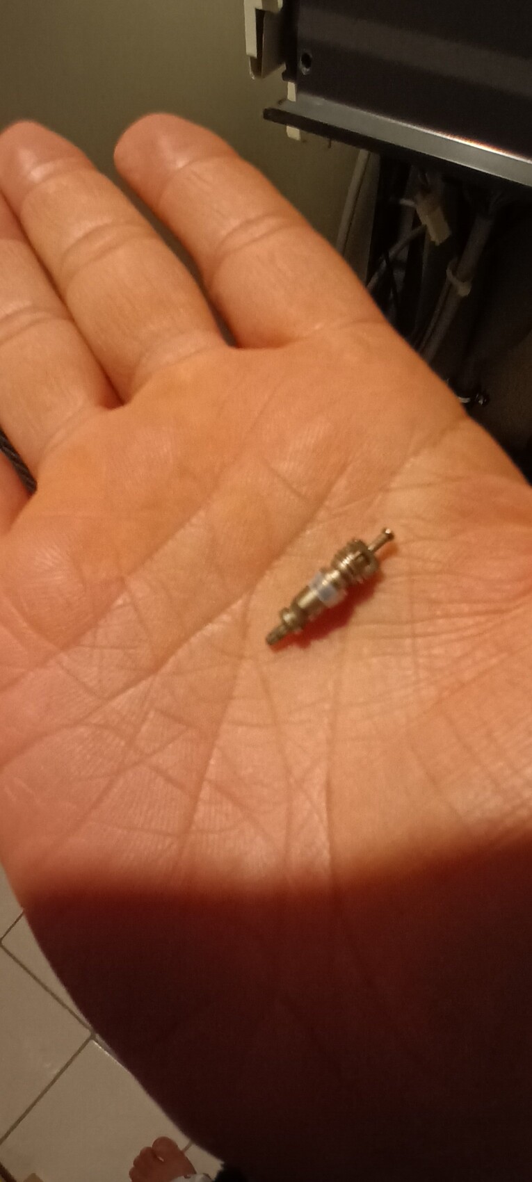

I found a small metal part on the floor of the exhaust module but don’t know what it is for...

Radfahrer30 Nov 2023 16:11johannchang schrieb:
I found a small metal part on the floor of the exhaust module but don’t know what it’s for...That is a valve from a bicycle or car tire.Similar topics
