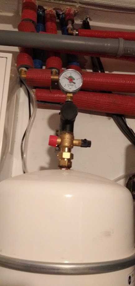

immermehr19 Aug 2021 12:36Hello everyone,
I noticed a few weeks ago that the underfloor heating system is losing pressure. The first sign was the heat pump (HSPE Daikin) showing errors. Afterwards, I saw that the water pressure in the boiler dropped below 2 bar. After consulting with the heating technician, I topped up the water and increased the pressure to 2.7 bar. After about 6 weeks, it has dropped back to around 2 bar.
This means the underfloor heating loses about 0.1 bar each week.
Question:
Is this normal?
In summer, the underfloor heating probably isn’t running. Could this be related? Should I expect a leak?
Thank you for your answers.

The pressure has to go somewhere. Have you checked the heating circuit distributor?
Maybe there is also a wrongly adjusted or faulty safety valve releasing pressure into a drainage pipe?
But overall, that’s quite a lot of pressure, something isn’t right. Have the installer come and take a look!
I suspect a faulty (leaking) expansion tank.
However, if the homeowner isn’t even sure when the underfloor heating is running or not, I strongly recommend staying away from the system.
Additionally, since this is a new build, the installer should fix this issue free of charge.
nordanney19 Aug 2021 13:54immermehr schrieb:
Afterwards, I noticed that the water pressure in the boiler drops below 2 bar (29 psi). Which boiler? It’s a heat pump, so why is there a boiler?
immermehr schrieb:
After consulting with the heating technician, I refilled water and increased the pressure to 2.7 bar (39 psi). Wow! Normally, the heating system should operate around 1.5 bar (22 psi).
immermehr schrieb:
Question:
Is this normal? No!
immermehr schrieb:
In summer, the underfloor heating probably isn’t running. Could it be related? Should I expect a leak? But the pressure is still present in the system. And hot water is also produced with it.
immermehr schrieb:
Should I expect a leak? Either there is a leak or water is escaping through the safety valve. It depends on what kind of safety valve is installed. After all, you are running a very high pressure of 2.7 bar (39 psi).
