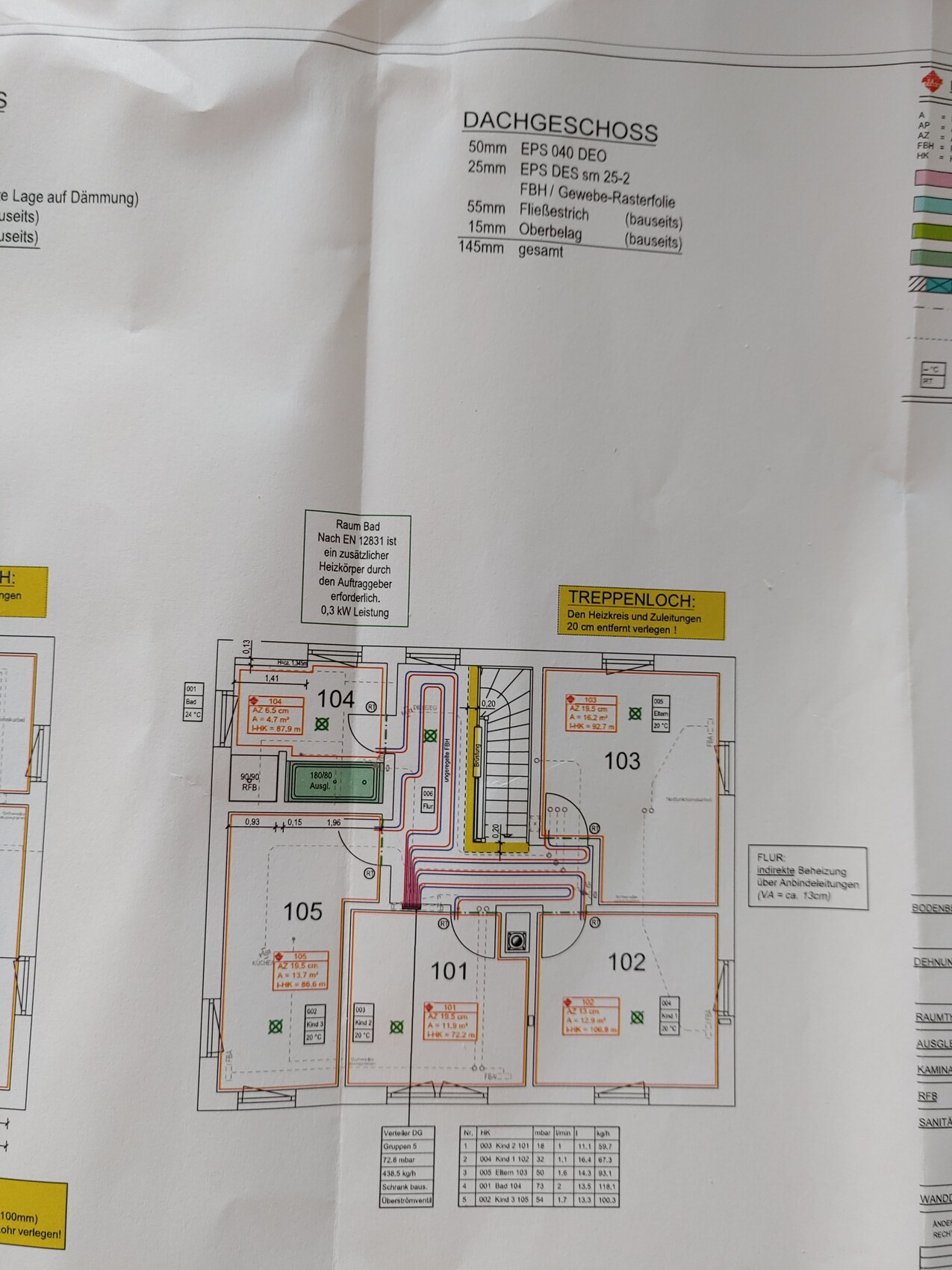

I had a chance to take a look at our heating plan on the construction site. The subcontractor’s subcontractor will be installing the underfloor heating next week.
Now to the question:
Do you see any major mistakes here, or just things that could be quickly clarified with the tradespeople on site?
Generally, I don’t have much say regarding the underfloor heating, so I wasn’t involved in the planning. However, I hope to work out one or two minor details directly with the workers on site.
So far, I’d only try to convince them to install the underfloor heating beneath the bathtub as well (acrylic on screed / showers are embedded in the screed). Or is making a last-minute adjustment a bad idea because it could mess everything up?
Any other tips? Should I try to negotiate anything about spacing?
Thanks a lot and best regards
KingJulien

But in the living room, for example, I think the spacing is because with such small spacing they would exceed the maximum heating circuit length of 120 m (394 feet), meaning they would need two circuits. I don’t want to cause more damage than benefit with blind (especially uninformed) actionism.
That’s why I’m asking what would still make sense now.

T_im_Norden13 Jan 2021 18:50Given the short time available, I don't see much possibility to make significant changes.

Does the subcontractor install the entire underfloor heating system including the manifold and supply lines, or just the heating loops up to the manifold? The manifold is already installed and was connected today, if I saw correctly.
So, underfloor heating beneath the bathtub – worth trying, counterproductive, or no longer salvageable?
T_im_Norden13 Jan 2021 19:23One could try to adjust the loops in rooms 1 and 2.
For example, set the living room loop to about 85 meters (280 feet) and then combine the dining area and part of the living room into one loop of about 85 meters (280 feet).
This would make the loop lengths more balanced.
If possible, I would have it installed under the bathtub.
Summary:
A maximum installation spacing of 10 cm will most likely fail due to the time factor before execution. But it doesn’t hurt to ask; it might still be possible with a few extra days of delay and the corresponding additional costs.
The supply line for the heating circuit distributors should be at least 28 mm (1.1 inches) copper pipe and not 20 mm (0.8 inches) or 25 mm (1 inch) polyethylene or aluminum composite pipe nonsense, but this is already installed, so nothing can be done about it anymore.
If the supply lines of the heating circuits are often routed through the corridor, and the corridor has its own circuit, have the supply lines of the other rooms insulated. Otherwise, no matter how much you turn down the room thermostat of the corridor circuit, the room will still be heated by the uninsulated supply lines of the other heating circuits. //I just noticed the corridor is being heated by the supply lines of the other rooms, so the topic of insulation is irrelevant in this case...
