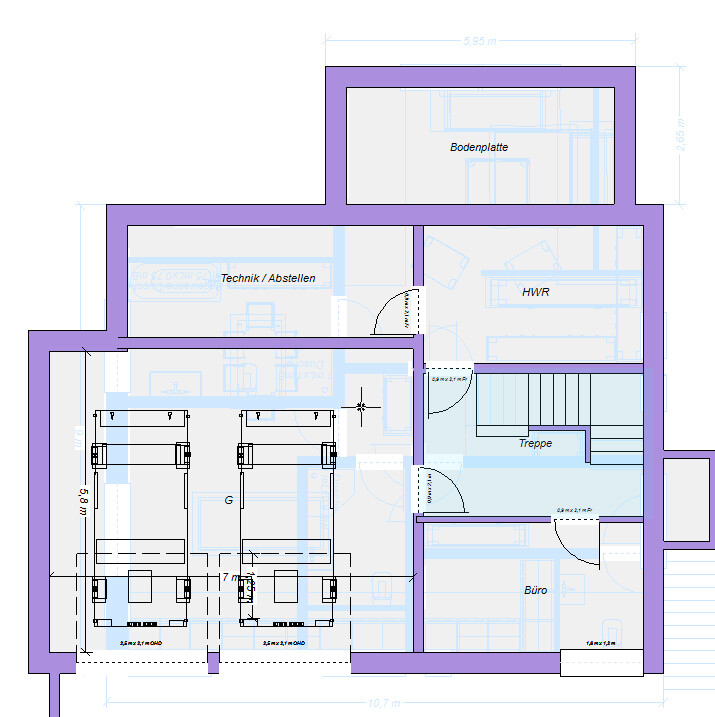

Basement floor with double garage, technical room, cellar, office, utility room and entrance.

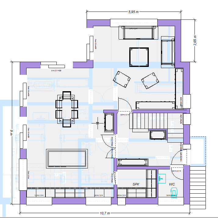

I tinkered a bit again without any real purpose due to budget constraints.
Also, readers will need to use a bit of imagination since the somewhat challenging topography is not something my outdated software handles well. As usual, there are stairs without landings. The "front garden" would still need extensive paving to connect all the paths. Because of the slope, my program is struggling there.
Floor plan of a building: technical room/storage, office, utility room, stairs, and two garage spaces.
Floor plan of a house with living room, dining area, kitchen, stairs, WC, and furniture.

The whole thing depends on whether the master bathroom can be connected to the drainage system. A professional would have to figure out whether it’s possible to route pipes through the ceiling into the hallway wall or something similar.
By the way, I can’t get dormers to work properly with a knee wall height of 1.12 m (3 ft 8 in) and a setback of 0.50 cm (0.2 inches). The windows would end up just under the ceiling with a roof pitch of 38°, right?
