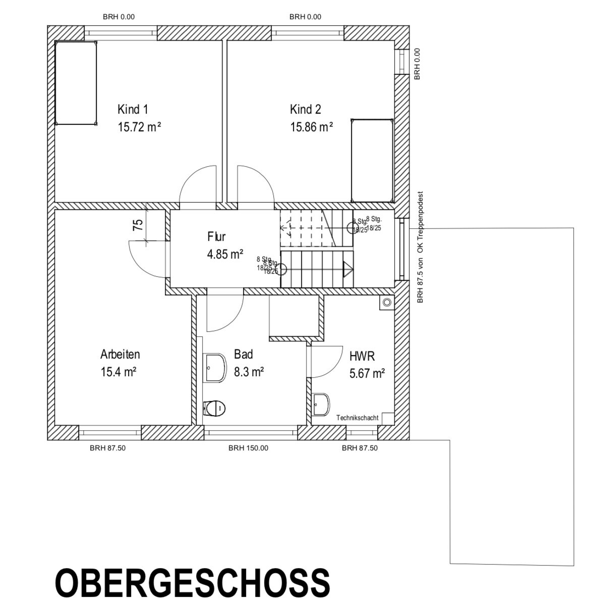

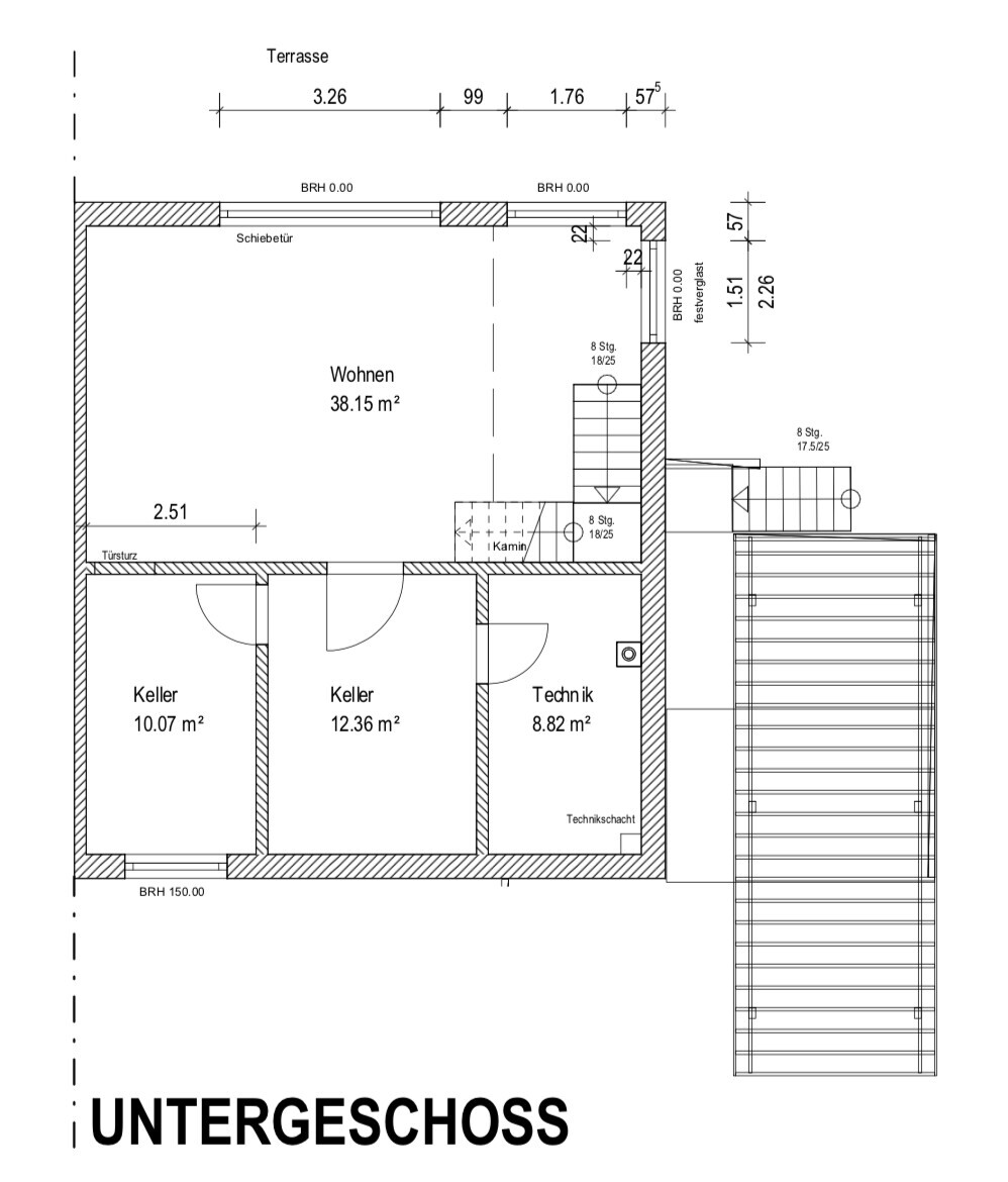

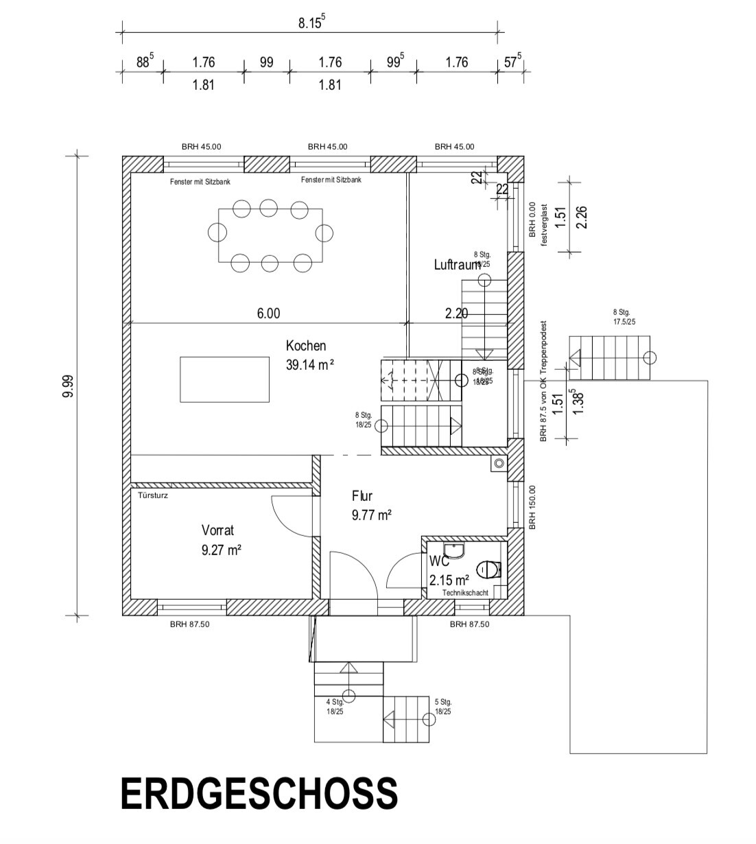

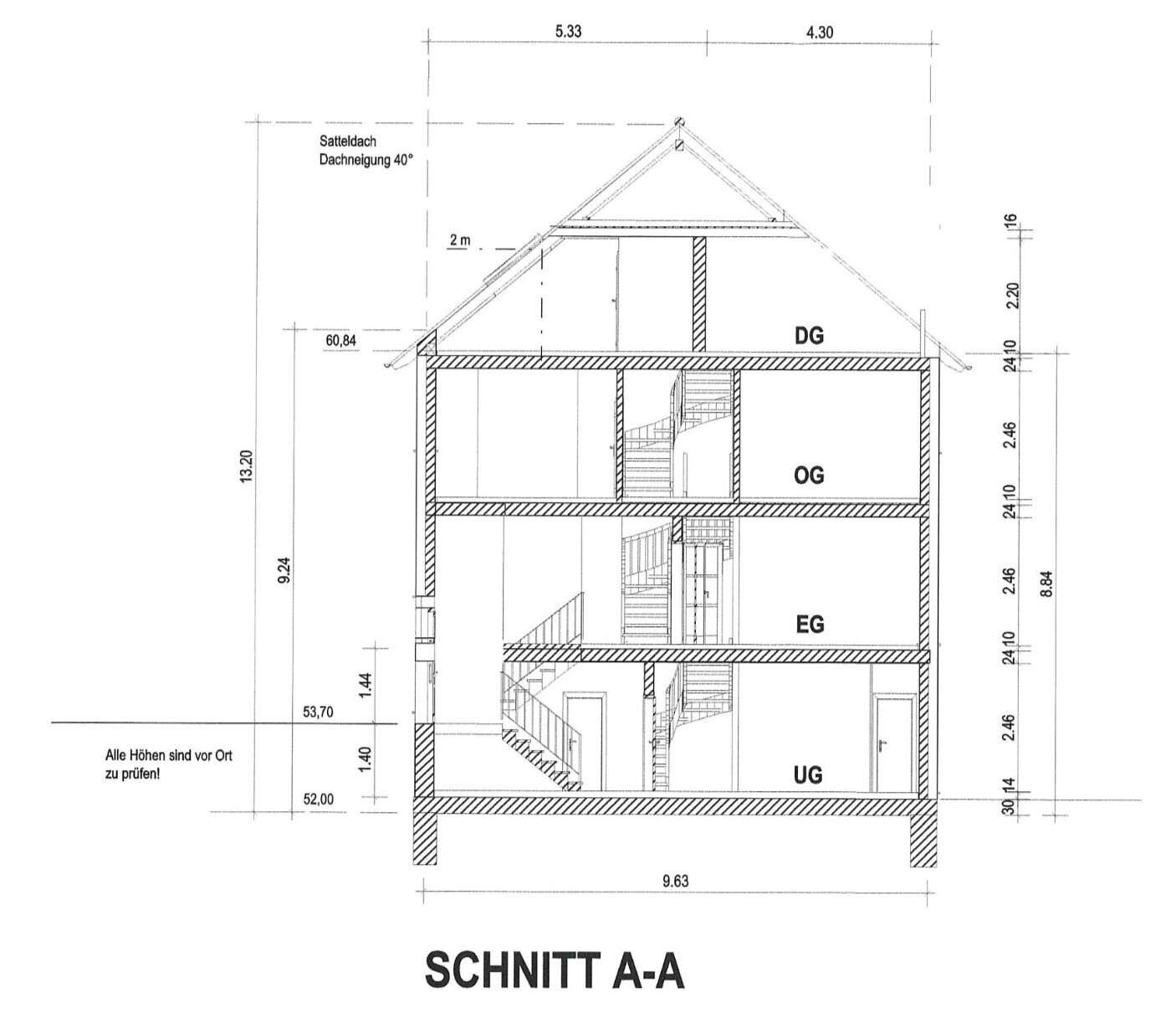

we (currently a family of four) are building on a very small infill plot in our dream location, which presents some challenges. We have worked on the attached floor plan for a long time and are mostly satisfied with it. Since it was created by us as non-professionals, we are considering having it revised by an architect, but we are unsure if that would be worthwhile. As a first step, we would really appreciate your feedback!!
On the east side of the building, we are building flush against an existing house, so the side dimension as well as the height and roof pitch are predetermined. The other side dimension was chosen to be as large as possible according to the required setback distances from the property boundary. (Note: the room layouts shown in the “Section” graphic are no longer up to date.)
Another special feature is that the street level (north side) is slightly higher than the garden level (south side). For a long time, we considered split-level solutions or simply one less floor, but we decided against this to retain as much living space as possible.
As a result, the living and dining areas are on two different levels, which is the main challenge of the project. It would be nicer on one floor, of course! But this provides quite large rooms. We chose to place the kitchen/dining area “upstairs” because we usually only use the living room from the afternoon onward, so in the mornings you don’t have to go all the way downstairs. To understand the plan: from the kitchen, you go upstairs on the right side and downstairs on the left side, where the staircase then leads outside the stairwell to the left directly into the living room in an open manner.
We are really looking forward to your opinions!!!

FamilieBausH schrieb:
Since we only start using the living room in the afternoon, basically there’s no need to go all the way downstairs in the morning.A small misconception that leads to a big impact:
When the garden or terrace is in use, it’s not the living room that is being used, but the dining area and kitchen. Daily activities take place in the kitchen, as well as outside on the terrace during summer. If you’re sitting in the garden, the indoor dining area is exchanged with the outdoor terrace. When grilling in the evening, you need quick access to the kitchen. On days with children playing in the garden -> kitchen, on mild summer evenings -> kitchen, during lawn care -> kitchen. The kitchen and terrace are connected through everyday tasks. The living room only becomes relevant after dark or in completely different weather conditions, specifically for relaxing or watching TV.
What would the consequence be if you considered placing the kitchen and dining area next to the terrace—that is, swapping the living room and kitchen?
I would consider mixing up the floors and even think about having the living room on the first floor, with the ground floor dedicated to the children...
nordanney13 Sep 2019 14:23ypg schrieb:
The small misconception that has a big impact:
When the garden or terrace is used, it’s not the living room that’s used, but the dining area and kitchen. Daily activities are carried out in the kitchen as well as on the terrace in summer. When sitting in the garden, you essentially swap the indoor dining area with the outdoor terrace. When grilling in the evening, quick access to the kitchen is necessary. For children playing in the garden -> kitchen, for mild summer evenings -> kitchen, for lawn care -> kitchen. The general daily routine connects the kitchen and terrace. The living room only comes into play after dark or in completely different weather conditions, mainly to cuddle or watch TV.
What would the consequence be if you considered placing the kitchen and dining area next to the terrace, swapping the living room and kitchen? I fully agree. I’m also against splitting living spaces between floors for practical reasons. Such a layout would be a dealbreaker for me.
The kitchen and dining area absolutely must be on the terrace level.
Since the plan was created by us as laypersons, we’re considering having it revised by an architect, but we’re unsure if it’s worth it. For laypersons, it already looks quite neat and is definitely worth revising later. However, the professional should do more than just a "revision," so don’t push the interface too far—that is, let them develop it based on this (even though it’s graphically worked out, it’s still rather at the sketch planning stage) instead of distilling it too much. I also fear there are still some incorrect assumptions in the basic concept.
On the east side of the building, we are building flush against an existing house, so the side dimension as well as height and roof pitch are predetermined. On the one hand, that follows my mantra very strictly; on the other hand, I want to point out that unless this is explicitly required in the building permit / planning permission or design guidelines, the house profile of the neighboring property is not strictly “law,” so your framework could potentially be more flexible.
Do you see any planning or conceptual mistakes or weaknesses from a practical or aesthetic point of view? At the moment, it’s hard for me to evaluate:
(Note: the room markings in the “Section” graphic are no longer up to date) That makes it difficult to imagine the house in “3D” when these plans do not match. Regarding the roof terrace, I see at least structural, insulation, and drainage challenges with all the resulting height adjustments. I also seriously doubt the dormer in the bedroom right against the party wall.
For understanding the plan: from the kitchen, you go up on the right side and down on the left; there, the stairs lead outside the stairwell directly open to the left into the living room. I’m very uncertain whether this through-passage solution really works well. It’s definitely far from “keep it simple, stupid.”
What kind of gap site is this: was the “twin” house never built, or was it demolished and the plot cleared?
We’ve long considered split-level solutions or simply one floor less, In this respect, I would most likely orient myself on the twin—what does it look like, and its plot, in a section view?
As usual, my recommended reading regarding a similar situation: https://www.hausbau-forum.de/threads/erster-Entwurf-Grundriss-efh-ca-200qm-bitte-um-Feedback.18830/ (slightly different house size but similarly deeper garden, comparable roof pitch, and some stair fiddling as well).
Dining area and kitchen opening onto the terrace

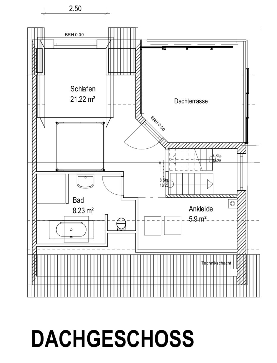

Living room opening onto the roof terrace?
You won’t really use it if it can only be accessed through the bedroom.
A split-level design would be an option. Why did you discard it?
The walk-in closet has limited storage space due to the sloping ceiling. Take a closer look at this.
A utility room accessible through the children’s bathroom could lead to bottlenecks.
