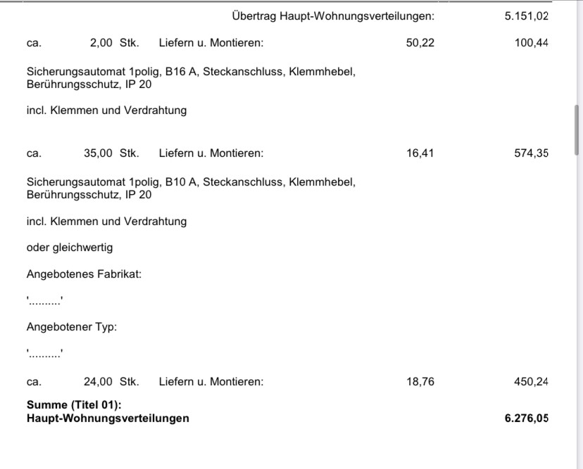

Page section with specifications for single-pole circuit breakers (B16/B10) including wiring.

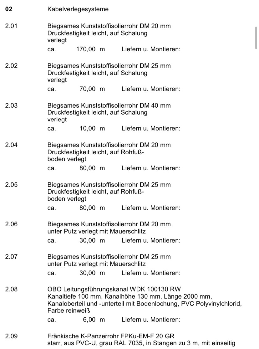

Overview of cable routing systems: flexible plastic conduits with diameters 20–40mm (0.8–1.6 inches) and length specifications.

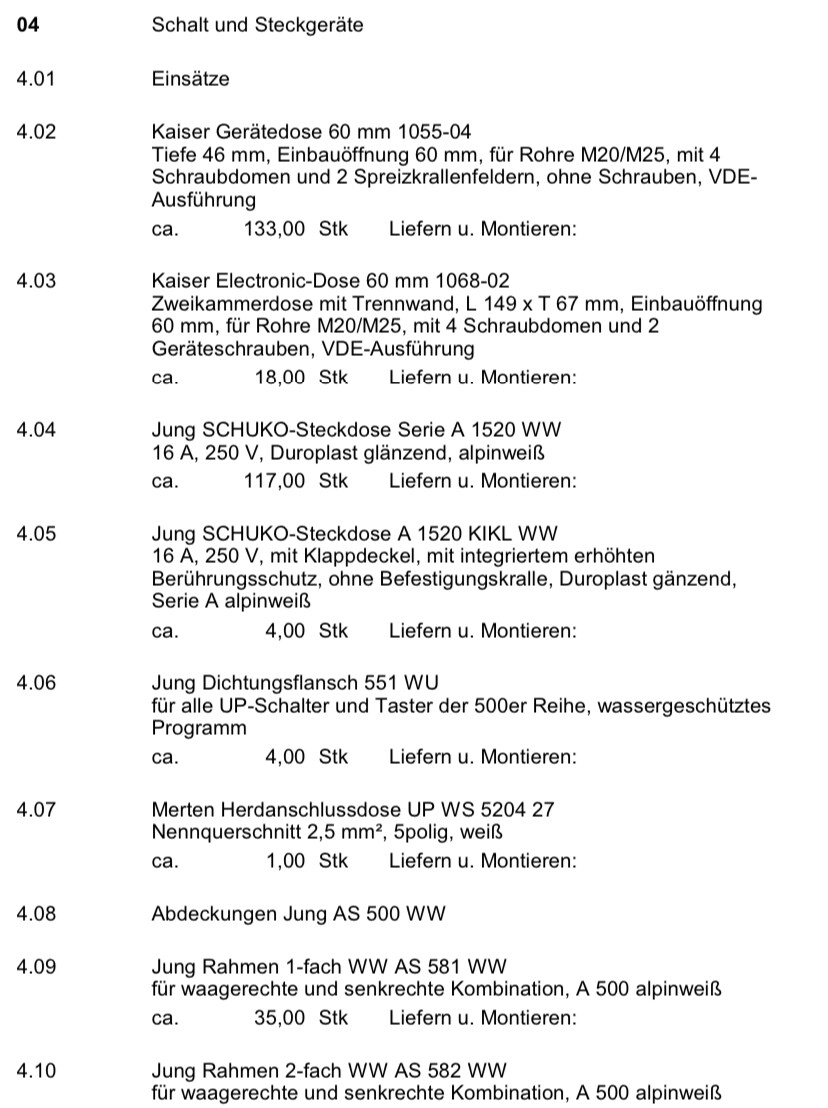

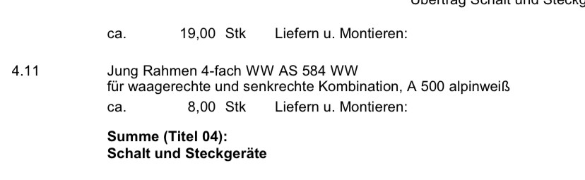

Page image of a component list: switches and sockets with model numbers and quantities.
Document with items for delivery/installation of switches and sockets, including total sum.

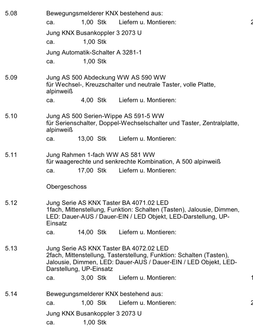

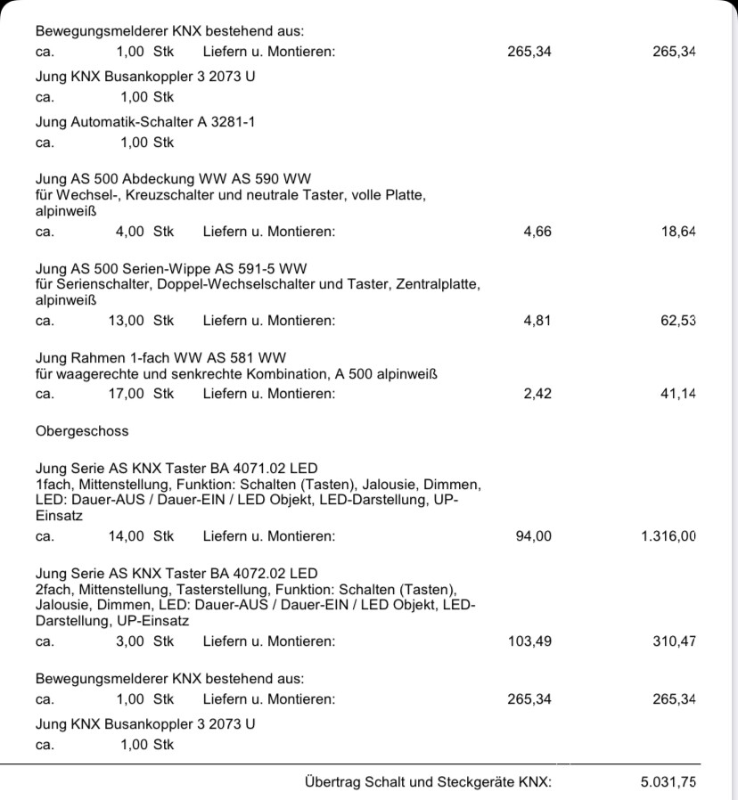

Document page with KNX switch and push-button list (Jung AS series) and LED object list.
KNX parts list with item names, quantities, and installation steps (5.08–5.14).

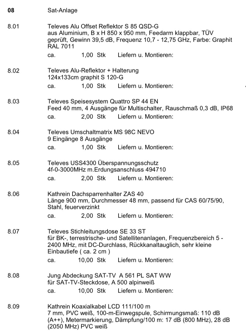

Satellite system parts list with Televes components and installation instructions (8.01–8.09).
Document with shopping list for satellite system: cables, connectors, sockets, mounting plate, quantity specifications.

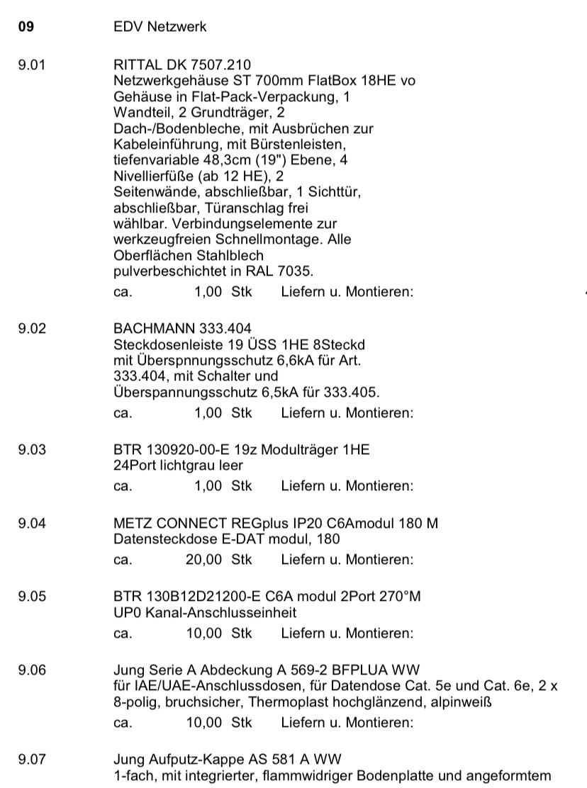

IT network catalog page with 9.01–9.07: enclosures, strips, modules, installation service.
Clear order list with dates, item names, quantities, and total IT network

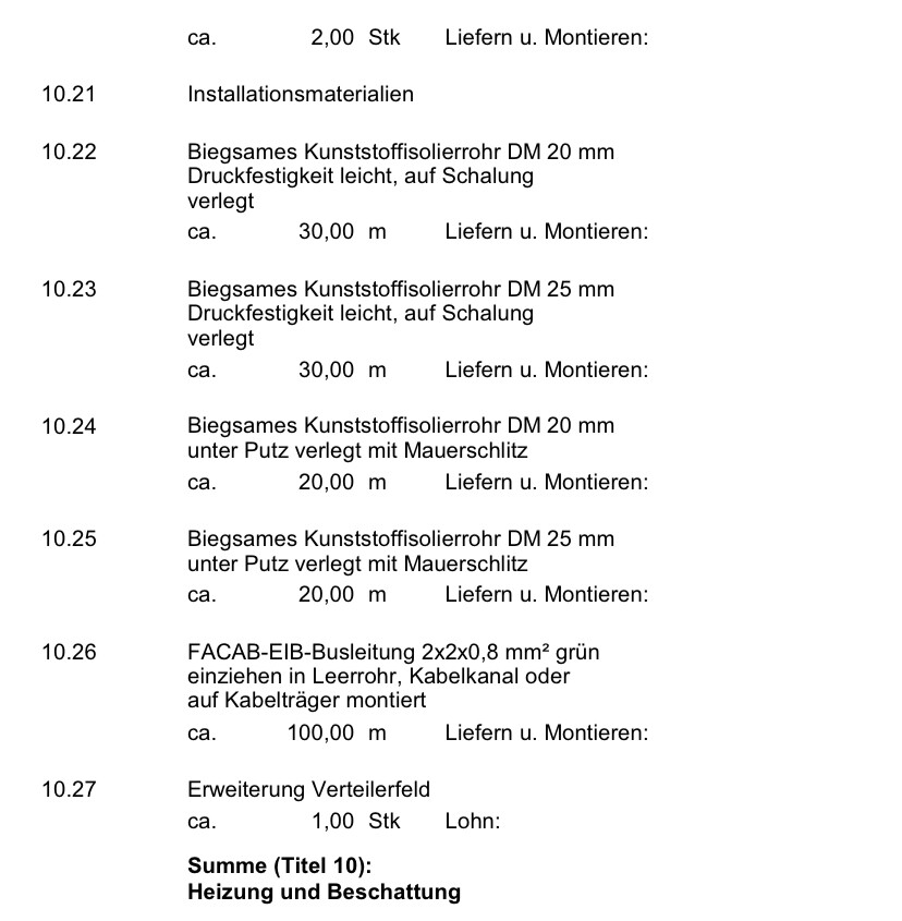

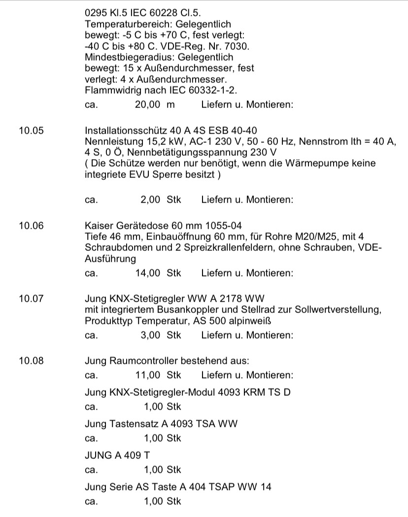

Document page: heating and shading with component lists 10.01–10.04
Technical parts list with date, position descriptions, quantities, and installation specifications.

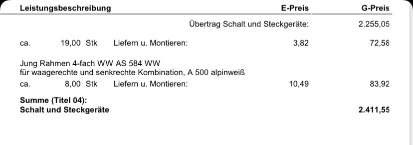

Is it your preference that the prices of the individual items are not visible? It is actually quite important to see them in order to identify potential savings...
Notstrom
21 Apr 2020 23:20
matte1987 schrieb:
Is it your intention that the prices for the individual items are not visible? It is actually quite important to see them in order to identify potential savings...
It became too large and unreadable, so I trimmed it. How can I upload a PDF?

List of distribution cabinet parts with quantities and prices.

Price list for switches and socket outlets with product descriptions, quantities, and prices.
Invoice table with item descriptions: switches and socket outlets, quantities, and prices.
KNX price sheet: switches and socket outlets, products, quantities, and prices.
Price list of KNX components with quantities and prices (motion detectors, push buttons, covers).
