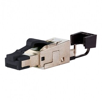

knalltüte
29 Feb 2020 10:24
Hi, but if you use connectors like these (they work very well...)
Shielded RJ45 network connector with locking mechanism
hanse987
29 Feb 2020 11:02
SteffenBank schrieb:
Yes, I skipped the patch panel for this, go ahead and criticize me . Seriously though, it was just about connecting 3 ports to a 5-port switch, and I really thought a patch panel was a bit overkill. Besides, what advantage would it have given me other than higher cost? The data rate wouldn’t have improved.
I had 25m (82 feet) of in-wall cable, which was more than enough. I still needed patch cables from the patch panel, though. With more ports, I would definitely have used a patch panel for better organization and so on.
Why should anyone criticize you? It’s your installation after all.
The in-wall cable should always end at a fixed point to minimize cable movement. With only 3 cables, I would have also skipped the patch panel and used two LAN dual outlets instead. This is mainly to prevent cable damage. Usually, two dual outlets don’t cost much more than three high-quality field-terminated connectors, if at all.
SteffenBank
29 Feb 2020 11:49
Well, using junction boxes would have been an option too. But the cables don’t move; the switch is mounted under the ceiling on the wall, and no one can reach it there. At the endpoints, I do have junction boxes, so the cable doesn’t run directly to the device.
rick201829 Feb 2020 12:16
But please do not use the connectors to connect a Unifi access point. There is not enough installation space, and additionally, the cable is too stiff. With three cables, this can be done well. Not improper.
