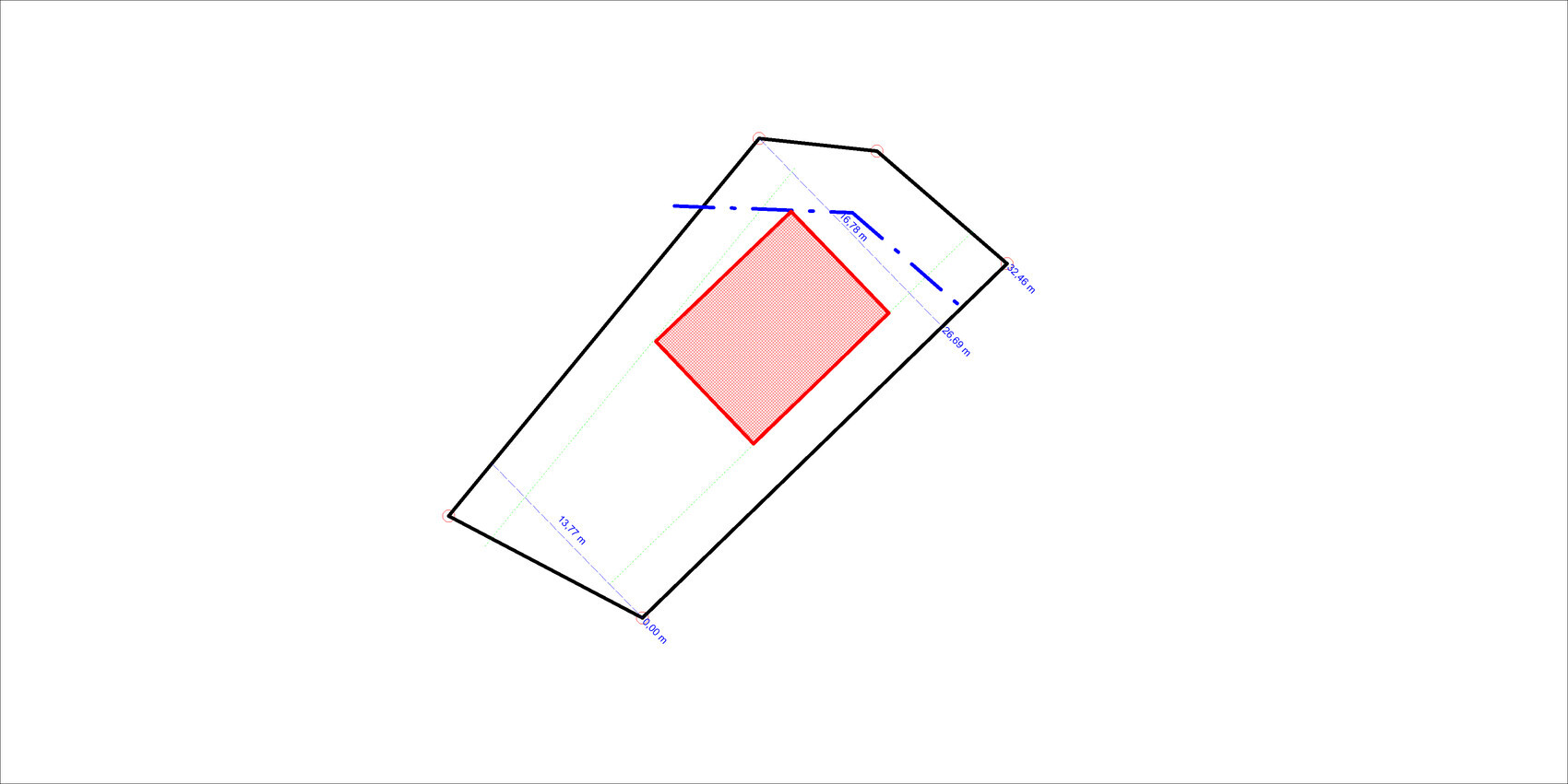

We would like to build a nice, small, somewhat traditional single-family home on the mentioned plot of land.
Due to the dimensions, the width will probably be limited to about 8.50 m (28 feet).
Since I do not have a measurement program, I can only make rough estimates.
The original idea was to build without a basement and still have a guest bathroom with a toilet and a small guest/workroom of around 10 sqm (108 sq ft) on the ground floor.
However, because of the limited width, we were advised against this, and now we are considering whether adding a basement would make more sense to avoid squeezing everything in.
The upper floor is planned to have the usual three bedrooms (possibly with a small dressing room) and a bathroom including a bathtub.
A real challenge at the moment is the knee wall height of 0.5 m (20 inches).
After inquiries at the building authority, it may be possible to submit a preliminary request regarding a two-story construction.
Maybe you have some good advice or suggestions about what makes the most sense regarding cost-effectiveness.
We are completely open regarding heating technology and ventilation systems.
Underfloor heating is fixed.
Unfortunately, we have not yet found the perfect floor plan. (Preferably, the living rooms would face south, and the kitchen and guest WC would be on the north side.)
Is our plan feasible with this plot? What should be especially considered when working with an architect or builder?

X 3470577.8589 Y 5753309.5880
X 3470585.3739 Y 5753308.7858
X 3470593.6803 Y 5753301.5770
X 3470570.4185 Y 5753278.9416
X 3470558.0615 Y 5753285.4520
I hope this works.
I hope this works.
Another challenge you have is that the building boundaries in the development plan are not defined either dimensionally or geometrically, especially at the turning circle widening. I have transferred them graphically. In my opinion, a 9m by 12m (30ft by 39ft) footprint should be possible, regardless of whether it is aligned parallel to the northwest or southeast boundary.
Subwoofer schrieb:Have you started looking for a new one yet?
But the architect said that a maximum of 8.5 by 10.5 meters (28ft by 34ft) would fit
Subwoofer schrieb:
Well, according to BPL, it's not really clearWhat do you mean by that? Do you have any other questions?
No, I don’t think so. You already mentioned that the edges of the turning area on the BPL are attached without precise measurements and are somewhat vague. In my opinion, the size of 9x12m (30x40 feet) should still be sufficient.
