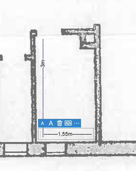

attached is the sketch of renovation 75 with self-drawn dimensions. The chimney, door, and window are marked; everything else is removed. The plan is to install a shower, a bidet, a washbasin, a heater, and of course a cabinet—something tall and narrow from Ikea will do.
The plumbing will be completely redone anyway. The only issue is the adjustment factor for my dad, you know how it is with older buildings... The washbasin has always been on the left side, and it should stay that way because it’s hard to imagine it being on the other side now 🙁
hanghaus20003 Jun 2021 12:51No toilet? Where is the soil pipe for the toilet, if there is one?
Why not draw how you would like it?
hanghaus20003 Jun 2021 13:42Maybe this could work? The partition wall made either of glass or clear or frosted twin-wall polycarbonate about 2cm (0.8 inches) thick and 1.80m (5 ft 11 in) high.
