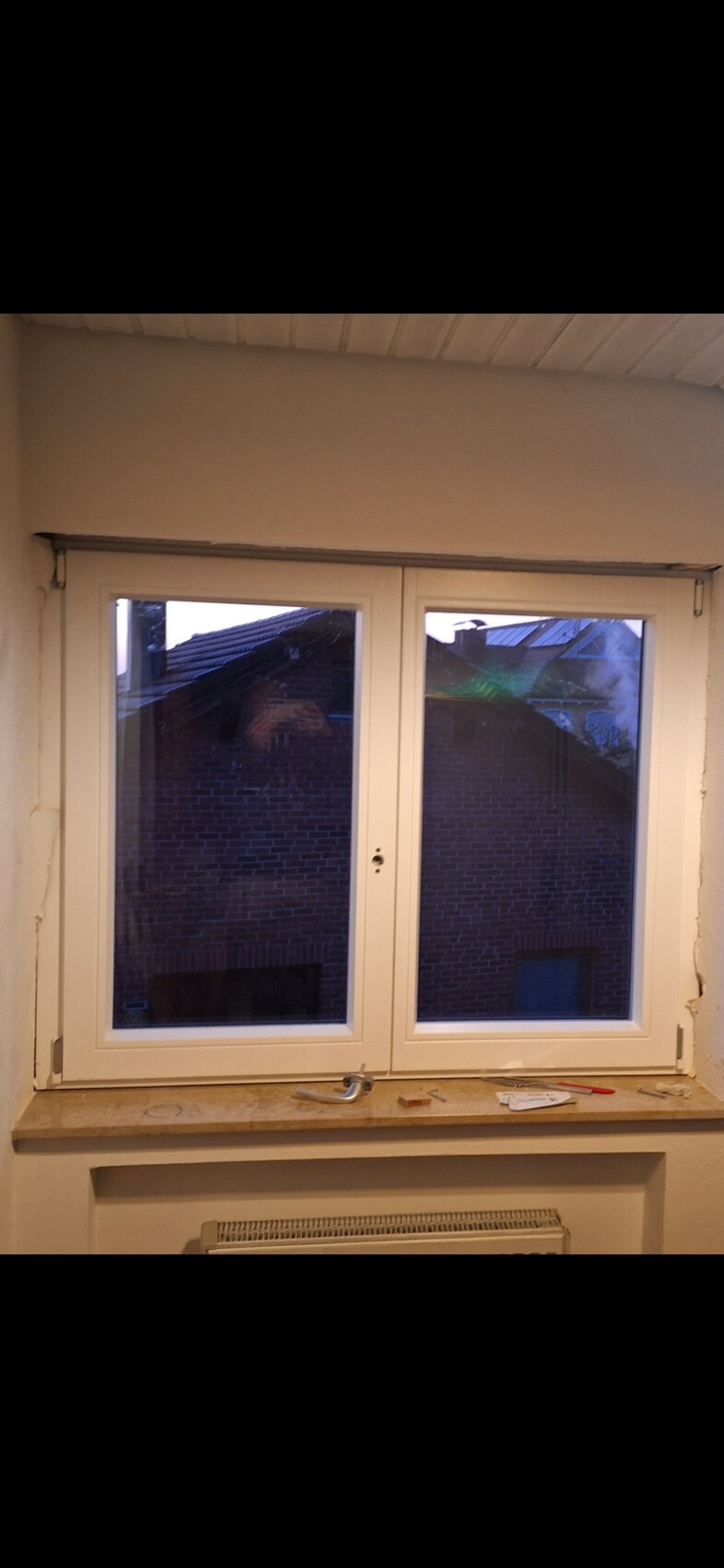

This year, I purchased windows from Isarholz through the local specialist dealer for self-installation. So far, I haven't found any quality issues. The windows are well-made, and the seals and warm edge spacers look clean and well-installed.
We have INO HA 80 made of pine, painted white on the inside and brown on the outside.
The hardware is from Roto, which I think is hard to criticize.
Isarholz manufactures in Slovenia, which I believe provides a price advantage compared to manufacturers from Germany and Austria.
I would recommend Isarholz.
Doppelfenster mit zwei Scheiben, Innenraum im Ausbau, Werkzeuge auf Fensterbank
