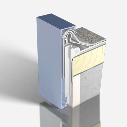

How did you build the roof? With an Alvitra or a pond liner?I can give you the height/width later, I need to measure it first, but I can tell you this much: SOLID.
The roof was initially covered with a special “membrane” (I can’t recall the name right now), then three layers of bitumen, followed by a roof edge profile as shown in the attachment…

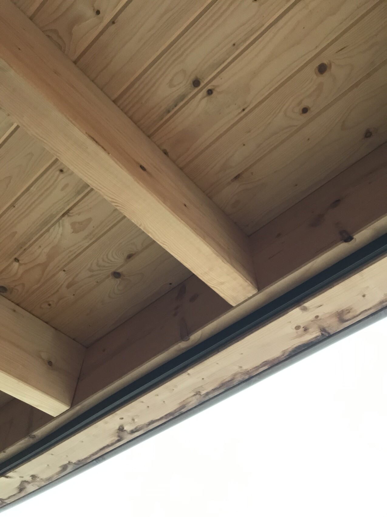

Have you thought about measuring the beams? Good morning
Unfortunately, I haven’t had the chance so far. However, this morning before leaving for work, I took a few pictures. I estimate the main beams to be about 25 cm (10 inches) high and roughly 10–12 cm (4–5 inches) thick. The larger beam that carries the main load appears to be around 25–30 cm (10–12 inches) high and 10–15 cm (4–6 inches) wide.
