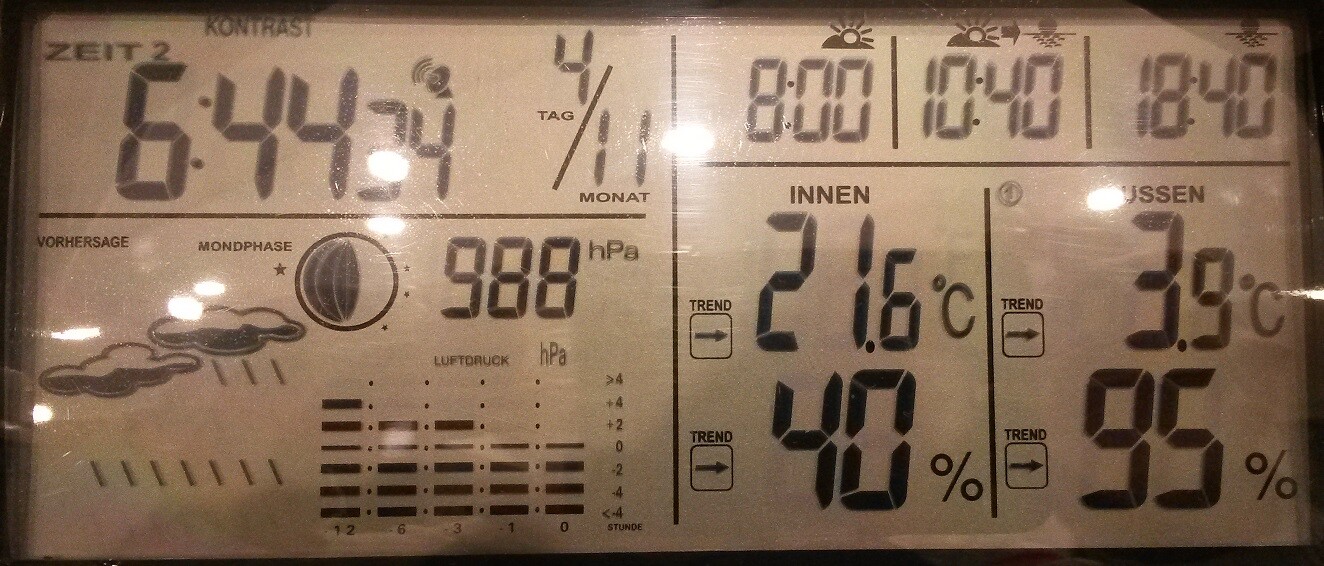

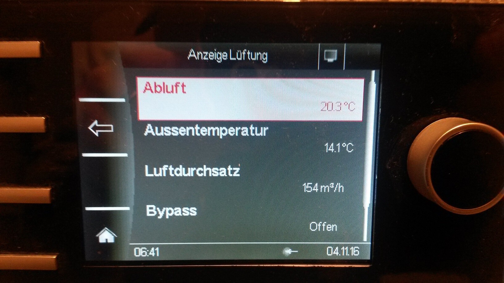

See the images: Outside temperature: 3.9°C (39°F) -> Ground heat exchanger -> Temperature at ventilation system inlet 14.1°C (57°F) -> Heat recovery and heating = Indoor temperature 21.6°C (71°F) -> Heat exchanger -> Temperature at ventilation system outlet 20.3°C (69°F)
