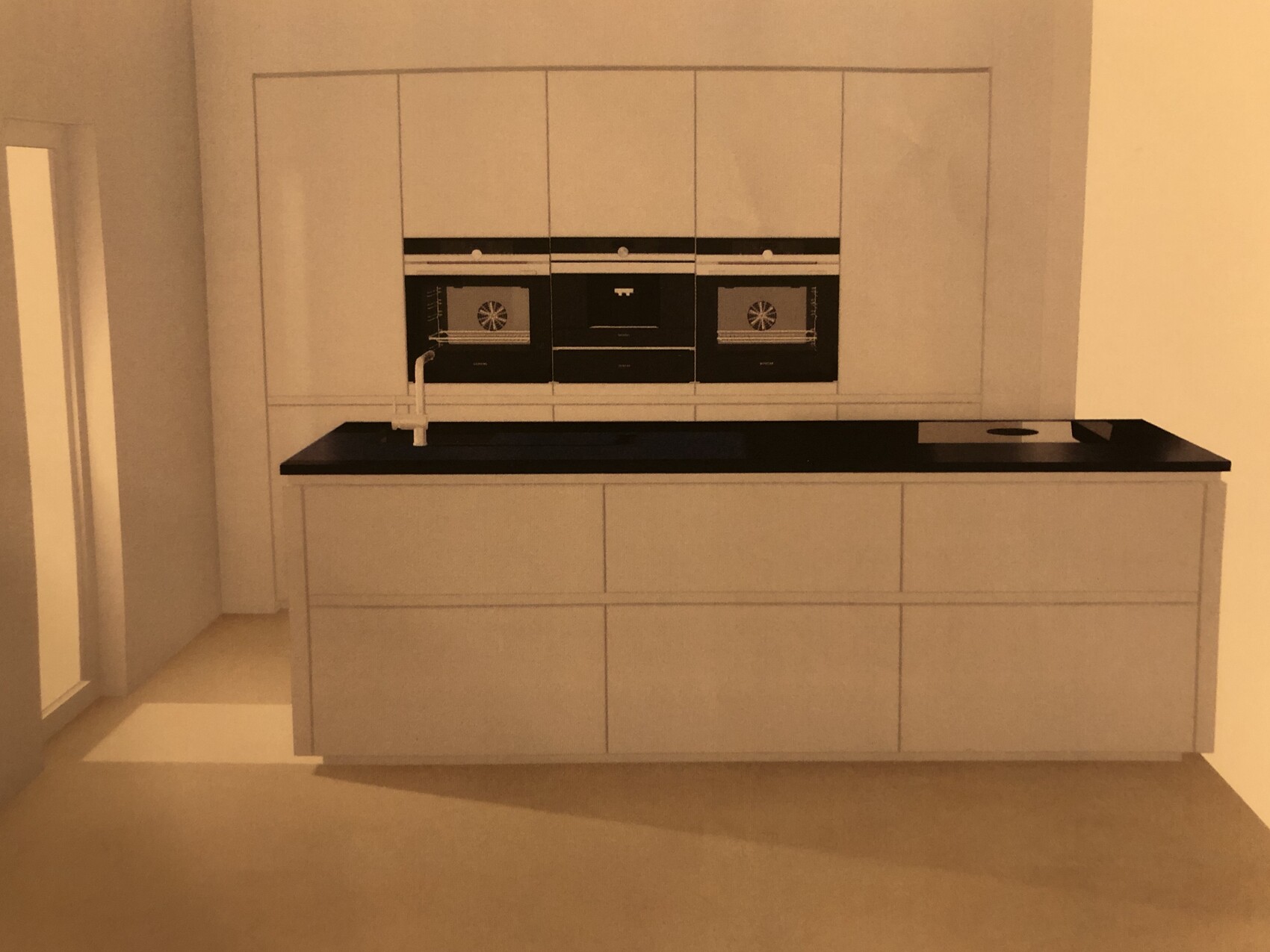

17 Sep 2019 22:40
This is how it should look—actually quite simple—but we didn’t receive an installation plan without a contract. I will ask our electrician about it.
Thanks to everyone
