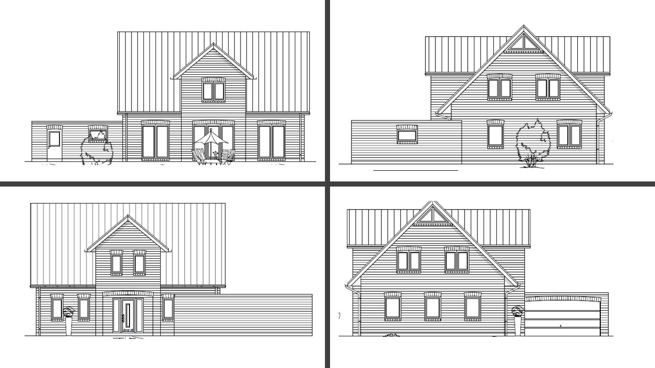

We are currently building our single-family home and have deliberately decided not to install recessed lights in the roof overhang. Instead, we want to illuminate the building from below.
However, we are quite uncertain about the following points:
- Number of lights
- Placement of the lights
- Beam angle
- Which types of lights are recommended? The garage door should also be illuminated, so the lights would need to be trafficable, etc.
In short, this is all new territory for us, and I would appreciate any ideas or suggestions you might have.
You can find an exterior view of our single-family home attached.
Thank you very much 🙂

Myrna_Loy8 Aug 2021 20:58There are numerous suppliers available, such as We-Ef, for example. Additionally, various attachment lenses are offered for different light dispersion effects. However, as mentioned, ground spikes are not permanently stable, so the floodlights tend to wobble, and recessed housings often fog up from the inside. For low-level ground lights, insects like ants frequently nest inside. All ground-mounted lights cause issues of some kind.

Myrna_Loy8 Aug 2021 22:11driver55 schrieb:
If you’re willing to spend more, there are no problems!
(Many venues and buildings are illuminated this way…)
But with fixtures costing $19.90, that usually won’t work.
(And no, we don’t have those.) Unfortunately, price is not the main factor here. Professionally, we have tested and installed almost every type of recessed ground spotlight. After just a few months, they all experience issues with condensation. None of them are 100% watertight.
Beleuchter1238 Aug 2021 22:27Myrna_Loy schrieb:
Unfortunately, price does not matter in this case. Professionally, we have tested and installed almost all types of recessed floor spotlights. After just a few months, all of them have issues with condensation. They are simply not 100% watertight.Can you recommend any other suppliers besides We-Ef? Are We-Ef products only available through authorized dealers?
Myrna_Loy8 Aug 2021 22:48Beleuchter123 schrieb:
Can you recommend any suppliers other than We-Ef?
Can I only get We-Ef products through a specialist dealer? We have also tried a lot from iGuzzini; I personally installed one model at home. It was a wall-mounted light fixture, model "Walky," round shape. But everything went through our electrician.
hampshire9 Aug 2021 09:30As long as you don’t direct the light straight into the sky but only cause some diffused light, this is acceptable in terms of light pollution. The roof overhang acts as a good light barrier.
Regarding lighting, we have had great experiences with stage lighting equipment. At the music school, some of these surprisingly affordable lights are used and they do not cause any moisture problems. They were purchased from one of the largest music stores in Europe located in Cologne.
