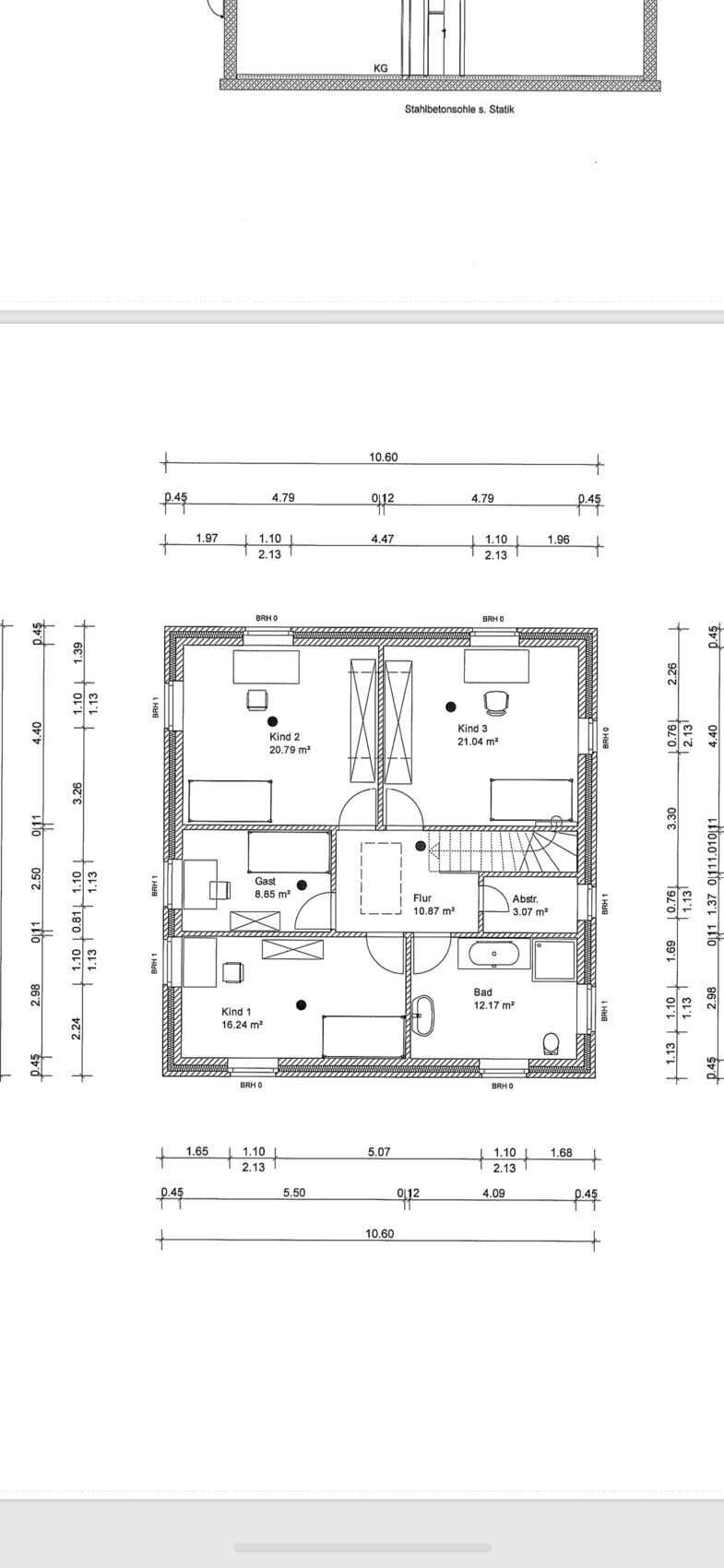

ᐅ I am not entirely satisfied with the floor plan.
Created on: 7 Aug 2018 21:49
Tatjana44536
I am not really satisfied with the result. The architect is somewhat older, maybe that is the reason. Please provide some modern suggestions.

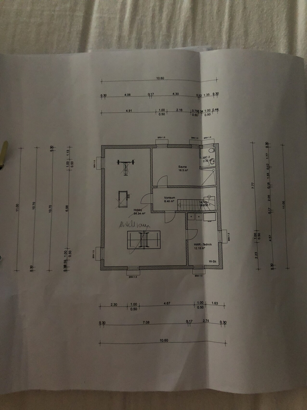

The basement is used as a living/party room, and there is an attic as well.
The upper floor has been modified.
Bookstar
8 Aug 2018 21:38
What just occurred to me is that the house does not have a single load-bearing interior wall! That is highly unusual and would at least cause me concern.
Z
Zaba12
8 Aug 2018 21:45
17.5cm (7 inches) is load-bearing. 11.5cm (4.5 inches) is non-load-bearing.
Bookstar
8 Aug 2018 22:16
That is clear, but I don’t see any 17.5cm (7 inch) above.
Z
Zaba12
8 Aug 2018 22:20
Bookstar schrieb:
That’s clear, but I don’t see any 17.5cm (7 inch) ones upstairs
Oh. You’re right. I only looked at the ground floor.
truce8 Aug 2018 22:35
But even there, the plan is quite odd. Sometimes the walls are 110mm (4.3 inches), then 120mm (4.7 inches) again. It looks as if the “architect” only has a “basic” CAD program that can’t handle decimal values.
11ant8 Aug 2018 22:57
truce schrieb:
Once 11cm (5 inches) walls, then 12cm (5 inches) walls again.
There is no Octameter rhythm involved here.
By the way, the green forum is also full of praise about this.
