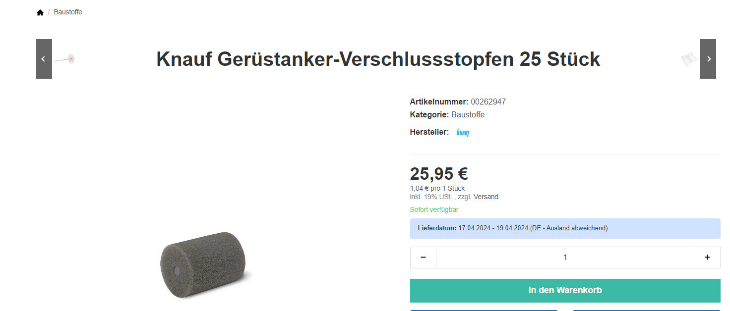

nordanney15 Apr 2024 18:26There are special plugs available for this. Alternatively, you can use pre-compressed, round sealing tape (then a cover cap with sealant or, alternatively, plaster with a finishing coat).

So that no thermal bridge or similar occurs. Did you not read my answer?
These things are usually about 4cm (1.5 inches) long. You don’t use more than that. Behind it, there is a still air layer, so no thermal bridge forms.
This is standard practice — but of course, you can also do it yourself.
P.S. Why are you doing this yourself? Isn’t it included in the scope of work for the ETICS contractor?

FrankChief15 Apr 2024 18:59Oh, sorry.
I thought you use the plug if you don’t plaster the hole.
So, you put the plug in, then apply plaster, let it dry, and then dab paint on, and that’s it, right?
I’m not doing it myself, they do it, but I just wanted to know the correct procedure so they don’t cut corners or do any shoddy work.

nordanney15 Apr 2024 19:10FrankChief schrieb:
So, just insert the filler, then apply the plaster, let it dry, dab the paint on, and that’s it, right? Yep. That’s exactly how it’s done. If the guys do a proper job, you won’t see any traces afterwards.
