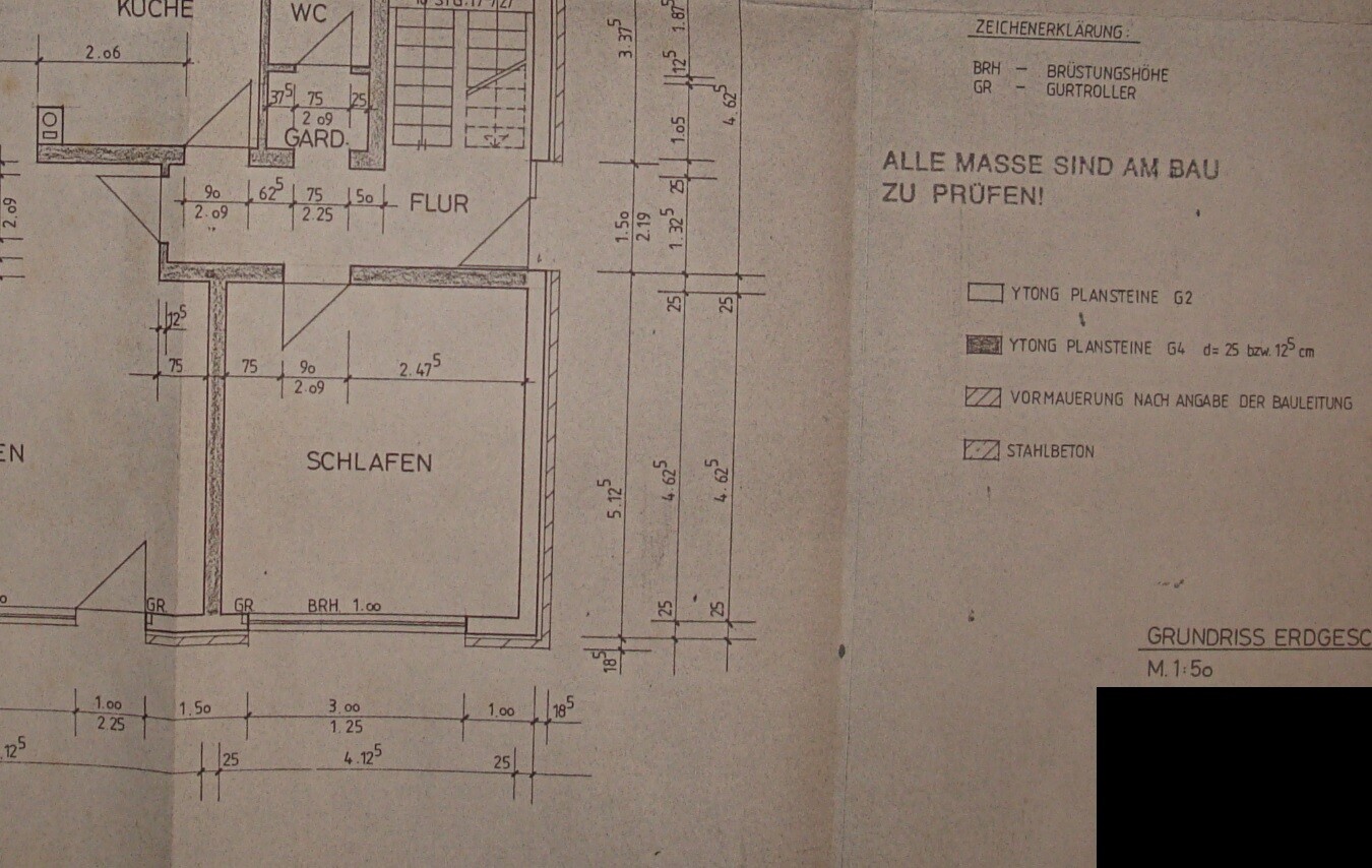

Exterior wall construction:
Aerated concrete blocks: Ytong Plan stones G2 = 25cm (10 inches)
Facing brickwork = clinker brick
Between the Ytong blocks and the clinker brick there is something — I think air. You can see it here on the floor plan:
I want to improve the insulation of the house. Is that worthwhile, or is it more cost-effective to tear it down and rebuild?

Hi! Your first point of contact would probably be an energy consultant. You might consider blown-in insulation, which is relatively affordable (under 5000€ for a single-family house). This involves drilling many small holes into the joints and then blowing in insulation flakes. It’s inexpensive, quick, and effective.
What you can also safely do yourself is insulating the top floor ceiling. There are many guides available online and on YouTube for this.
