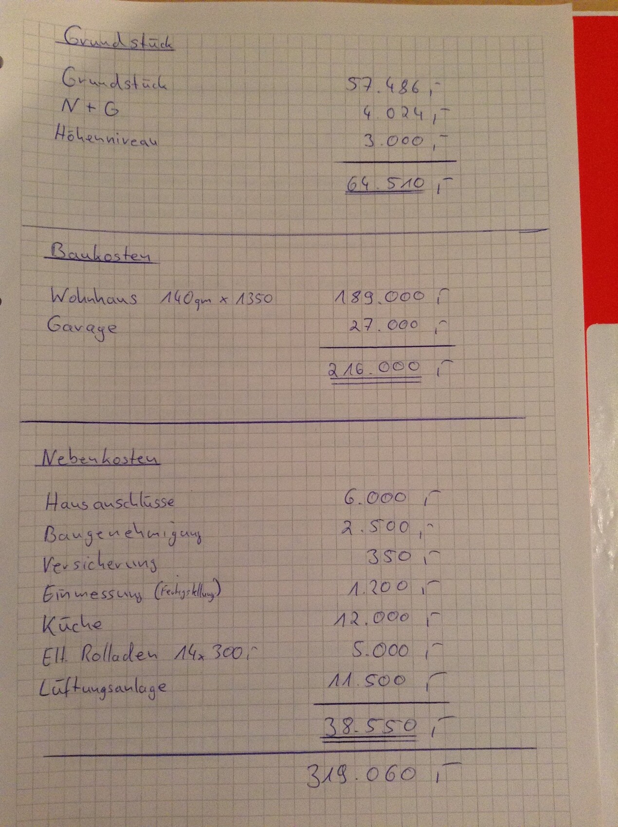

I simply categorized all of that under incidental construction costs, which was my mistake.
Electricity, gas, etc. were estimated at €350. The connection fees, however, are €6,000.
It is also planned that most of the work will be done as DIY.
Outdoor areas (paving, garden, hedge) €10,000
Upgrades (electrical, flooring, etc.) €10,000
Furniture, lighting €8,000
You have €3000 included for groundwork. However, that is the best-case scenario; some people with slopes and challenging conditions end up with a zero added to that amount (though that is unlikely in this case).
However, €1000–1500 is missing for a soil survey, possibly including a chemical soil analysis for the landfill.
Marvinius11 Jun 2017 11:38If I base this on our "turnkey" price (yours is 189,000), then we have the following additions: 1) Upcharges: about 12%, 2) Civil engineering costs, about 12% (increased due to basement and sloping site), 3) Painting and flooring: 12%, 4) Exterior landscaping: 10%, kitchen, lighting, and furniture: 10%, 5) Utility connections, fees, taxes, and inspections: 8%.
Marvinius11 Jun 2017 11:40So overall, 64% higher costs
Marvinius11 Jun 2017 11:42You would need a budget of nearly 300,000 euros plus the land. However, you would be on the safe side since you are building without a basement.
