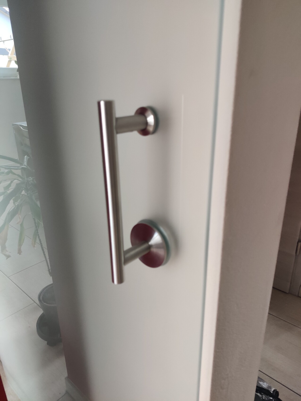

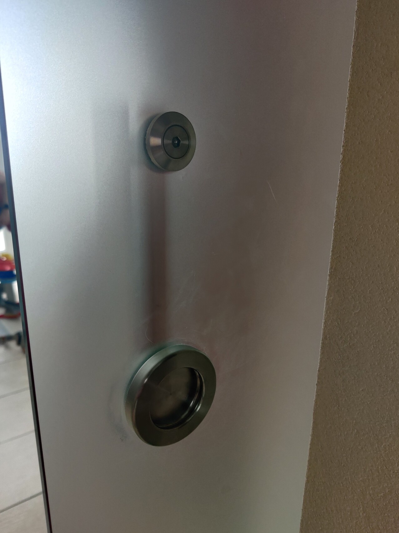

We have a clear opening width of 86 cm (34 inches) and a combination of a bar handle and recessed pull on the glass sliding door. This is continuously screwed in place and not glued.
This allows the door to open fully across the entire width and it can be operated from the living room side using the bar handle and from the hallway side using the recessed pull.
