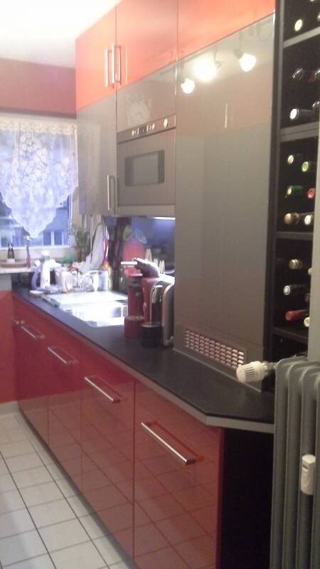

I also used a 60x80 Ringhult door front for the base cabinet with waste sorting and a beverage drawer that is heavily loaded, to keep the side fronts consistent.
So far, no problems. I installed the handles about 15cm (6 inches) from the top.
The upper section inside the cabinet, where you would normally see the sink, I covered with cabinet scraps/shelf pieces, which looks good as well.
best regards, robi

IKEA-Experte1 Apr 2016 12:10Hello, the reason it is not planned is for aesthetic purposes. With a 60cm x 80cm (24 inches x 31.5 inches) front, the sink is more visible.
