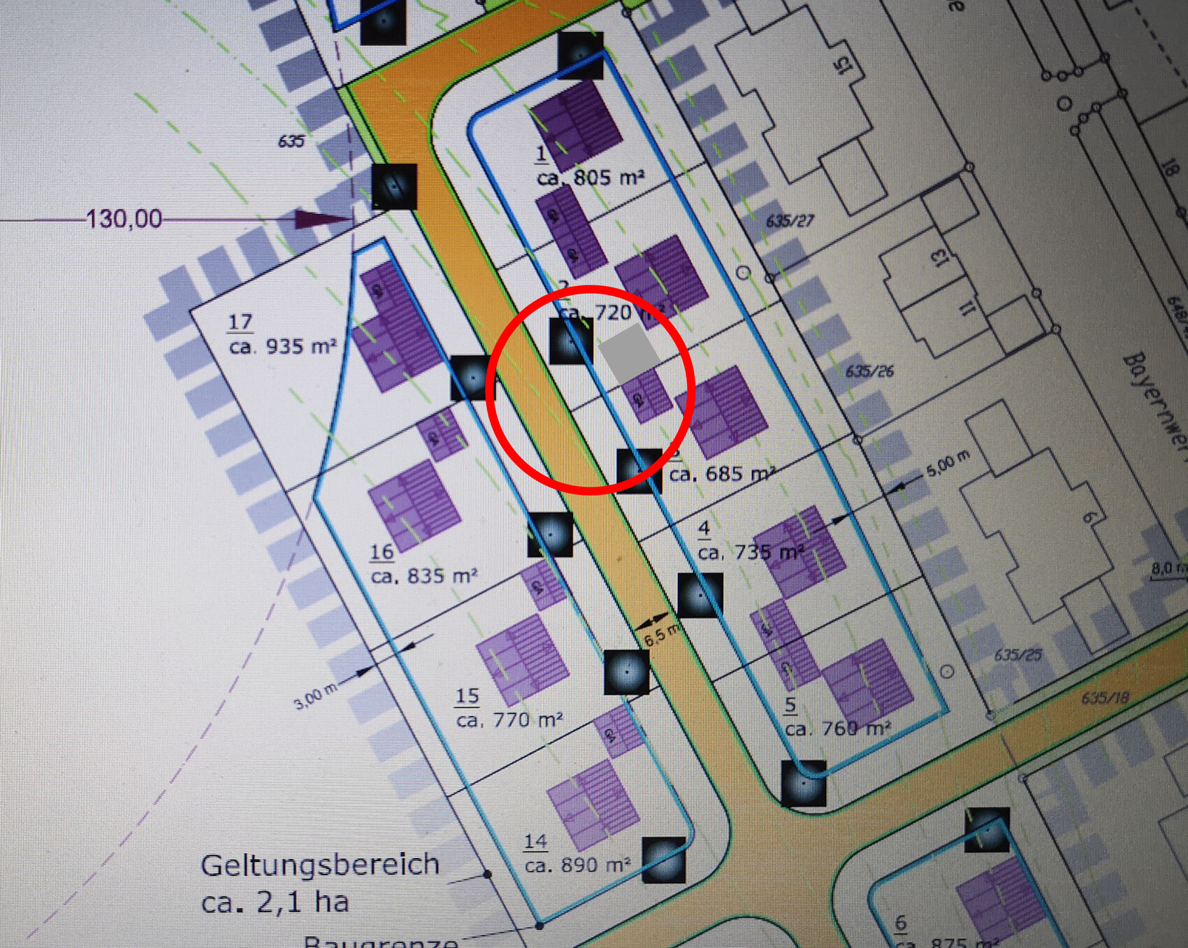

I seriously wonder how these assumptions and resulting interpretations come about. When did I say that we are sitting between smelly and noisy cars at the neighbor’s driveway? That is in the plans you attached. Here is the terrace situation (gray) as it currently appears to the reader:Sternchen31 schrieb:
We also now know from the neighbor to the right of us that he is building his garage on the right side of his house, which means his property comes first, then his house, then the garage, which is also completely parallel to the house, so we won’t even see it.No one could have guessed that. So the neighbor is basically blocking off the south side instead of yours. That’s considerate of him. Sternchen31 schrieb:
Regarding the smelly exhaust: this is neither a through road nor a main street or anything like that, but just an access road to the new development area, and since there is one on the other side as well, only part of the development will use this road, of course including guests, mail delivery & others.Yes, and also all the pedestrians, dog walkers, etc. You’ll just be sitting there in the front yard. That’s okay if you like it. Really, I’m not trying to judge. In my village, older men also meet in someone’s front yard to chat, because it’s nice there.Sternchen31 schrieb:
In my opinion, the garden is completely excluded from the planning. Honestly, how do you come to that?The garden is behind the house. But practically you can’t get there. Only your son will likely use it, but probably won’t be interested. From the bathroom—okay, but if I want to use the bathroom, I usually have other things on my mind than going to the garden afterward or the other way round. Also, people don’t like walking through there when someone is using the toilet. So to get to the garden, you have to walk all around the house, up stairs, through the entrance area or at worst through the bathroom downstairs. That’s all too inconvenient for there to be a real connection. Also, what are you planning to do in the garden? You already have a terrace at the road side.Sternchen31 schrieb:
