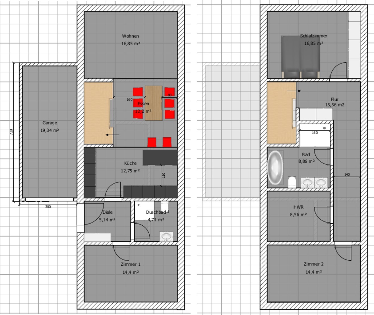

simonmarkus1973 May 2020 18:21RomeoZwo schrieb:
I did a bit of playing around... the narrow house is really interesting...
- Shower bathroom on the ground floor
- Guest room on the ground floor (or office)
- Utility/technical room on the upper floor (I think @goalkeeper even has that on the second upper floor)
Depending on the plot orientation, it might be mirrored. Windows are still missing.
I added some furniture (with realistic dimensions) in critical areas.
Which software did you use for that? I can already tell there’s a lot of potential, judging by your idea. That makes me optimistic.simonmarkus197 schrieb:
Which program did you use for this? This is SweetHome3D. Is it good? - No, because it doesn't handle stairs properly. The stairs are 3D objects that you have to download separately. I usually take something roughly suitable and then enter the measurements from the stair manufacturer. Otherwise, it’s relatively easy to use. Warning!!! – most of the furniture in the standard library is too small. But you can manually adjust the dimensions. Unfortunately, it also cannot model sloped ceilings.
