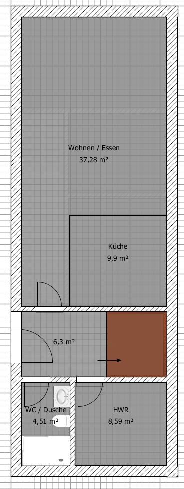

here is my question for you again.
We finally have a plot of land in prospect for building a single-family house. The whole project is being sold through a developer.
Since the houses on the right and left will remain, we have to comply with the required distances of 3m (10 feet).
I still have no idea whether the house will eventually seem too narrow to me. Unfortunately, there are not many model homes with these small dimensions.
I would appreciate any tips and suggestions for improvement.
Plot size: 425m² (4573 ft²)
Slope: none
Building zone: 3m (10 feet) from the street, 15.60m (51 feet) house length and 5.60m (18 feet) width for the house and additionally 3m (10 feet) width on the left for the garage.

What do you not like? Why?
- Small kitchen
- Small bathroom
We definitely wanted an open floor plan because our daily life mostly takes place outdoors in the summer and otherwise in the living room or kitchen.
- General opinion on the floor plan
- See “what I don’t like” – suggestions for improvement welcome

Search for Schwabenhaus FAME-E-104. Although it is 6m (20 feet) wide, it might offer some ideas for you.
I think moving the entrance on the garage side further towards the center of the house has advantages for the layout. I would also experiment with a double spiral staircase opposite it...
What wall thicknesses does the house have? With the limited width, it is very important to reduce them as much as possible.

YPG, do you have any more ideas for me?Yes, actually I do. Possibly since yesterday. If you could tell me (you unfortunately left out important details in the questionnaire... the questionnaire was created by me, and every question serves a purpose. It exists so that I or we don’t have to keep asking and waiting for information, because after three days even the most interesting question here in the forum loses relevance and the thread’s half-life is over), about your daily routine or age, so conclusions can be drawn about when certain areas of the house are used most (guest room, home office), especially if you’re not already revealing that, in case the garage might need to be located on the other side. However, for that, the site plan would also be necessary to see if the garage can or may be moved to the other side, and the zoning plan would also be quite interesting here to check for any restrictions regarding the building envelope or what dimensions are relevant. Also, are there neighbors who might be affected negatively by the use of a terrace somewhere? For your information: I’m not going to look back through other threads, so I need more concrete information.
If it becomes a problem: possibly mirror the house and remove a wall. The staircase can be placed anywhere...
I would personally choose such a project over a standard house!
RomeoZwo schrieb:
I would also experiment with a double half-turn staircase opposite ... No. That would take away all the elegance of the house.
No. That takes away any elegance from the house.Do you think so? Why? It creates a nice hallway on the upper floor with a window above the front door. I still need to consider the upper floor layout... On the ground floor, it reduces wasted space in the hallway and provides more flexibility for living, dining, and cooking.
