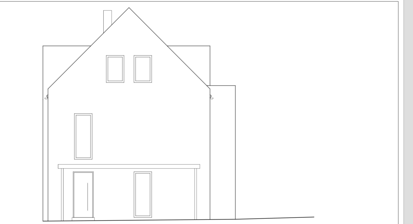

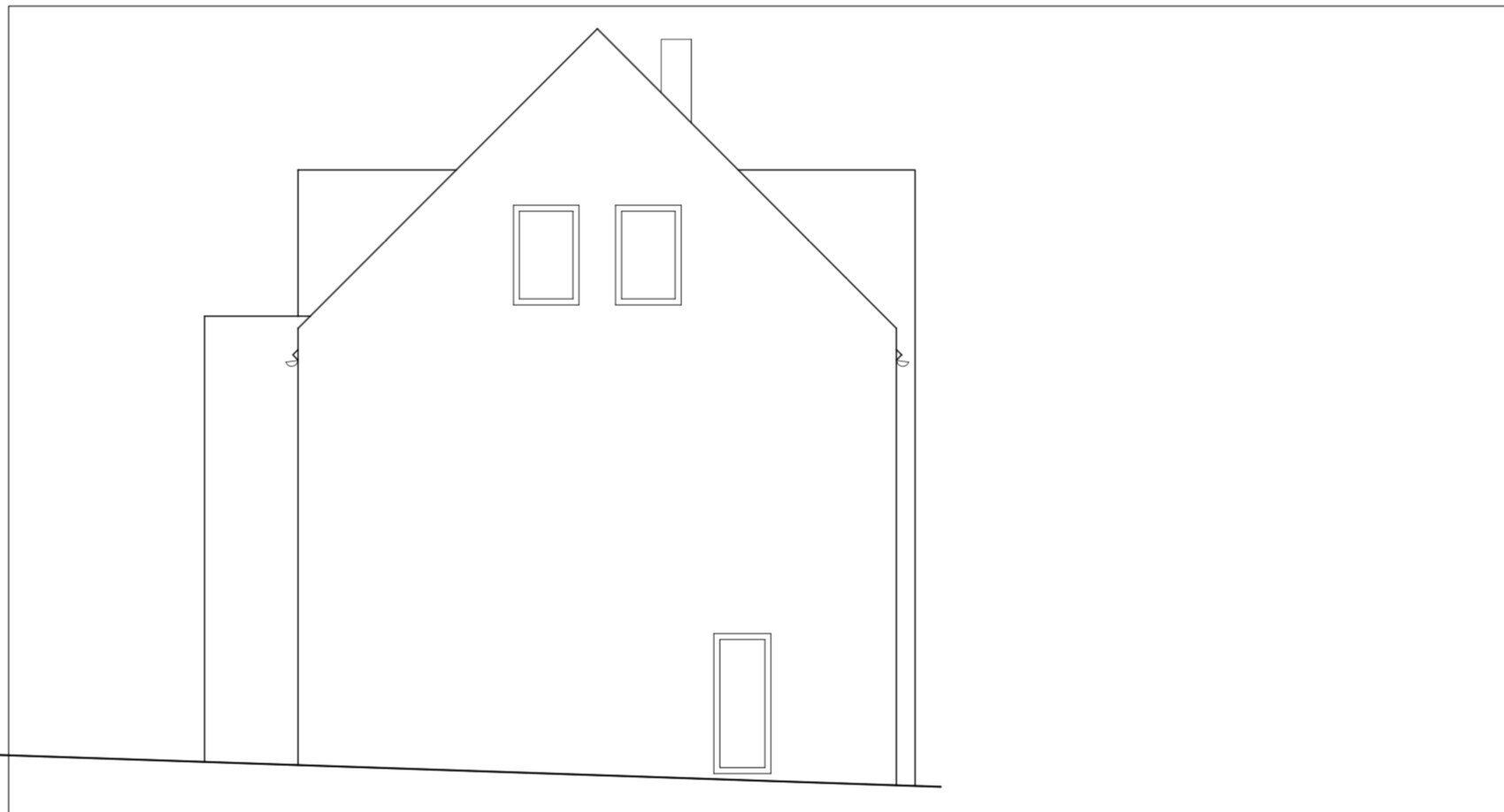

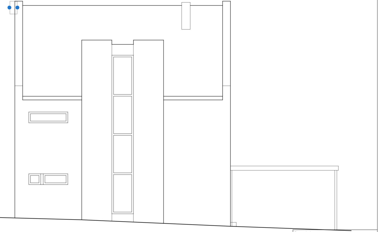

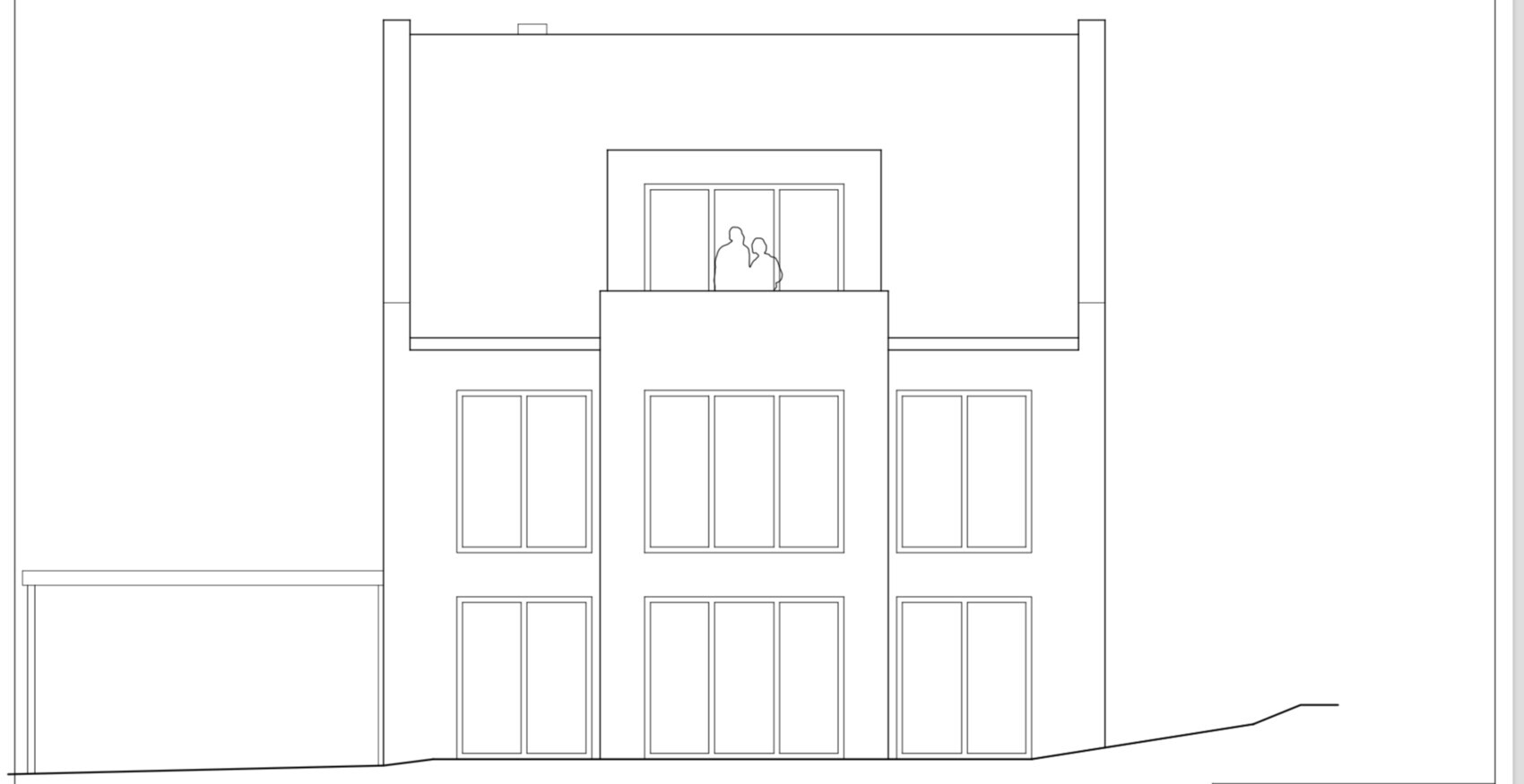

Amosa34 schrieb:
I'm stuck – do you mean the legend or the exterior view?I mean tubeless and legend-free, simply the elevations corresponding to the floor plans (but sections are also welcome).https://www.instagram.com/11antgmxde/
Attached are the exterior views. We will cover the roof entirely with gray flat roof tiles (Linea), which means there will no longer be a parapet wall here.
The north view shows the perspective from the street onto the single-family house. We are considering whether to possibly clad the bay window with facing panels. Does anyone have experience with this? The idea is that the windows and front door will be anthracite, and to make it stand out or look special, we are thinking about visually separating the bay window a bit.
If you want something special, I wouldn’t compromise that uniqueness by not extending the gable walls through the roof covering. I would probably choose a different paint color for the west side (on both sides up to the bay windows).
