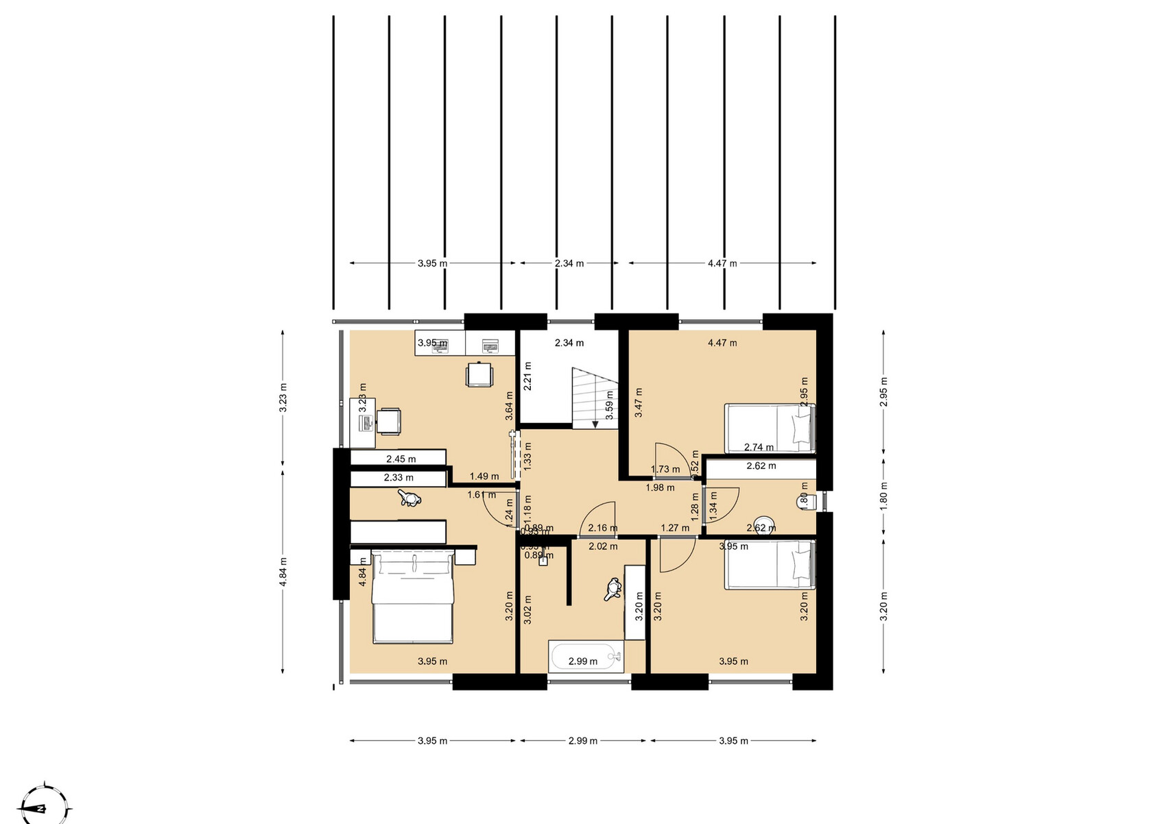

Dear Forum,
We have revised our house plan together with a planner and are now very satisfied with it. However, I would be interested to hear your thoughts or if you have any suggestions for us. Thank you!
Plot size – approx. 700m2 (8,400 sq ft)
Slope – no
Site coverage – approx. 168m2 (1,810 sq ft)
Floor area ratio – 81.5m2 (880 sq ft, ground floor), 86.1m2 (927 sq ft, first floor)
Building envelope, setback line, and boundary
Edge development –
Number of parking spaces – 1-2 cars, but not directly next to the house
Number of floors – 2 stories
Roof type – gable roof (approx. 15°)
Architectural style – inspired by the architecture of the adjacent wine cellars (gable roof with tiles), interpreted in a modern way (large windows)
Orientation – west
Maximum height / limitations – unknown
Additional requirements – The building area already has a concrete slab foundation (old garage, structural integrity confirmed). On three sides it borders halls. To the north is a hall with a sloping roof (lowest point about 1.6m (5 ft 3 in) high near the front, sloping up to about 2.8m (9 ft 2 in) towards the east). To the east, the adjacent hall is as high as the ground floor; from the utility room there should be a door leading into it. To the south are my grandmother’s house and garden.
Style, roof type, building type – inspired by the architecture of the adjacent wine cellars (gable tiled roof), modern interpretation (large windows), single-family house
Basement, floors – no basement, ground floor, first floor, and an unfinished, unheated attic
Number of residents, ages – 3 people (37, 33, 1) and a dog
Space requirements on ground/first floor –
Office: family use or home office? – home office for two planned on the first floor
Overnight guests per year – ?
Open or closed layout – open
Traditional or modern construction – modern
Open kitchen, kitchen island – open kitchen with island, sliding window above the worktop
Number of dining seats – 6-8
Fireplace – yes (on the north side in the plan), with open viewing window, integrated seating area; should partially heat the floor heating system; flue should extend slightly beyond the north wall
Music / stereo wall – unknown
Balcony, roof terrace – terrace only
Garage, carport – yes, but not directly attached to the house; located in the southwest corner of the garden to shield the neighboring utility building to the south and west
Kitchen garden, greenhouse – kitchen garden for play, living, and gardening
Other wishes / special features / daily routine, including reasons for choices or exclusions
Planning by:
DIY together with a planner
What do you like most? Why?
The open layout and large window fronts (only possible on the west side on the ground floor)
What do you like least? Why? – none
Estimated cost according to architect/planner: 510,000 euros
Personal budget limit for the house including finishes: 550,000
Preferred heating technology: heat pump, fireplace, underfloor heating
If you had to give up something, which details or features
- could you give up: not really anything, but open to discussion with good arguments 🙂
- couldn’t give up: large, floor-to-ceiling windows in the living-dining area
Why is the design as it is? For example:
The conditions and the wish to reuse the existing built area somewhat limit the plan and possibilities. The adjacent halls limit windows to the west on the ground floor. To the north, a higher, long window above the dining bench can help make the space feel more open. In my opinion, the living room/niche does not necessarily need a window.
The views from the first floor to the east, north, and west are nice, overlooking the town and vineyards. Therefore, I want large windows there and have planned the office and bedroom in this area.

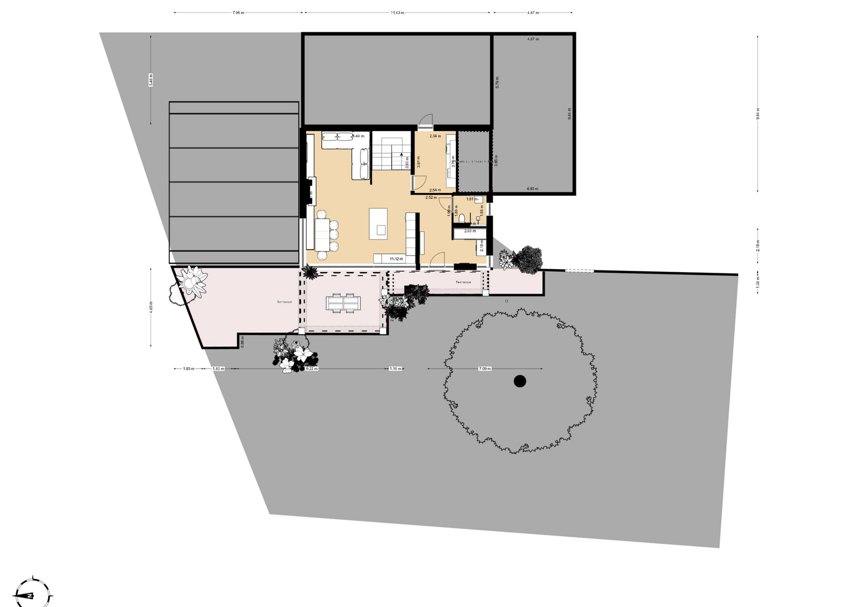

Slope – no However, I do see sloping terrain on the left side, for example. Also, the surrounding halls are still not clearly visible.
And then
hausmma schrieb:
Where is the main house and the grandmother’s garden located? Josy1990 schrieb:
The garden and the house are where the number 351 is shown … Well, there are halls marked there.
What about boundary line construction restrictions for the new house? Even if plot 352 also belongs to you, a corresponding building easement will probably have to be registered for the new construction.
@Josy1990 It is difficult to visualize a project when, as an outsider, you don’t have enough details to form a clear picture. A typical single-family house on a flat plot within a residential area wouldn’t necessarily require photos, but renovating an existing building without images—and with new information being added continuously—inevitably leads to confusion. The architect was sensibly on site, while the forum members are all participating from home.
From what I see, you’ve posted this thread before. With only this one photo, I can’t make sense of the situation at all, even though I live in the middle of a wine-growing region. People also asked if you could share some images illustrating your vision of what such a building, inspired by the winegrowing theme, might look like.
Without knowing the current reality in detail—and without fully understanding your possibly beautiful and unique wishes—it’s nearly impossible to offer you a serious opinion or constructive criticism on a plan by an architect that you consider very good.
I keep reading this and wonder what specific concern or even fear is behind the reluctance to clearly present details here, especially when you want to get feedback from these people.
