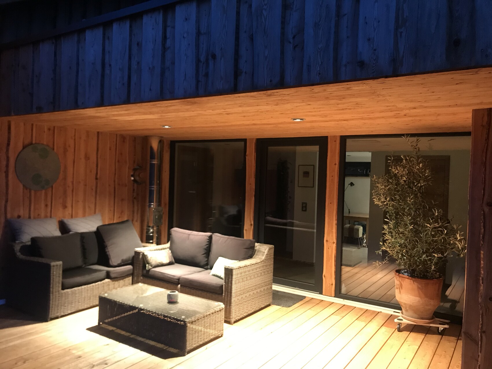

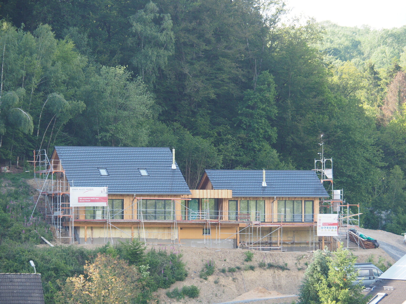

hampshire3 Nov 2019 19:05We have both types in our house. The one for the boys’ two wood stoves is made of stainless steel, located inside, and lined internally, while the one for our masonry heater is stainless steel on the outside. Fresh air intake from outside can also be done with stainless steel; it doesn’t have to be built with masonry.
In the end, it’s a matter of style.
The external one is on the covered terrace (top photo) and runs through the flat roof of the middle section of the building, then through the roof overhang. From a distance, it doesn’t even look like an external chimney (older photo with scaffolding – the one on the left is external).
