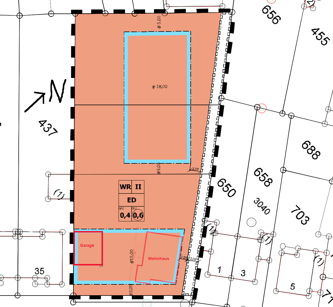

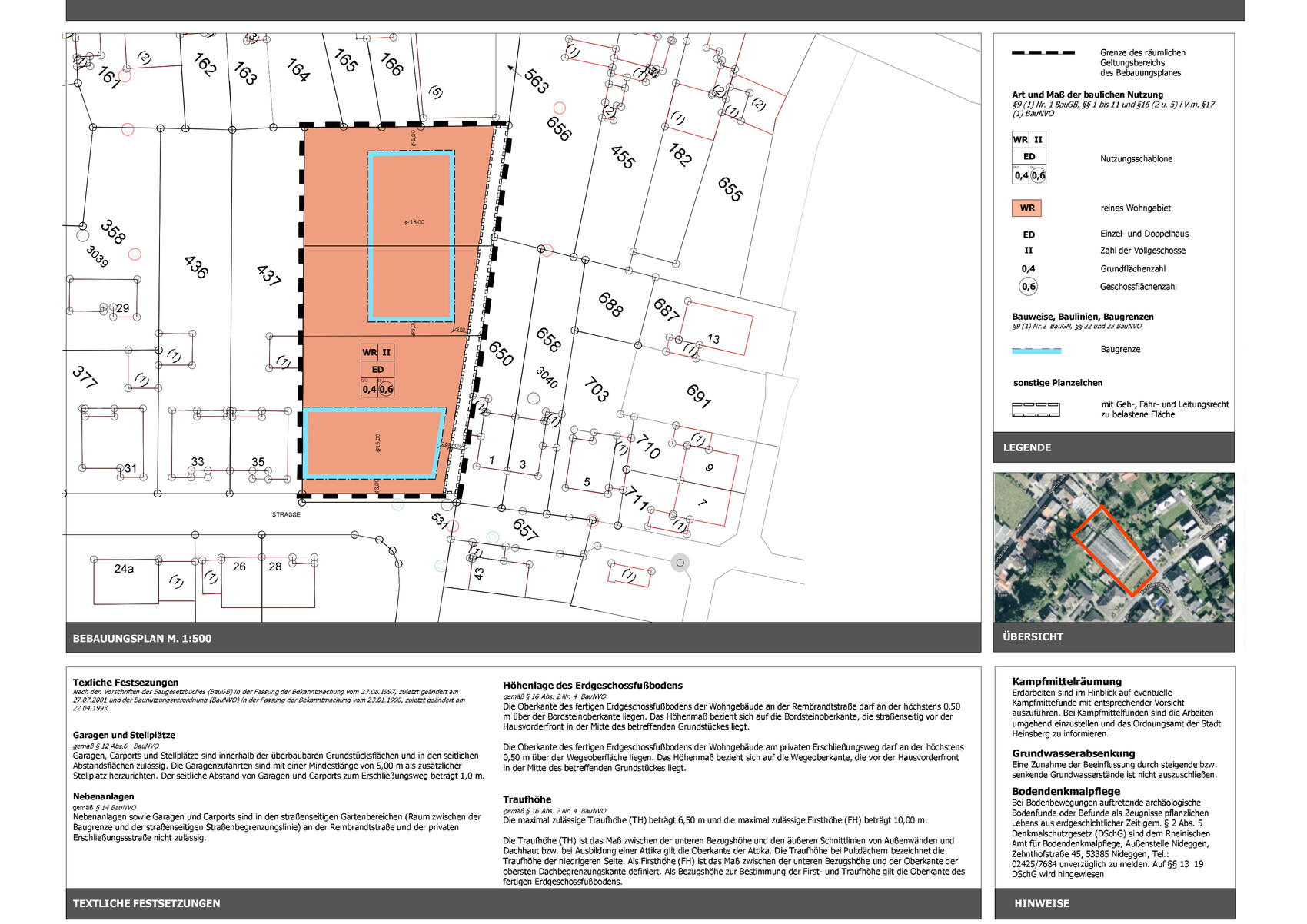

Development plan/restrictions
Plot size including hinterland/former agricultural land (already cleared greenhouses) total 2800 sqm (30,139 sq ft)
Slope: the front 32m (105 ft) wide plot slopes down 1.60 m (5 ft) from left to right. The land also slopes slightly towards the back, within the 15 m (49 ft) deep building area the terrain drops about 60-80 cm (2-2.6 ft). The plot is the lowest in the street.
Site coverage ratio 0.4
Floor area ratio 0.8
Building area, building line, and boundary: shown in the processed development plan excerpt, approximate planned building outlines marked in red. The entire orange area including the white-marked "path" on the right edge of the lot belongs to us. Below this path is a public wastewater pipe that must not be built over. We need to keep 2 meters (6.5 ft) distance from this path when building the house or 1 meter (3.3 ft) if a garage is placed there. Therefore, attaching the garage on the right side makes little sense. The house would then shift much further to the left and our terrace would be more often in the shadow of the left (southwest) neighboring building. The development plan for the hinterland buildings was approved at our request (for potential future use, e.g., a bungalow for children or elderly). As long as we don’t build in the back, we can use the path area ourselves; it is currently planned as a parking space for cars if we want to park close to the house or for guests.

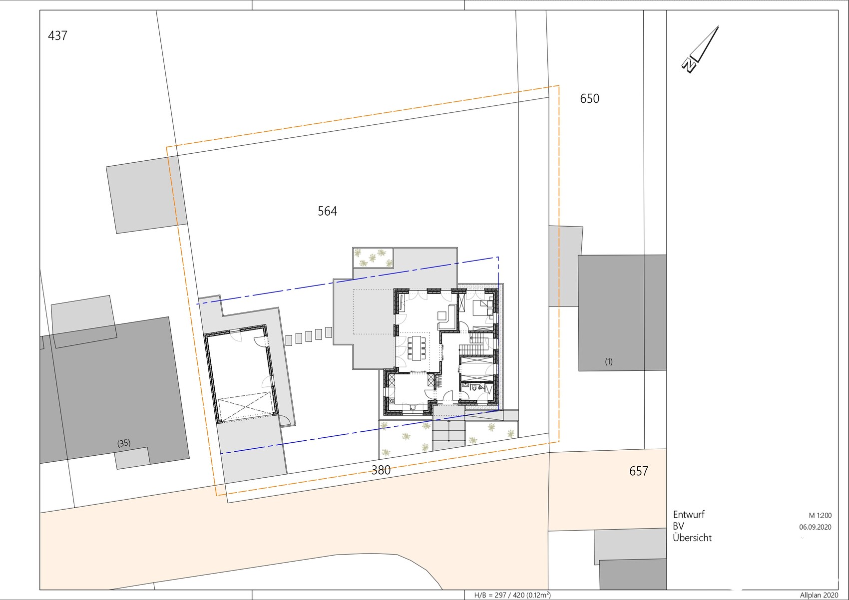

Why our own floor plan rather than a complete architect design? Apparently easier for the architect and she probably knows I can be stubborn.
We positioned the house “angled” in the building area so it runs parallel to the right boundary. This way we get a better view from the southwest terrace into the northwest garden and less visibility from the street and opposite neighbor houses. Another reason is to build as far away as possible from our higher left neighbor (whose shadow from low winter sun can be long) to get more sunlight in our windows and on the terrace. For brightness reasons, I also planned the garage separately from the house on the left southwest edge; it should be built as low and flat as possible, so it doesn’t cause significantly more shadow in winter than the neighbor’s buildings already do.
By the way, the open airspace above is a long-standing wish we don't want to give up completely, even if this means needing well soundproofed doors to the children’s rooms, for example.

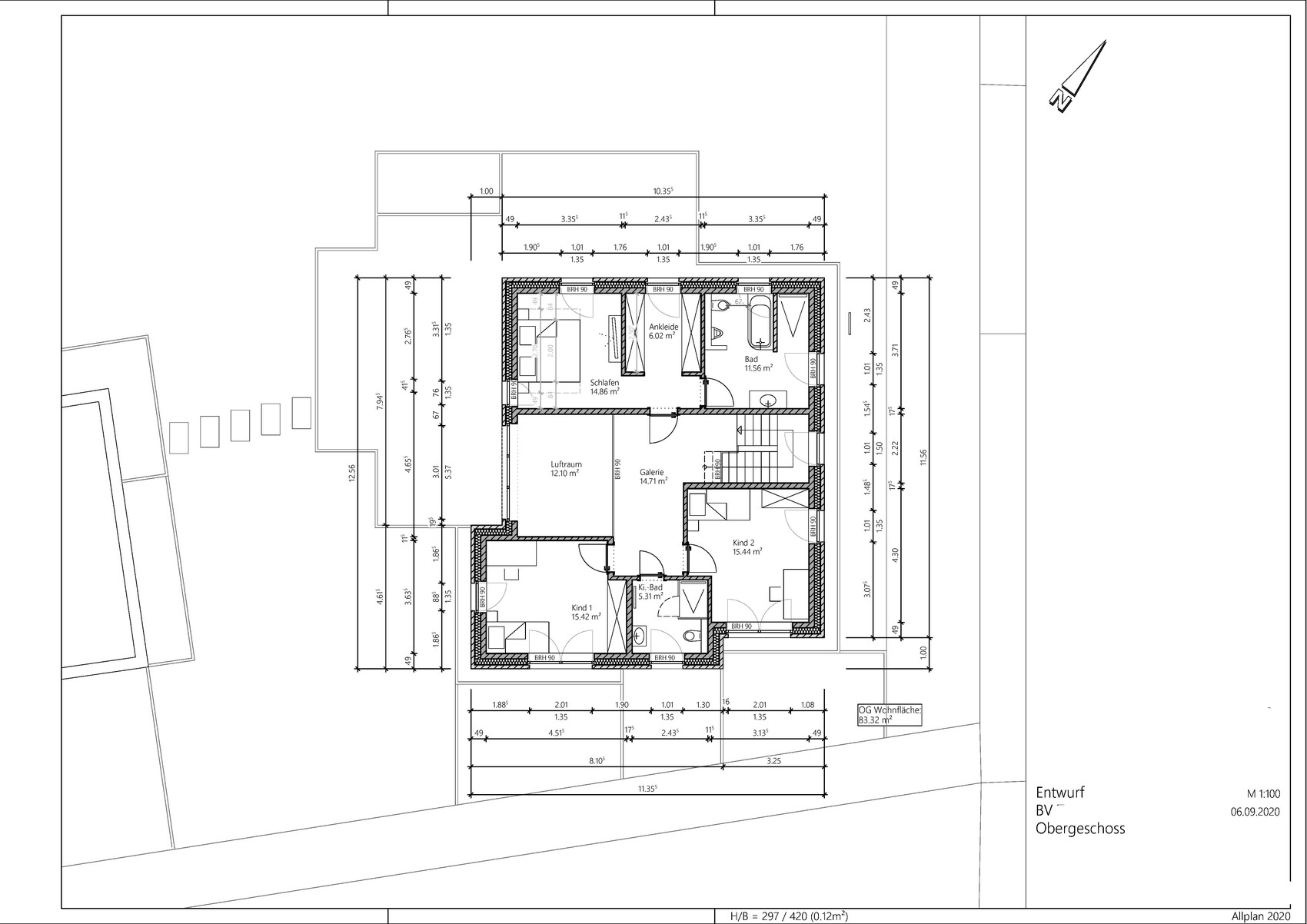

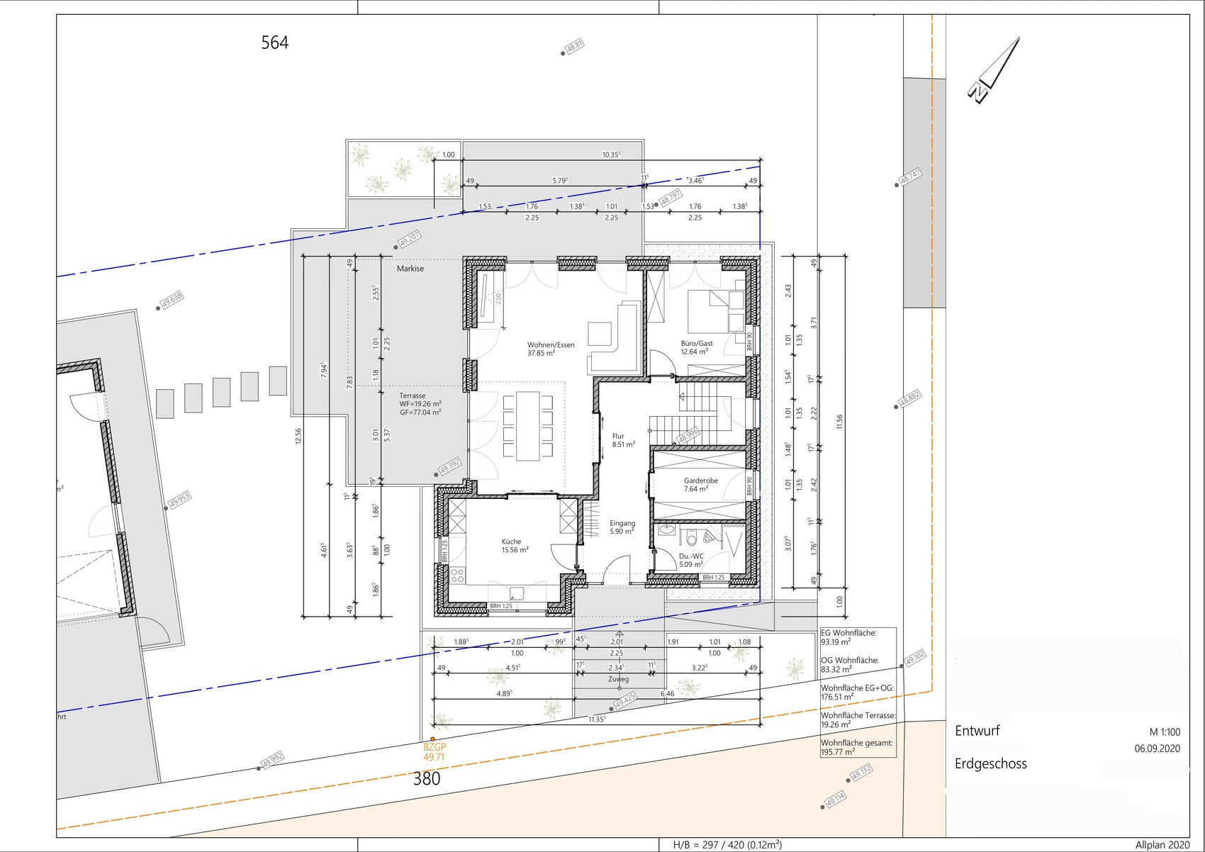

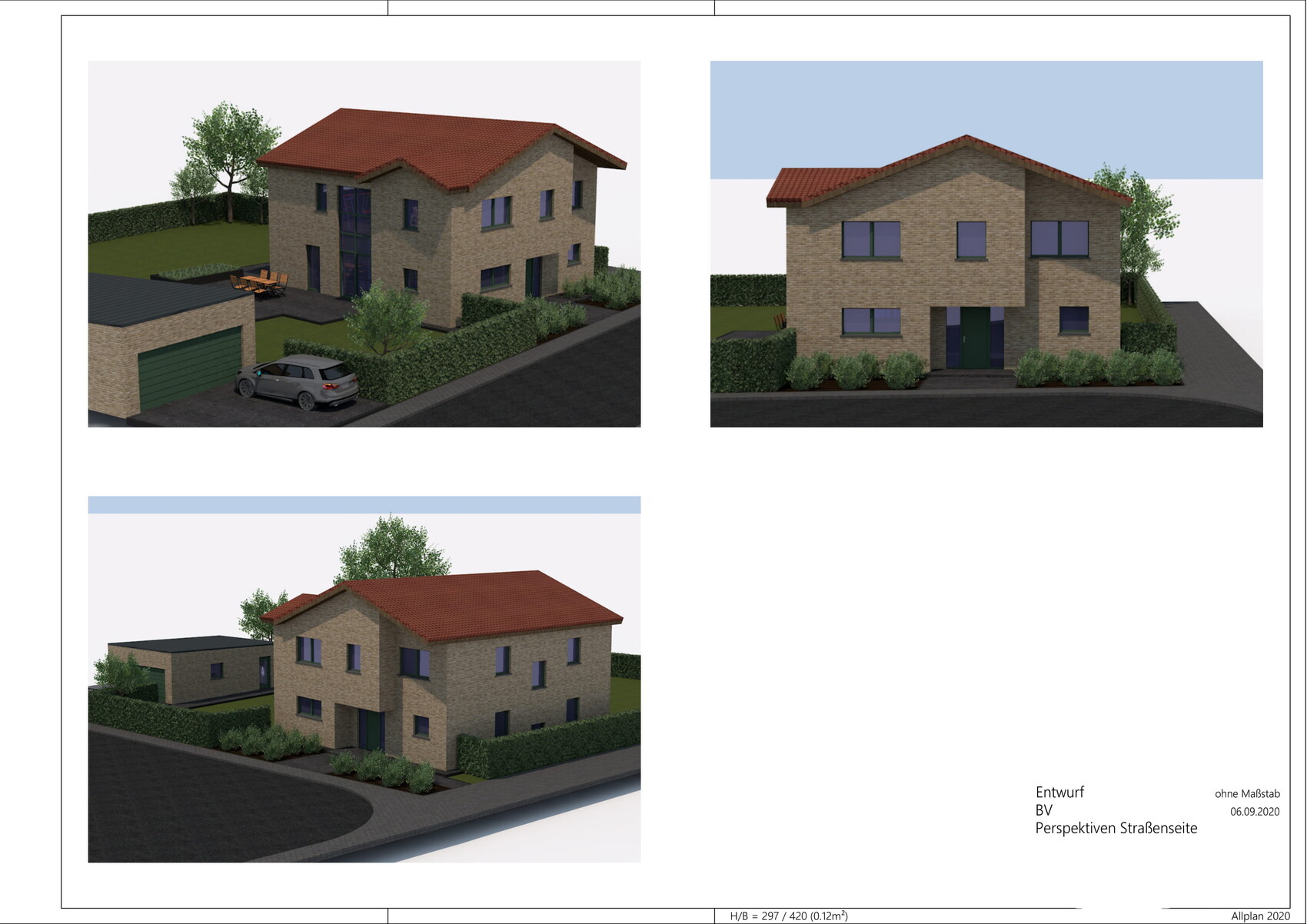

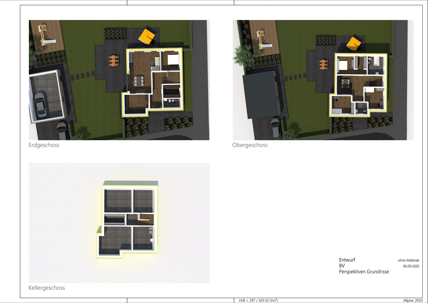

Now to my questions:
- The corner urinal in the guest WC was drawn rather space-consuming; there might be more compact constructions available. Still, the area is somewhat tight. Does anyone have better suggestions for the layout including the urinal?
- For the children’s bedrooms, I am considering giving the side windows double width for better daylight. With the visible roof beams, these will be large rooms, so a bit more window area might be good?
- In the parents' dressing room, the wardrobes are separated by solid walls even in the passage area. Should I remove these walls for more freedom of movement and flexibility? Then you’d see the wardrobe side walls when entering, but as long as no custom-made wardrobes are installed, this would give more options for furnishing?
- We plan to place a family bed 270 cm (106 inches) wide in the master bedroom in the early years. According to the plan, only 49 cm (19 inches) of space remains on each side. Does anyone have ideas on how this could be improved? Should we reduce some space from the open airspace? Or have a larger bedroom that extends beyond the ground floor walls?
- Is the kitchen layout practical? To have plenty of workspace and storage, we mainly want to install base cabinets and wall cabinets.
- Are there other visible errors or suggestions for improvements?
Thanks in advance for all your feedback!

Your questions have not been answered yet:
The children’s rooms should already have enough window area... increasing it would negatively affect the appearance.
Leave it as is. The sofa will always fit well, and the window will never be in the way.
Leave them out.
How long do you typically have such a family bed? I hope the bed will become narrower again once the kids reach school age. So, this is only a temporary solution that you will probably manage given your age.
It is not furnished—the kitchen layout only shows preliminary architect placeholders.
Where? Have you already registered in the kitchen forum? Have you visited a kitchen planner yet?
ltenzer schrieb:
In the children’s bedrooms, I am considering giving the side windows double the width for better natural light. Because of the exposed roof truss, these rooms have large volumes, so a bit more window area might be beneficial?
ltenzer schrieb:
I would prefer the living room window above the couch to be slightly further to the left, so the couch can be moved more flexibly. Also, I think it would look better if the wall width to the right of the window roughly matches the depth of the sofa, creating a somewhat private seating area.
ltenzer schrieb:
Should I rather leave these out to allow more movement space and flexibility?
Leave them out.
ltenzer schrieb:
According to the plan, there would only be 49 cm (19 inches) of space on each side.
ltenzer schrieb:
Is the kitchen furnished reasonably?
ltenzer schrieb:
Wall cabinets
ltenzer schrieb:
Personal budget limit for the house, including fittings: 500,000-600,000 € including additional costsIf the original poster is still following this thread: I believe this is significantly too low to realize the design shown here. Starting from 700,000 € seems feasible with modest expectations.
