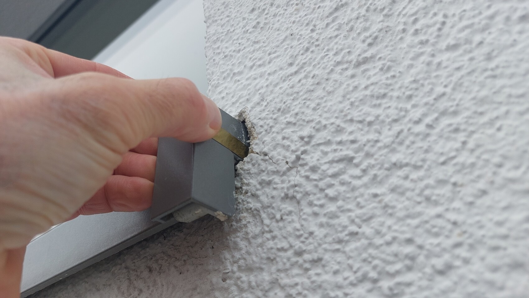

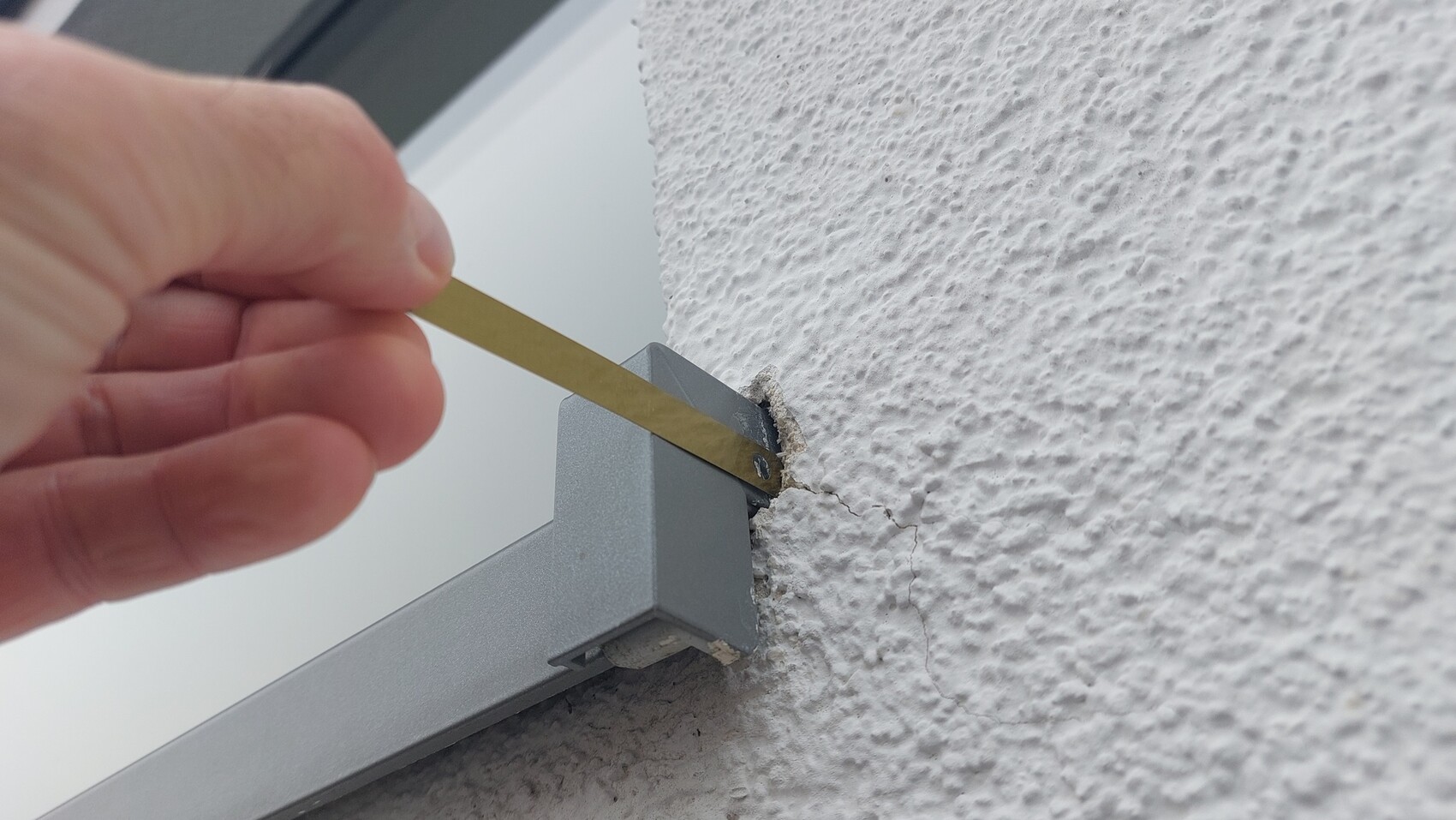

The first point concerns the plastering of the exterior window sills.
After some plaster chipped off at the end of a window sill, I noticed that a thin metal spring strip can be inserted quite far in that spot, see photos.
This seems to contradict what I believe I once read.
Isn't it the case that before plastering, a compression tape (Kompriband) must be applied over the end of the window sill, running above and down the sides?
before the warranty period ends, I would like to clarify a few points.

nordanney23 Dec 2024 15:46alive&kicking schrieb:
Isn't it the case that before plastering, a compressible sealing tape must be applied above and down the sides over the end part of the window sill?Yes, that is the usual practice. Do you have any photos from the construction phase?
