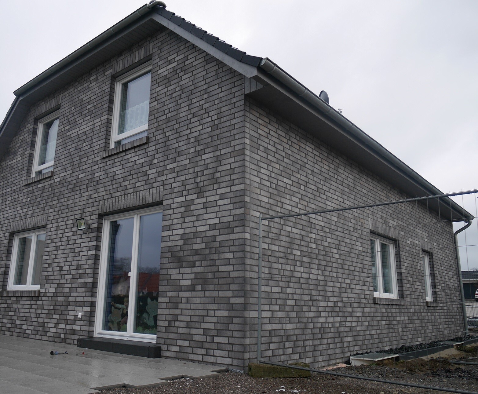

We have four. You can see two here (actually only one, as the downspout is a good hiding place) (in low resolution for uploading here in the forum).
Grey brick house with gable roof, multiple windows, and glass sliding door on the ground floor.
Kaspatoo14 Nov 2016 14:30
Well, with the brick color, that is actually less noticeable, but I have seen quite a few other variations.
