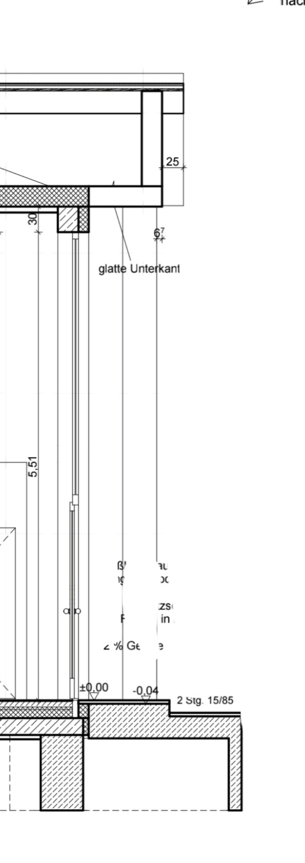

Yes... it is exaggerated.
Cross-section of a window frame with dimensions and smooth lower edge.
I'll send the cross-section.

It is concreted...
