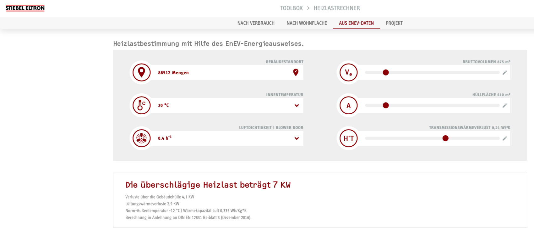

I have received my calculations for my house, and they seem quite high?!
Building volume Ve = 875
Envelope area = 610
Usable floor area An = 280
My living area is about 230 m² (including balcony, terrace, etc.) (balcony + terrace are about 20 m² (215 sq ft))
The problem is that all the calculators I have used come up with a heating load of around 7. That sounds very high to me for a KfW40+ standard. What do you think?
The actual heated living area is only about 170 m² (1,830 sq ft). Everything else consists of utility rooms in the basement, balcony, etc.

You won’t get to a 7kW heating load that way. Then fill in the other data completely.
How many people? I assume a mechanical ventilation system with heat recovery? What standard outdoor temperature?
Edit: desired average (!) temperature. So for the entire house.

EnEV heating load calculator: Location 88512 Mengen, indoor 20°C (68°F), airtightness 0.4 h⁻¹.
I have attached the calculation here. It is based on DIN EN 12833.
face2627 May 2020 10:42
I’m not familiar with the exact numerical value for the ventilation. But maybe that’s where the problem lies?
With controlled residential ventilation and heat recovery, I come to just under 5 kW.
Edit: I just noticed in the fine print 2.9 kW from ventilation losses. In my view, that would mean you don’t have controlled residential ventilation?

Yes, I have. The value in the calculator is influenced only by the blower door test result.
face2627 May 2020 12:32
Try again. I just ran the calculation with your data. It comes out to 5.9 kW. Even that is still too high, if you ask me (but I think it’s due to the calculator).
