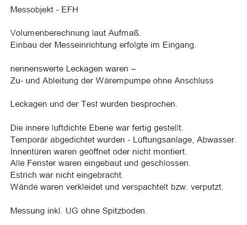

RotorMotor8 Mar 2022 07:59You will still receive a report.
It will specify what is leaking.
Was the construction already fully completed?
I believe we had 1.3, but our window sills were not installed yet. You could really feel the drafts because of that. Also, our attic was not fully finished at that time. So if your construction is not completely finished yet, I wouldn’t worry at all, and otherwise, you can check the final report.

Was the construction already completely finished? Here are the comments, which I have just received by email:
