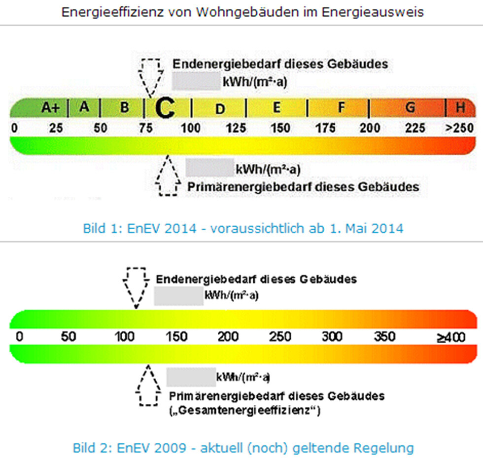

As far as I know, the classification of final energy demand according to energy efficiency classes has only existed since the Energy Saving Ordinance 2014 – see graphic...
Two colored EnEV energy efficiency diagrams for buildings with a color spectrum from green to red
Xinette25 Nov 2014 09:12
Then the house would even be rated E according to the new energy saving regulation and would no longer have new building status, correct??? Or am I misunderstanding this???
Thanks and best regards Xinette
Cascada25 Nov 2014 09:28
Well, I’m not an expert on energy saving regulations, but I believe the 2009 energy saving regulations still apply to existing buildings. You can see where "your" house is located on the chart...
