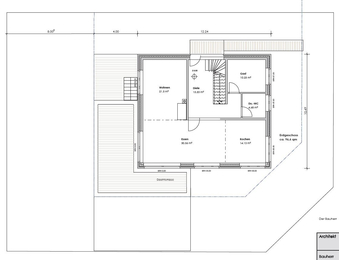

In my case, does the garage integrated into the basement need to be included? Also, would the attached floor plan meet the definition of a basement storey?

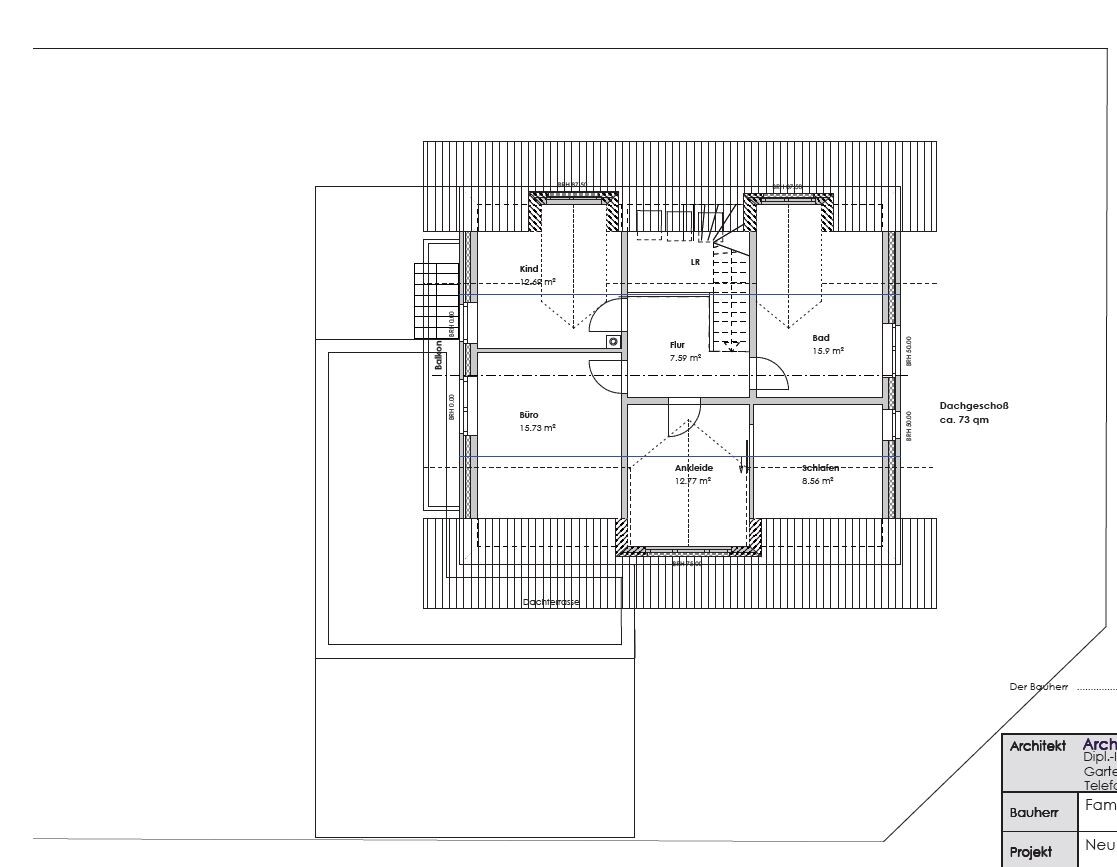

Where is the objection to the plan coming from? The visualization gives me the impression that the 1.40m (4.6 ft) limit is not exceeded. Have you done exact calculations? The same goes for the attic floor: roof pitch less than 45° and no knee wall—are the two-thirds limits exceeded? Even if they are, it can’t be much over. Show us the proof of full-story calculation. A planner should be able to easily turn the house into a single-story design, especially since you only need normal windows on the garage side. What would be a plausible reason for different ceiling heights?
I haven’t calculated the 1.40m (4.6 ft) exceedance precisely, but I have the same impression as you. The terrain on the plot drops about 4 m (13 ft) over 22 m (72 ft).
According to the current floor plans from the architect, the attic floor has 73 m² (785 sq ft), while the ground floor is 96.6 m² (1,040 sq ft). I believe the knee wall height is 55 cm (22 inches) (can you determine this from the attached floor plan?).
Therefore, the two-thirds rule would be reached at 64.34 m² (692 sq ft). It might actually be worth considering boxing in the attic floor so that it stays at a maximum of 64.34 m² (692 sq ft) (since a 55 cm (22 inch) knee wall at a 35° roof pitch is indeed quite small), and then making the basement a full story. That way, you wouldn’t need to worry about the definition of basement and the associated restrictions.

The ground floor, however, is 96.6 m² (1040 sq ft). We are talking gross floor areas here. Your ground floor has a footprint of 128.4 m² (1382 sq ft). The attic area with more than 2.20 m (7 ft 3 in) clear height may therefore be 85.6 m² (921 sq ft). So you need the 2.20 m (7 ft 3 in) height line in the attic floor plan. In CAD it’s easy, with hand-drawn plans it’s painful. Your planner should manage this without major issues, perhaps with some compromises regarding the dressing room or dormers.

That a few adjustments If those are even necessary. Who says the basement and attic are full stories? Where is the proof? Otherwise, you understand me correctly.
