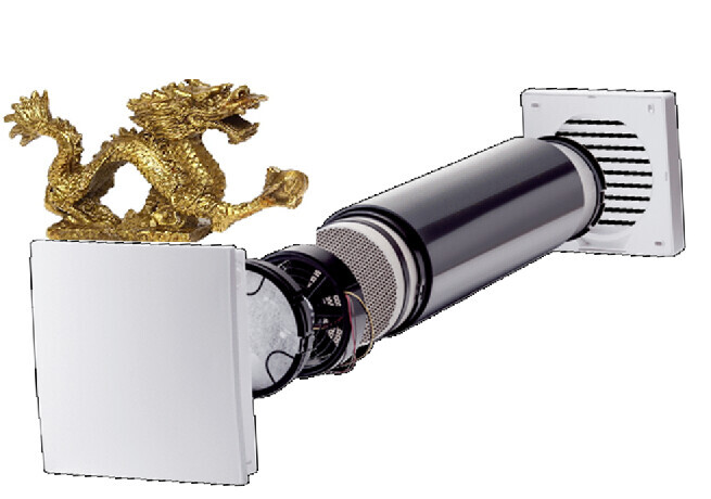

hampshire schrieb:
When I think of the gargoyles on late medieval manor houses that spout water from the roof, I immediately get an idea: Each downspout could have its own custom-made gargoyle head made of tinplate, copper, or ceramic. Maybe it even breathes steam in cold weather.That could really be something...But definitely add the stone front garden in Asian style... 😉
I am also considering a decentralized system. A central ventilation system is definitely not an option for us either. What do you think about the corner zero units? Their Xenon fans are definitely high-tech, but could serious issues arise with insulation and plastering if they are installed in the window reveal?
