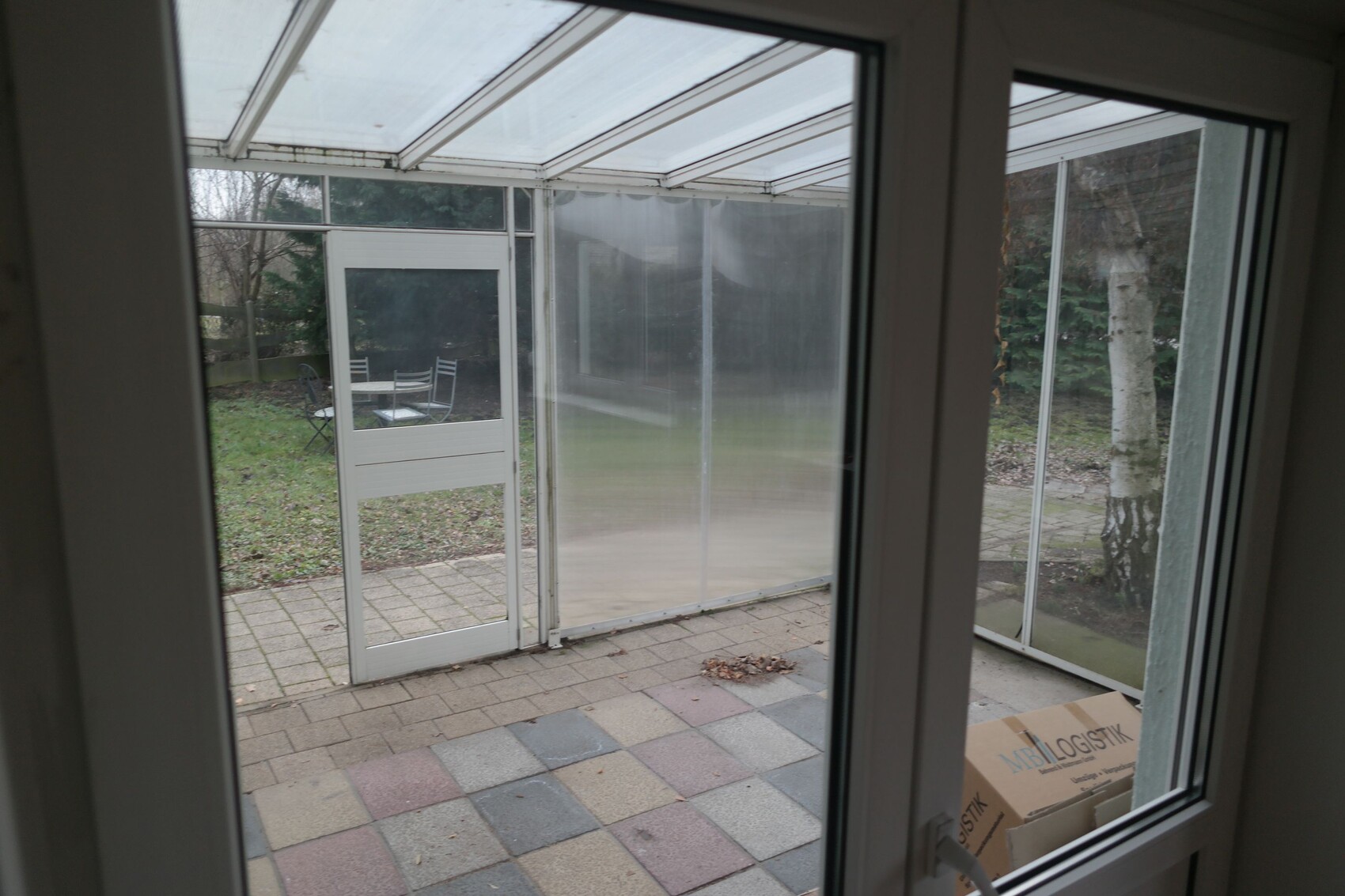

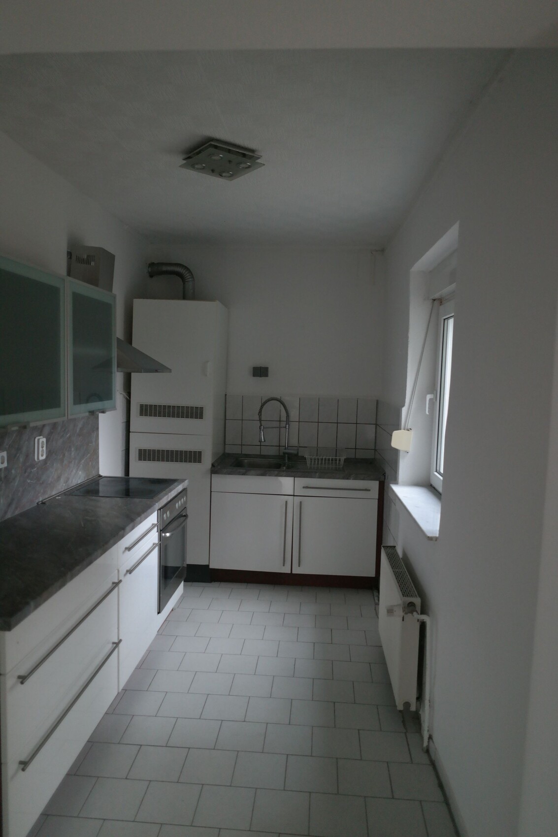

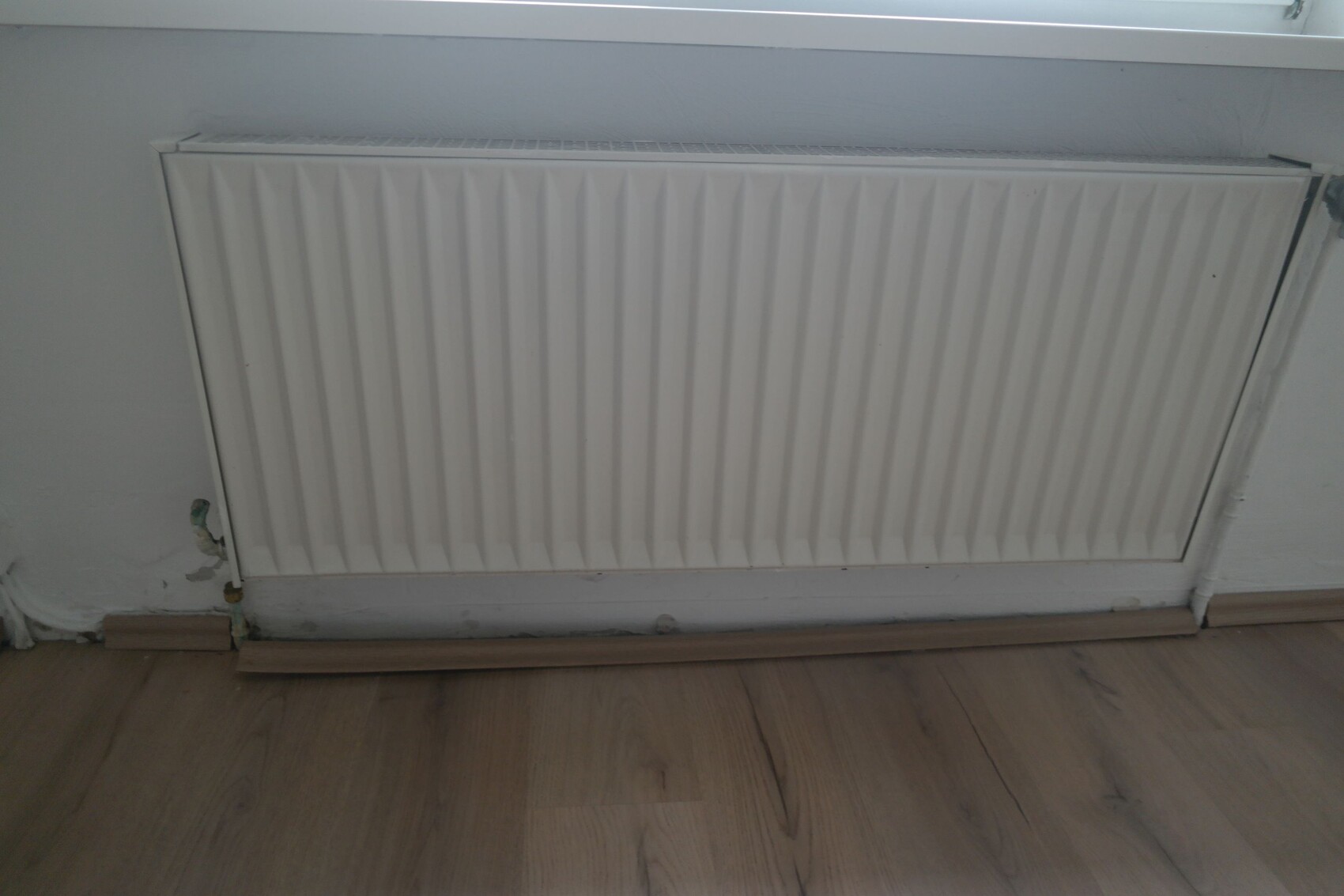

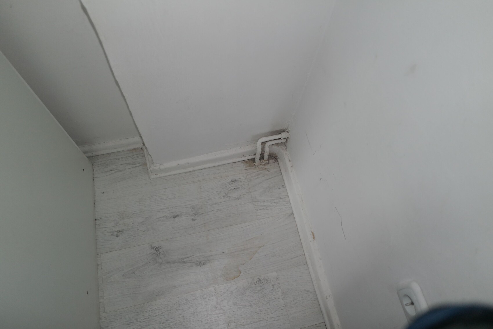

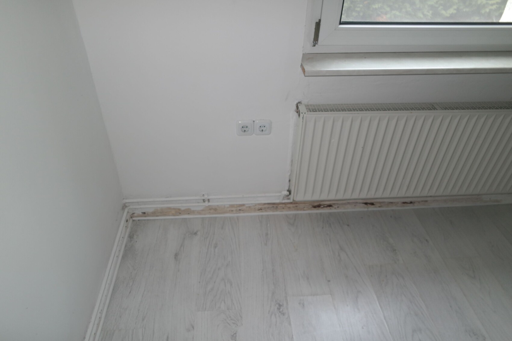

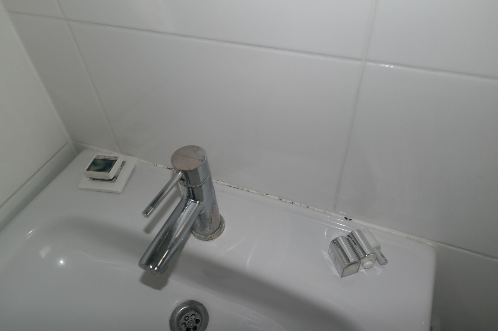

Dear all,
We have now visited property 1, and indeed, there is more to do than could be seen from the initial photos.
The condition can generally be described as well lived-in, but in my amateur assessment, most issues are superficial and could largely be handled by oneself. The electrical and water lines seem to be in reasonably good condition and appear to be copper (although, of course, I don't know their condition inside the walls). The walls all need painting or wallpapering, and the floors probably require replacement as well.

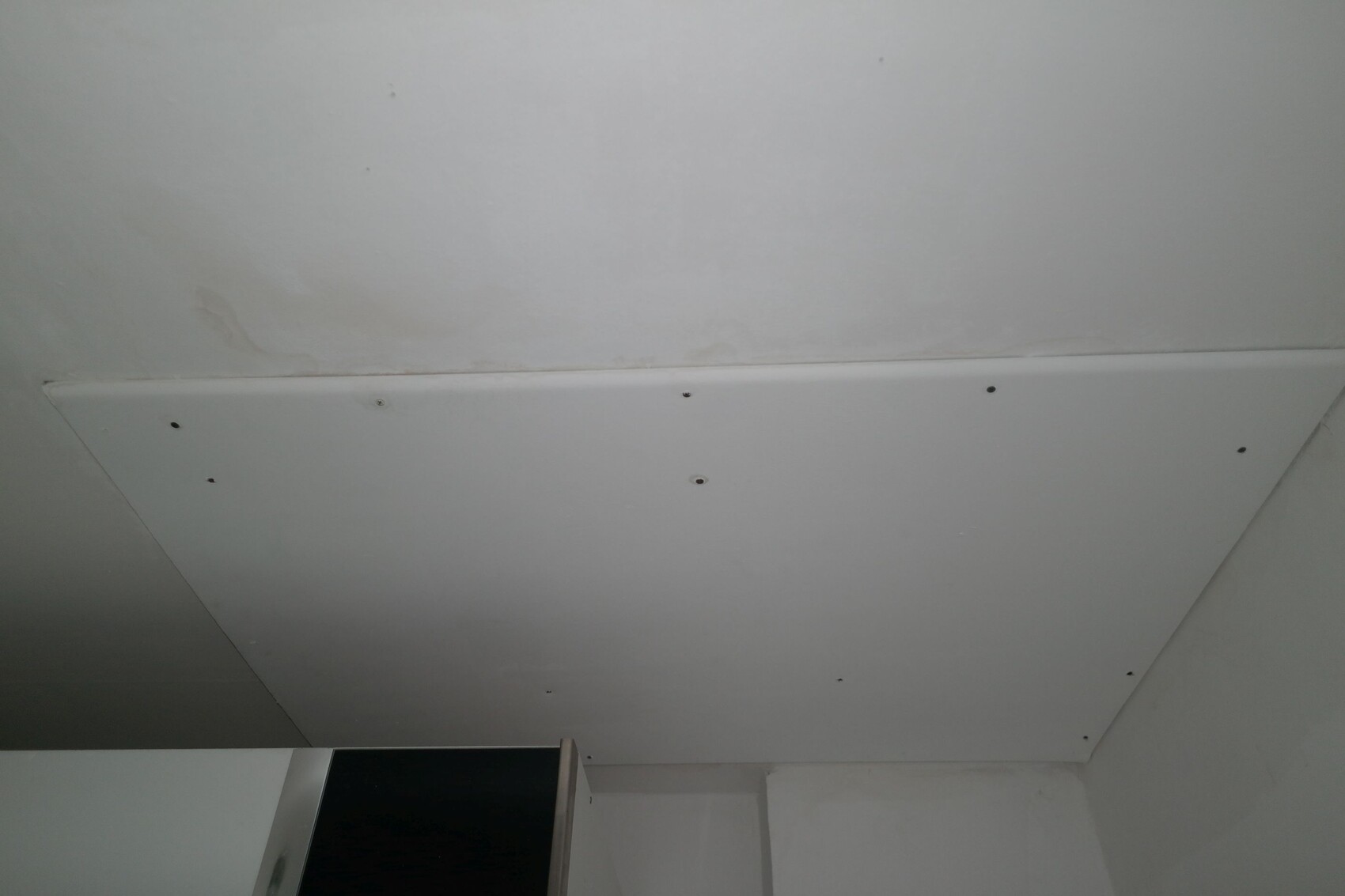

One of the rooms apparently had a water damage issue, where the suspended ceiling was only roughly repaired (drywall from below), and the baseboard is damaged. However, all those areas were dry. There was no musty smell anywhere, not even in the basement.
The biggest challenge, as expected, is the floor plan. Most rooms are very small. Due to the multiple bathrooms and kitchens, the living spaces feel very cramped. So many walls would need to be moved. I’m still awaiting feedback on which of the thick walls on the ground floor are load-bearing (the thin ones are drywall). I fear that for a practical layout, a substantial extension would actually be necessary, encompassing the current sunroom, hallway, and some additional space along the bottom and right sides of the floor plan. Moreover, an internal staircase would need to be installed.
How much might such work cost? Could 100k (100,000) be sufficient?

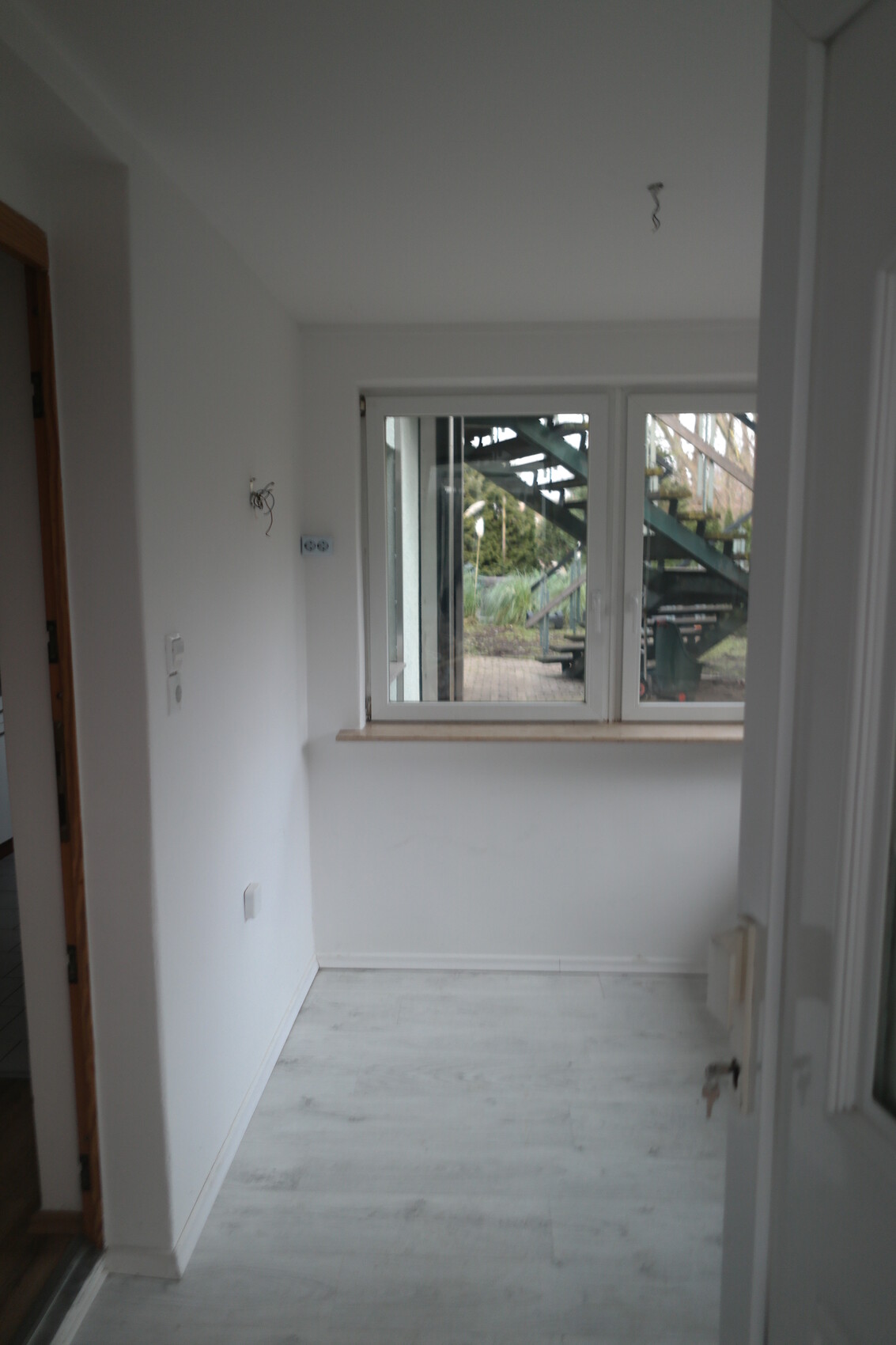

Attached are the current floor plans and some impressions.
