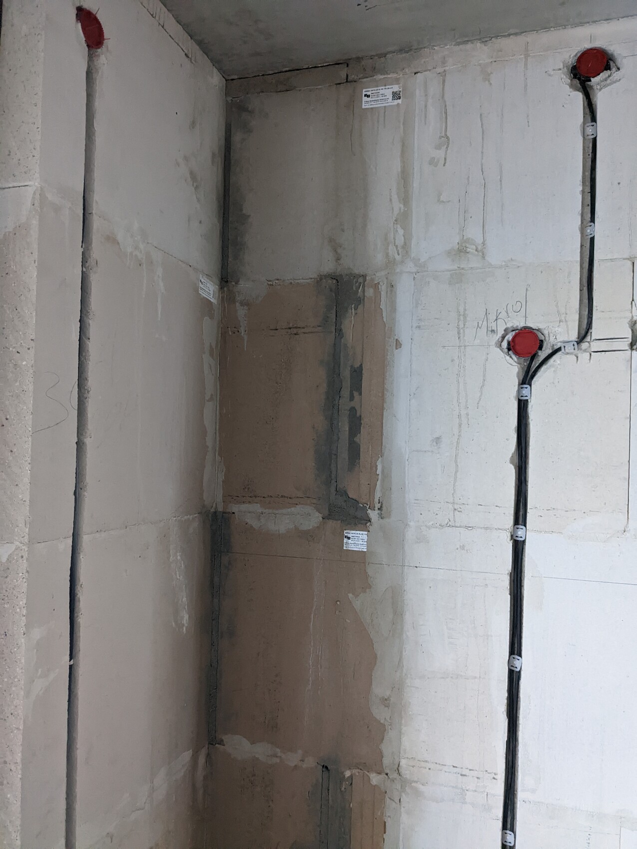

We are currently in the process of building or having an apartment built.
Yesterday, we noticed that the walls are wet and there is also a large puddle on the floor. The water is coming from a joint in the wall.
Is this normal? There is no screed yet, the windows are already installed, and the exterior already has the base coat plaster.
Thank you and best regards
Rohbauzimmer mit sichtbaren Leitungen, Kabeln und roten Anschlüssen; links eine Glas-Tür.
Unfertige Betonwand-Ecke mit Kabelkanälen, roten Abdeckkappen und Putzflächen.
i_b_n_a_n17 Oct 2022 19:20
Please mark the spot where the water leakage occurs (inside) and also take and upload a photo of the corresponding spot on the outside. If possible, also provide an overall exterior photo of the building so that the potential point of water entry can be estimated.

Roof on, or a balcony above?
Wohnung4
17 Oct 2022 20:12
Offtopic schrieb:
Roof on top, or a balcony above?
There is still a floor with an apartment above.
WilderSueden
17 Oct 2022 22:44
If the bricklayers skimp on the mortar, there can sometimes be continuous gaps that let air through, and you can see damp spots on the inside. In your case, it’s more than just a little dampness; there must be water collecting somewhere above and then leaking in.
Benutzer 1001
18 Oct 2022 09:24
Wohnung4 schrieb:
There is another floor with an apartment above.
And above that? There’s a reason why the top row must always be covered when building with hollow brick blocks. I hope these are not solid bricks.
I would inform the site manager and, depending on his response, formally report the defect in writing.
