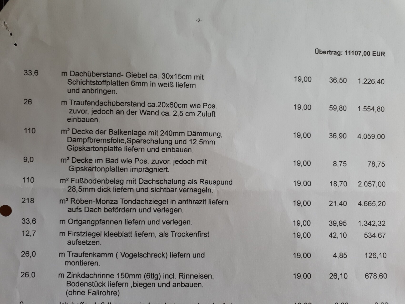

Price and item list for construction lumber, roof components, and installation services on paper.
Construction price sheet with items for roof overhang, insulation, ceilings, floor coverings, and tiles.
I now have quotes for the mentioned work. This one is the cheapest — do you think the price is reasonable, or should I get more offers?
The upper floor is only partially developed; would you still recommend insulating the roof now, or wait until the upper floor is fully finished later? So far, the plan is without insulation, but I am considering whether it might make sense to use any leftover budget as roof insulation instead of extra loan repayment.
The final price is €32,641.52.
PS: The specified steel beam is required according to structural calculations — so the offer still needs to be updated accordingly.

Is that the net or gross price?
The roof needs to be insulated anyway, or has the insulation already been done on the top-floor ceiling?

The gross floor slab is insulated with 24 cm (9.5 inches) thickness, which is included in the offer. This should be sufficient for now.
niri09
9 Jul 2018 13:03
The question is also whether it makes sense to skip insulating the ceiling of the upper floor and instead insulate the entire upper floor. Just discuss this with the roofer and/or architect. The offer itself seems reasonable.

Hmm, then I would partly be heating the initially unused upper floor as well. I don’t really see much point in that. But I’m open to being convinced otherwise.

I can’t directly apply this to a gable roof because we have a hip roof with insulation between the rafters and no insulation on the top floor ceiling (the ceiling is concrete). According to our architect, it’s generally better to insulate the roof itself, but there are probably many different opinions on what’s best.
I’m not an expert when it comes to insulation, so I would recommend consulting your architect—they will definitely know what’s best. By the way, our insulation between rafters cost about 4500, but for a smaller area.
In my opinion, it doesn’t make much sense to spend money twice on insulation if you plan to finish the attic anyway.
