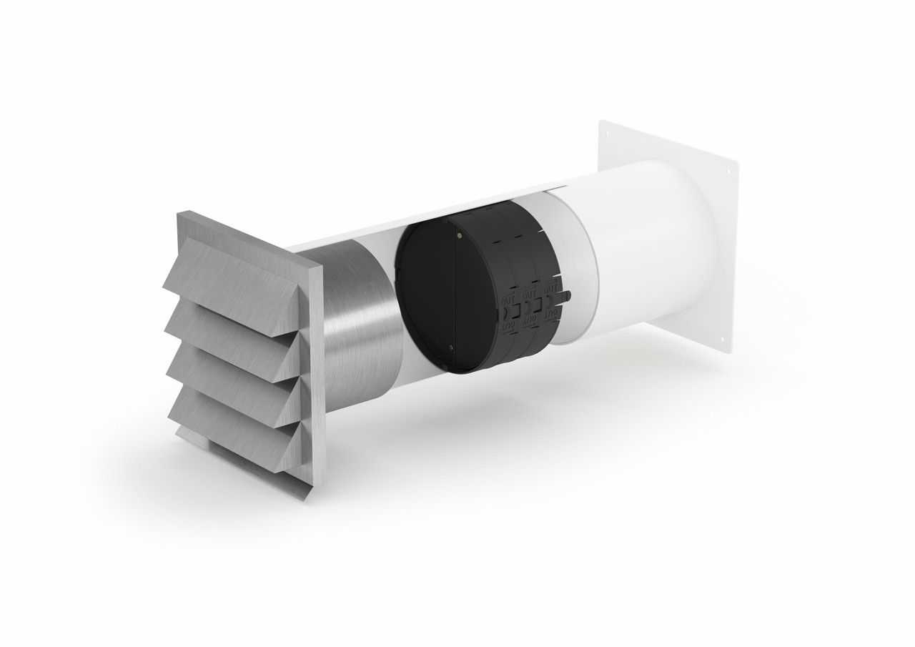

nordanney20 Mar 2026 23:04If the manufacturer does not require a different diameter for any flexible reasons, that is naturally acceptable.
Ideally, a fresh air wall vent should be installed. Therefore, this planning should be handled by the kitchen specialist.
Otherwise, open the window, and it must not be forgotten that even with recirculation, the moist air ultimately needs to be vented outside, since ventilation systems usually do not achieve the necessary air exchange.
