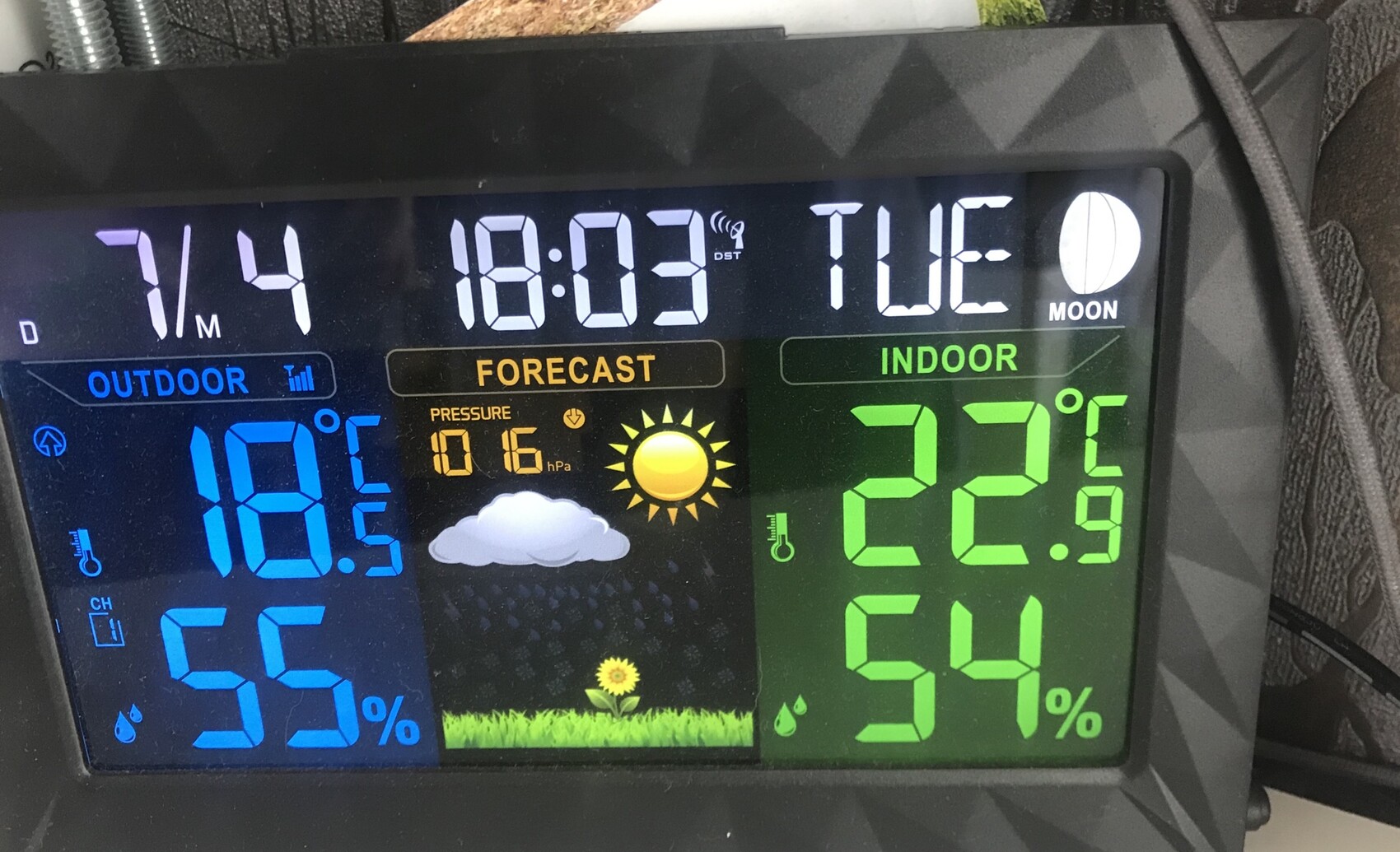

What are your CO2 levels? And how do you measure the humidity?
At 50-55%, it’s likely that you are ventilating very sparingly, which could also explain using such a small device, or the house is very small but has many people living in it.
Based on calculations, such values are actually not possible with current outdoor humidity levels.
Vitalio schrieb:
House volume 670m3 (24,000 ft3), 2 full stories
Air exchange rate 0.4 Well, that is hardly achievable with the device. CO2 levels are actually the important factor for setting the ventilation.
The air exchange rate is probably more like 0.2 to 0.3. You would need to produce about 8 liters (0.28 cubic feet) of water vapor per day inside the house, which is somewhat realistic.

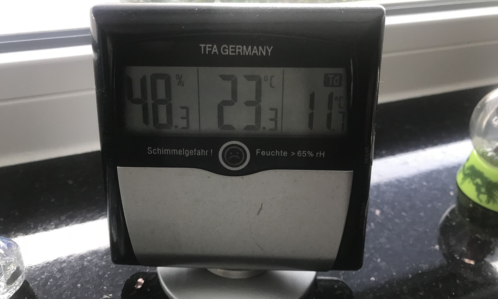

Vitalio schrieb:
2 hydrometers showing almost the same readingsSmartass mode ON
You probably mean hygrometers. A hydrometer actually measures the specific gravity or density of liquids.
