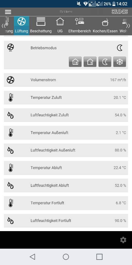

Is your exhaust air sensor broken?

No, it works. But the status hadn’t been retrieved yet. One of the reasons why I’m going to get rid of the Jung Smart Visu...
App interface for ventilation control with air flow, temperatures, and humidity

I have connected the KNX module to the ventilation unit and the bus. The display is managed via the KNX visualization from Jung, and the operation as well. However, it will soon be replaced by the Gira X1.
